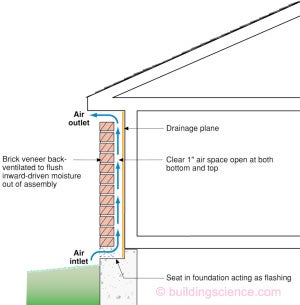

Cladding Ventilation
For claddings with significant reservoir capacity, including masonry and fiber-cement, ventilation is recommended to enhance moisture control. Ventilation, or exterior airflow behind the cladding driven by wind pressure differences on the face of the building or solar heated air rising, is useful since it accelerates drying by removing moisture from the drainage space. Ventilation bypasses the high vapor resistance of claddings such as vinyl siding, metal panels, and cement board, thereby allowing outward drying of the wall assembly.
A clear space is required behind cladding to encourage ventilation. While effective drainage of rainwater can occur in drainage spaces as small as 1/16 to 1/8 inch (e.g. between two layers of building paper in a stucco cladding), effective ventilation may require spaces as large as 3/4 to 1 inch depending on the moisture load (e.g. between a brick veneer and a building wrap). The greater the reservoir, the greater the moisture load, and the greater the ventilation required. Keeping the ventilation space clear may be challenging with masonry claddings such as brick veneers. It may be worthwhile to specify a wider ventilation cavity if quality control measures are not sufficient to keep mortar droppings from closing or constricting the ventilation space.

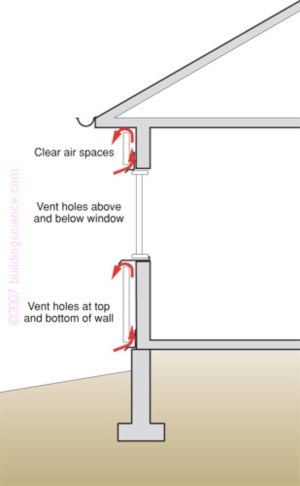

Effective ventilation also requires placement of clear vents at both the top and bottom of the wall. This will maximize the stack potential and hence the motive force to promote ventilation. Vent holes are also needed at horizontal interruptions of the wall such as window sills and heads.

- Absorptive claddings such as brick veneers, when used over a vapor permeable combination of exterior sheathing and weather-resistive barrier should have a ventilated cavity and high inward drying potential (i.e. no polyethylene vapor barriers).
- A ventilated cavity will both reduce inward driven moisture and increase drying to the exterior.

Figures 2A and 2B
Ventilated Cladding
- To effectively uncouple a reservoir cladding from a wall system by using back ventilation, a clear cavity must be provided along with both air inlets at the top and bottom of each wall section.

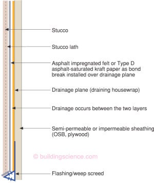

Figure 4
Stucco with Drainage Plane and Drainage Space
- Stucco applied over water sensitive materials must be uncoupled from the water sensitive materials. This can be accomplished via drainage and a capillary break.
- For drainage to occur, both a drainage plane and a drainage space are required. Therefore, the stucco must not bond continuously to the drainage plane, a bond break is necessary.
- The capillary break can be an airspace, foam sheathing or the drainage plane material itself
- Semi-permeable or impermeable sheathing provides control of inward vapor drive.
