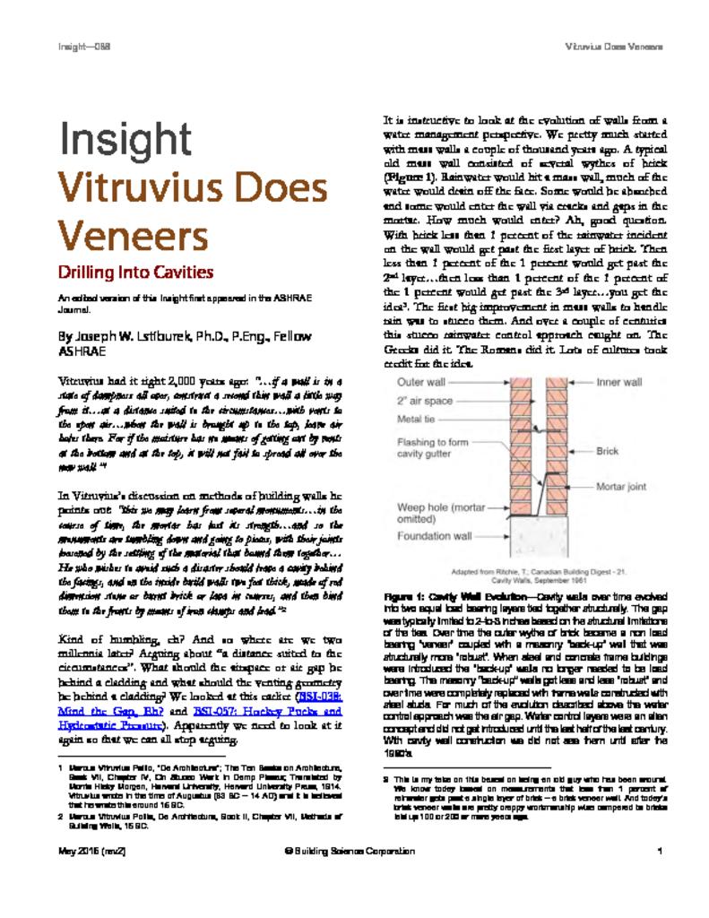

Vitruvius had it right 2,000 years ago: “…if a wall is in a state of dampness all over, construct a second thin wall a little way from it…at a distance suited to the circumstances…with vents to the open air…when the wall is brought up to the top, leave air holes there. For if the moisture has no means of getting out by vents at the bottom and at the top, it will not fail to spread all over the new wall.”1
In Vitruvius’s discussion on methods of building walls he points out: “this we may learn from several monuments…in the course of time, the mortar has lost its strength…and so the monuments are tumbling down and going to pieces, with their joints loosened by the settling of the material that bound them together… He who wishes to avoid such a disaster should leave a cavity behind the facings, and on the inside build walls two feet thick, made of red dimension stone or burnt brick or lava in courses, and then bind them to the fronts by means of iron clamps and lead.”2
Kind of humbling, eh? And so where are we two millennia later? Arguing about “a distance suited to the circumstances”. What should the airspace or air gap be behind a cladding and what should the venting geometry be behind a cladding? We looked at this earlier (BSI-038: Mind the Gap, Eh? and BSI-057: Hockey Pucks and Hydrostatic Pressure). Apparently we need to look at it again so that we can all stop arguing.
It is instructive to look at the evolution of walls from a water management perspective. We pretty much started with mass walls a couple of thousand years ago. A typical old mass wall consisted of several wythes of brick (Figure 1). Rainwater would hit a mass wall, much of the water would drain off the face. Some would be absorbed and some would enter the wall via cracks and gaps in the mortar. How much would enter? Ah, good question. With brick less than 1 percent of the rainwater incident on the wall would get past the first layer of brick. Then less than 1 percent of the 1 percent would get past the 2nd layer…then less than 1 percent of the 1 percent of the 1 percent would get past the 3rd layer…you get the idea3. The first big improvement in mass walls to handle rain was to stucco them. And over a couple of centuries this stucco rainwater control approach caught on. The Greeks did it. The Romans did it. Lots of cultures took credit for the idea.
Figure 1: Cavity Wall Evolution—Cavity walls over time evolved into two equal load bearing layers tied together structurally. The gap was typically limited to 2-to-3 inches based on the structural limitations of the ties. Over time the outer wythe of brick became a non load bearing “veneer” coupled with a masonry “back-up” wall that was structurally more “robust”. When steel and concrete frame buildings were introduced the “back-up” walls no longer needed to be load bearing. The masonry “back-up” walls got less and less “robust” and over time were completely replaced with frame walls constructed with steel studs. For much of the evolution described above the water control approach was the air gap. Water control layers were an alien concept and did not get introduced until the last half of the last century. With cavity wall construction we did not see them until after the 1960’s.
Then we got Vitruvius and the cavity wall4. This was revolutionary. An airspace or gap behind the first wythe to allow drainage of penetrating rainwater was a phenomenal concept (Figure 1). The airspace or gap also acted as a capillary break and allowed airflow to redistribute the penetrating absorbed water and subsequently vent it out of the assembly. Drainage, ventilation and a capillary break all in one. Amazing.
Cavity walls over time evolved into two equal load bearing layers tied together structurally. The gap was typically limited to 2-to-3 inches based on the structural limitations of the ties. Two wythes of brick tied together this way tended to be pretty limiting structurally and structural engineers are known to not like being limited. It did not take much time for things to change. The outer wythe of brick became a non-load bearing “veneer” coupled with a masonry “back-up” wall that was structurally more “robust” (Figure 1).
