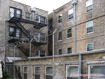

Photograph 1: Jumbo-Sized—Uninsulated masonry building

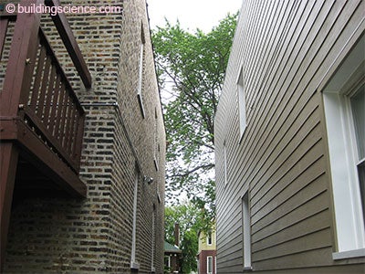

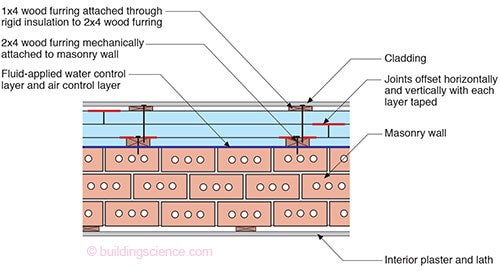

These buildings can come “jumbo” sized (Photograph 1) or “house” sized (Photograph 2). Regardless of size, they can be addressed the same way. Coat the exterior of the masonry with a fluid applied water control layer and air control layer. Install rather robust wood furring (2x4’s “on the flat”) directly to the masonry. Then insulate over the entire assembly with rigid insulation and install additional furring for cladding attachment. Finish the entire thing off with new cladding (Figure 1). Easy. We can retrofit an uninsulated masonry wall “with good bones” and—presto—get “a perfect wall” out of the deal.

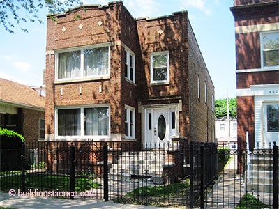

Photograph 2: House-sized—Uninsulated masonry building
Figure 1: Perfect Wall Retrofit— Coat the exterior of the masonry with a fluid applied water control layer and air control layer. Install rather robust wood furring (2x4’s “on the flat”) directly to the masonry. Then insulate over the entire assembly with rigid insulation and install additional furring for cladding attachment. Finish the entire thing off with new cladding.

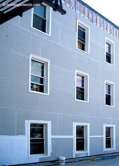

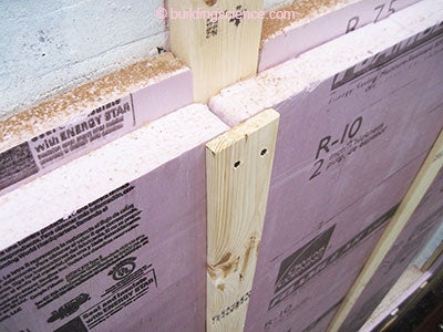

The “secret” trick is the 2x4 wood furring “on the flat”—once you attach that, everything else attaches to that, and it is easy sailing. And it is not a big deal to attach wood furring directly to masonry or to concrete—we know how to do that (Photograph 3).
Photograph 3: 2x4 wood furring “on the flat” – once you attach that everything else attaches to that and it is easy sailing. And it is not a big deal to attach wood furring directly to masonry or to concrete – we know how to do that.

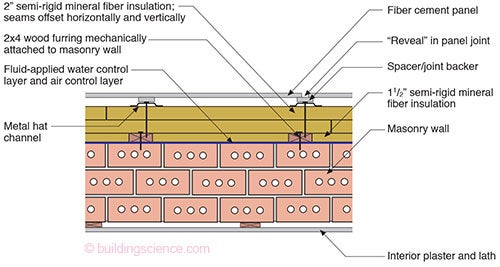

We got real help from everyone on this issue…manufacturers included. All of the walls passed the “don’t burn” “smell test.” The rigid foams all have a flame-spread index of 25 or less, and a smoke-developed index of 450 or less, and they are sandwiched between masonry and non-combustible claddings. If you want to go “all out,” use mineral fiber insulation and metal hat channels (Figure 2). Fluffy rocks covered with cement board held in place with steel anchors and metal channels installed over a masonry wall will please even the most persnickety Chicago fireman.
Figure 2: Non-Combustible Perfect Wall Retrofit—If you want to go “all out” use mineral fiber insulation and metal hat channels. Fluffy rocks covered with cement board held in place with steel anchors and metal channels installed over a masonry wall will please even the most persnickety Chicago fireman.

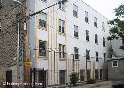

Believe it or not, the biggest code issue is a “set back” issue. When we do this retrofit, we are adding several inches to the outside of buildings and intruding on lot lines. The good news is that common sense wins the day. Giving up a couple inches to get a building or a house or a duplex a new lease on life—a comfortable energy efficient lease on life—is not a difficult sell…if the right calls to the right people are made at the right time…check out Photograph 4. Nobody misses the 6 inches between these two houses. This issue is going to come up again and again and again. Bylaws are going to have to be “massaged.” I thought I would never say this, but New York City has got it on the ball and does not count the exterior insulation in the “set back” dimension.5
Photograph 4: Set Back” Issue—We are adding several inches to the outside of buildings and intruding on lot lines. Nobody misses the 6 inches between these two houses. Bylaws are going to have to be “massaged.” I thought I would never say this, but New York City has got it on the ball and does not count the exterior insulation in the “set back” dimension.

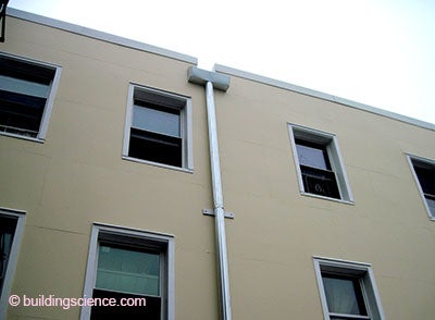

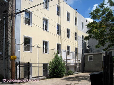

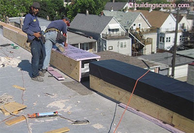

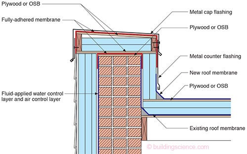

The jumbo-sized buildings have their own special problems…which we have all learned to call opportunities. Parapets and existing flat roofs that intersect the parapets provide interesting opportunities. You need to wrap the parapet with insulation—or get rid of it. I always make the “get rid of it” argument first. There is no good reason to have one anymore (BSI-050: Parapets—Where Roofs Meet Walls). Good luck with the “getting rid of it” argument. Folks seem to have an unnatural attraction to their parapets. Whatever. When you wrap the darn thing, it is a really good idea to insulate over the top of the existing roof and add a new membrane (Figure 3). And don’t forget to slope the parapet cap to the interior. And don’t forget the drip edges. And don’t forget the counter flashing. And don’t forget the air control layer continuity (Photograph 5 and Photograph 6).
Figure 3: You need to wrap the parapet with insulation—or get rid of it. When you wrap the darn thing it is a really good idea to insulate over the top of the existing roof and add a new membrane

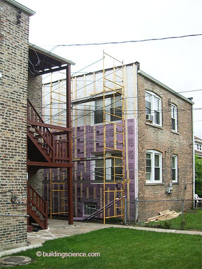

Photograph 5: Parapet Insulation—Don’t forget to slope the parapet to the interior.

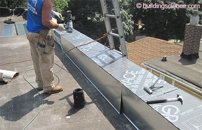

Photograph 6: Parapet Water Proofing—Don’t forget the drip edges. And don’t forget the counter flashing.

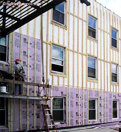

With the jumbo-sized buildings, you just start on one side and work your way around. First the fluid applied water control layer, and air control layer, and the 2x4 wood furring (Photograph 7). Then you layer in the rigid insulation (Photograph 8). Then the cladding. In this case, fiber cement panels (Photograph 9, Photograph 10 and Photograph 11).
Photograph 7: Jumbo Sequencing—With the jumbo sized buildings you just start on one side and work your way around. First the fluid applied water control layer and air control layer and the 2x4 wood furring.
Photograph 8: Next Step—Add the rigid insulation. Layer it between the furring and then over the entire kit and caboodle in continuous layers.
Photograph 9: Fiber cement Panels—Fireproof and pretty robust.
Photograph 10: More Fiber cement Panels—Note the “innie” windows. I don’t always win.
Photograph 11: Scupper Detail – You have to drain the roof.

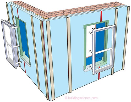

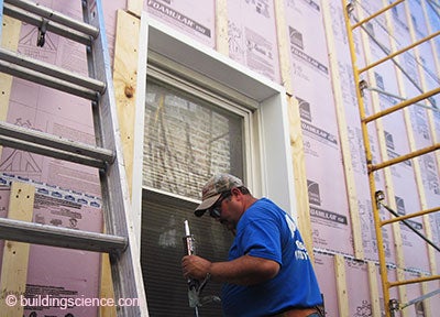

The big remaining question involves the windows. Are they “innies” or “outies.””? The physics calls for “outies” and that is they way that I push hard for (Figure 4). But lots of folks like the look of “innies” (Photograph 12). With “outies” the thermal control layer of the wall easily lines up with the thermal control layer of the windows. With “innies” this is not the case unless you make the window opening smaller. That reduces glazing area. Good luck with that argument. The best argument for “innies” is that the existing windows are good enough not to be replaced as part of the retrofit. If you are replacing the existing windows with new high performance windows, the best option is an “outie.”
Figure 4: “Outies” - The physics calls for “outies”. With “outies” the thermal control layer of the wall easily lines up with the thermal control layer of the windows.
Photograph 12: “Innie” Window—The best argument for “innies” is that the existing windows are good enough not to be replaced as part of the retrofit. If you are replacing the existing windows with new high performance windows the best option is an “outie.”
When you do “outies,” a plywood extension box is used to line the opening, and it protrudes outward past the outward face of the existing masonry to line up flush with the outermost layer of the rigid insulation (Figure 4). The window unit that is installed is typically a flanged window but it is installed with straps that fasten to the interior surfaces of the plywood extension box (Figure 5). Note that the exterior furring straps adjacent to the window openings are not installed until after the flanged window is mounted and “waterproofed.”
Figure 5: Flanged Window Attachment—When you do “outies,” a plywood extension box is used to line the opening and it protrudes outward past the outward face of the existing masonry to line up flush with the outermost layer of the rigid insulation. A flanged window is installed with straps that fasten to the interior surfaces of the plywood extension box. Note that the exterior furring straps adjacent to the window openings are not installed until after the flanged window is mounted and “waterproofed.”
