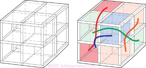

Actually, exterior wall, roof, interior floor and interior wall/partition assemblies are often hollow or multi-layered with numerous air gaps or void spaces and can operate under air pressure regimes (fields) that are largely independent of the air pressures on either side of them. Typical buildings also contain numerous service chases that provide complex three-dimensional linkage among the exterior wall, roof, interior floor and interior wall/partition assembly cavities and void spaces. These interstitial air pressure fields within building assemblies and their linkage to chases and service cavities can lead to lateral flow paths or more intricate three dimensional flow paths that may or may not connect to the interior or exterior spaces that the building assemblies separate.
Figure_01: 3D-cell
Figure 1: Three dimensional multi-layer multi-cell analogue (left)
with air pressure fields connecting non-contiguous spaces illustrated (right)
As a result of these interstitial air pressure fields, direct cross assembly (one-dimensional) air flow does not always hold. To account for the presence of interstitial air pressure fields air flow must be added or subtracted within an assembly, chase or void space. In this manner, continuity of mass and momentum holds across the volume of the assembly or element.
The interstitial air pressure fields often vary with time with complex daily, weekly, seasonal and sometimes random cycles. They are often, but not always, driven by fan forces coupled with duct leakage. Thermal effects, moisture effects and wind forces can also be interstitial air pressure field drivers depending on the linkages of interstitial flow paths. These time variable interstitial air pressure fields help characterize the dynamic characteristics of the pressure response of buildings.
The presence of complex, time dependent interstitial air pressure fields and associated lateral or three dimensional flow paths can lead to complex interactions of the building structure with the mechanical system and climate. Understanding the complex interactions of the building pressure field - the air pressure regime within and surrounding the building - helps explain the increasingly common failures related to:

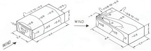

The exterior field extends from infinity to the exterior skin of the building envelope. The remaining three component fields are inward of the exterior skin of the building envelope except in the special case of ductwork associated with the air conveyance system field that is located to the building exterior.
When considering the exterior field, the boundary layer at the building envelope surface is typically of primary significance in building analysis. The above grade portion of the exterior field is typically dominated by wind-induced flows (Figures 2 and 3). The below grade portion of the exterior field is a function of the soil characteristics (air porosity), the footprint of the building, the interaction with the building and time dependent atmospheric pressures in the vicinity of the building (Figure 4).
Figure_02: Exterior air pressure field
Figure 2: Exterior air pressure field (from Hutcheon and Handegord, 1983)
Figure_03: Pressure_coefficients ASHRAE
Figure 3: Pressure coefficients on walls and roof of rectangular
buildings without parapets (ASHRAE Handbook of Fundamentals)

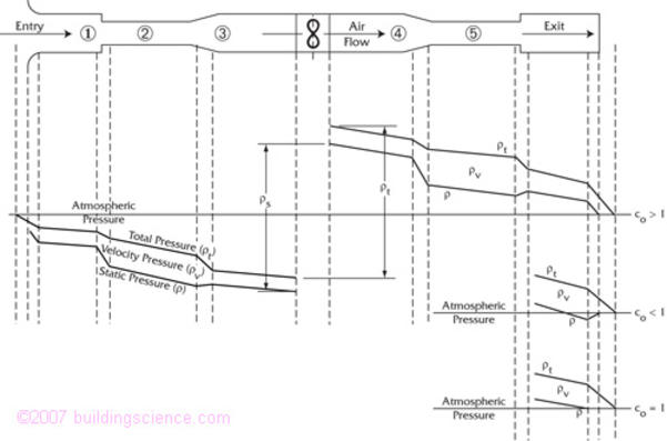

The air conveyance system field occurs within the ductwork of forced-air thermal distribution systems, chimneys, air exhaust and air supply systems (Figure 7) and is dominated by the size and capacity of duct work, fans and blowers and temperature differentials. It is bounded by the other three pressure fields.
Figure_07: Air conveyance air pressure field
Figure 7: Air conveyance air pressure field

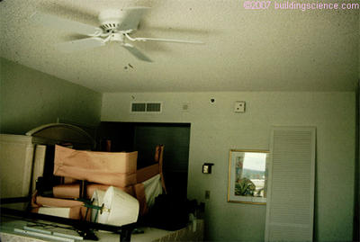

A hotel room/bathroom suite with an exhaust grill, a fan coil unit, corridor make-up air and steel stud partition walls provides a good example of the dynamic interaction of the component fields and the limitations of traditional analysis (Figure 8).
Figure_08: Hotel room/bath suite plan view
Figure 8:
Photo_01: Typical hotel room/bath suite
Photograph 1:

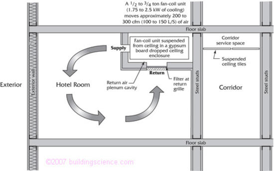

As is common in hotel construction, a fan coil unit is suspended from the ceiling and enclosed in a gypsum board dropped ceiling enclosure. The dropped ceiling enclosure is designed as a return air plenum. The fan coil unit provides heating and cooling to the hotel room by pulling air from the room through a return grille located at the underside of the dropped ceiling enclosure, conditioning the air, and returning the air through a supply register located in the face of the dropped ceiling enclosure. These units typically supply 1.75 to 2.5 kilowatts of heating and cooling and typically move approximately 100 to 150 L/s of air. Under conventional thinking, this fan coil unit only recirculates air and therefore does not affect the air pressure relationships in the room (Figure 9).
Figure_09: Hotel room/bath suite section

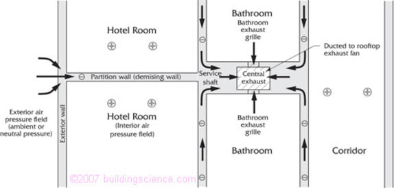

Additionally, an exhaust grill is located in the bathroom of each hotel room suite. This exhaust grill is typically connected to a central exhaust duct extending to a roof top exhaust fan. The roof top exhaust fan often serves several hotel room suites via the central exhaust duct. This exhaust fan typically runs continuously, although in some facilities, timer controlled operation occurs. Air which is exhausted from the hotel room/bathroom suite by this exhaust fan is intended to be replaced with make-up air supplied from the corridor. The main HVAC system typically supplies sufficient conditioned make-up air to the corridor to supply all of the hotel room suites served by the corridor.  Make-up air from the corridor is intended to enter the hotel rooms by passing under the door between the room and the corridor. This door is undercut to provide passage of air from the corridor to the room (Figure 10).
Figure_10: Hotel HVAC system
Figure 10:
Hotel HVAC system
  • Air exhausted from bathrooms via central rooftop exhaust fans.
  • Air supplied from corridors via undercut doors.

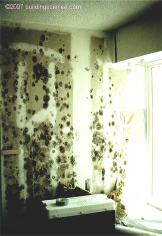

Mold contamination under vinyl wall coverings is an increasingly common problem in interior partition wall assemblies associated with buildings constructed as described in Figure 8, Figure 9 and Figure 10. The investigation of such a problem is typically instigated by one or a combination of the following symptoms:
  • the room smells;
  • the humidity levels within the room are excessive;
  • the vinyl wall covering becomes discolored with pink or maroon stains;
or
  • the gypsum board is soft and water logged.
Photo_02: Vinyl wall covering removed to expose mold
Photograph 2: Vinyl wall covering removed to expose mold on hotel room wall
Using traditional analysis, an investigation of the moisture damage in an unoccupied hotel room as described proceeds along the following path:

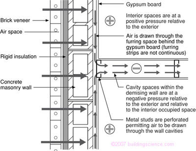

Hotel building envelope and interior wall construction are typically steel studs with gypsum board (Figure 11).  Steel studs are perforated with punched openings to facilitate installation of services.  These perforations create a connected wall cavity in both interior and exterior walls.  In exterior walls, fiberglass batt insulation is installed. As fiberglass batt insulation provides very small resistance to air flow, the connected wall cavity construction in both interior and exterior walls permits considering these walls as acting as air ducts.
Figure_11: Wall construction plan view
Figure 11: Wall construction plan view

Air Pressure Driver 1:  Fan Coil
In the example described in Figure 8 and Figure 9, the fan coil unit extracts air out of the dropped ceiling assembly because the dropped ceiling enclosure is designed to act as a return plenum.  Resistance to air flow is provided by a filter in the return grill creating a negative pressure within the dropped ceiling enclosure relative to its surroundings. However, dropped ceiling enclosures are seldom air tight due to numerous penetrations for controls, power supply, and piping. Additionally, joints and seams in the materials forming the dropped ceiling enclosure are difficult to make airtight.
The dropped ceiling enclosure is connected to the partition wall via the penetrations for controls, power supply, piping and through openings reflective of the prevailing construction practice. The partition wall is further connected to the exterior wall. A negative air pressure field is created in the partition wall relative to the rooms on both sides due to its connection to the dropped ceiling plenum. This negative air pressure field extends to the exterior wall and may or may not be negative with respect to the exterior.
If this air pressure field within the partition wall is also negative with respect to the exterior, it leads to the infiltration of hot humid air during cooling periods and contaminants during other periods through the exterior wall assembly, down the demising wall to the dropped ceiling assembly (Figure 12). During cooling periods when this air is cooled due to the cooling of the hotel rooms on both sides of the partition wall, moisture is deposited in the wall cavities leading to mold and microbial contamination.
Figure_12: Pressure field due to fan-coil unit
Figure 12:
  • Room is at positive air pressure relative to exterior-driven air from corridor and air supplied to room from fan-coil unit pulling air from exterior through demising wall.
  • Fan-coil unit depressurizes dropped ceiling assembly due to return plenum design.
  • Demising wall cavity pulled negative due to connection to dropped ceiling return plenum.
This negative air pressure field in the interstitial spaces exists only when the fan coil unit is operating and exists despite the positive air pressure in the hotel room created by the air flow from the corridor. This interstitial negative air pressure field is time dependent and is related to the duty cycle of the fan coil unit.
The partition wall acts as an outside air duct supplying outside air to the fan coil. This outside air supply tends to increase the positive air pressure in the room with respect to the exterior. This causes fluctuation in the positive pressure (with respect to the exterior) in the room in synchronization with the duty cycle of the fan-coil. It also leads to elevated levels of air borne moisture within the room.

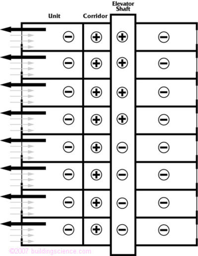

Air Pressure Driver 2:  Central Exhaust
In a similar manner to the fan coil unit induced interstitial partition wall depressurization, leakage of the central exhaust duct located within the plumbing service shaft also leads to the creation of a negative air pressure field relative to the rooms in the opposite demising wall that also extends to the exterior wall. This negative air pressure field exists only when the roof top exhaust fan operates and again exists despite the positive air pressure in the hotel room (Figure 13). When the bathroom door is closed, the flow path from the suite to the exhaust grill in the bathroom is interrupted creating a flow resistance resulting in more air to be extracted from the partition wall.  This results in increased depressurization within the partition wall on a cycle matched to the opening and closing of the bathroom door.
Figure_13: Pressure field due to central exhaust
Figure 13:
Pressure field due to central exhaust plan view
  • Leakage of central exhaust duct pulls air out of service shaft depressurizing shaft and demising walls.
The negative air pressure field due to the roof top exhaust fan (as modified by bathroom door closure) may or may not be negative with respect to the exterior. If it is negative with respect to the exterior, it will result in the infiltration of exterior air into the partition wall, similar to the fan coil unit example. However, it will not lead to an increase in the levels of air borne moisture within the room since the flow path of this infiltrating air is to the plumbing service shaft and subsequently out of the building via the roof top exhaust fan. This infiltrating air does not enter the rooms on either side of the partition wall.
However, moisture in the infiltrating air is deposited on the gypsum board surfaces enclosing the partition wall interstitial cavity. The deposited moisture migrates by diffusion to the vinyl wall covering/gypsum board interface. Little moisture diffuses through the vinyl wall covering therefore not affecting the room air borne moisture levels. Unfortunately, the gypsum board and the vinyl wall covering both deteriorate due to the accumulated moisture.
