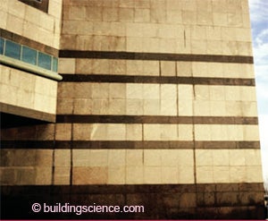

The cladding is often precast concrete or granite or marble or limestone (Photographs 1 and 2). Yes, it’s true. Caulked 2.5 in. (64 mm) Indiana limestone is the same as 5 in. (127 mm) precast panels. The joints in the cladding are sealed with some type of sealant. The more recent variations use a two-stage joint (yeah, baby!). The two-stage joint is a good thing; perhaps the only good thing in the entire mess. In these types of assemblies the rain control is a "perfect barrier” that works for the panels, but not at the joints and windows, therefore, two-stage drained joints are used at these locations.
Photograph 1: Face-Sealed Panels
–High risk in cold climates if air permeable insulation is used.

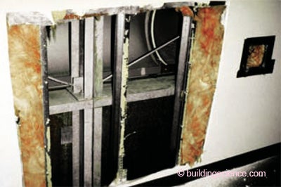

Photograph 2: Back Side of Panel
–First condensing surface if interior air gets access to surface.

The actual mechanism is pretty easy to conceptualize: convective looping of interior air between the interior and the interstitial cavity existing between the back of the cladding and the interior gypsum board lining (Figure 2). Warm and moist interior air migrates into the interstitial cavity through gaps in the interior gypsum board and through gaps in the impossible to perfectly seal plastic or foil interior “vapor barrier.” This warm and moist interior air passes through the air permeable insulation and contacts the backside of the cladding. The cladding is, for all practical purposes, uninsulated and, therefore, at close to exterior temperature. As a simple first order approximation7  whenever the exterior temperature of the interior air, bad things happen (Photographs 3 and 4).
Figure 2: Failure Mode
–Convective looping of interior air between the interior and the interstitial cavity existing between the back of the cladding and the interior gypsum board lining leading to condensation, corrosion, mold, odors and generally bad things.

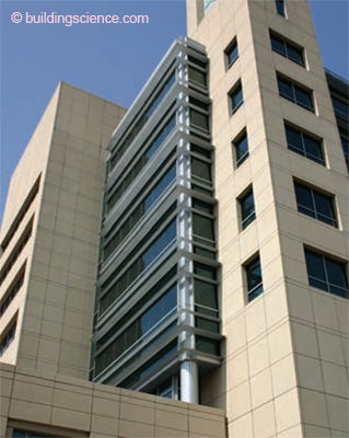

The airflow control part means caulking and sealing and caulking and sealing and then praying a great deal. We call this "faith-based air leakage control." Good luck. Buying lottery tickets is probably a better option. The Leafs winning the Stanley Cup is certainly a better option. Precast makes for beautiful building (Photograph 5). But will it work? Ah, the high risk versus low risk question?
Photograph 5: Federal Reserve Building in Minnesot
a–Beautiful. But will it work?

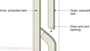

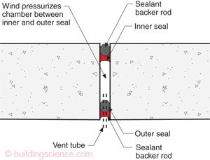

So what is a two-stage joint? Well, we talked about them in BSI-004: Drainage, Holes and Moderation. Figure 3 is from that discussion. An inner and outer seal provide drainage at joints. The outer seal is exposed to the elements and gets trashed by the UV and heat and water, but the assembly still works because of the interior protected seal. This interior seal is installed from the exterior for continuity reasons. Figures 4a and 4b show the vertical section through the joint in both 2-D and 3-D. Pretty clever, huh? The drainage to the exterior is being done with the outer seal sloped to the interior at drainage openings. I love stuff like this.
Figure 3: Two-Stage Joint
—An inner and outer seal provide drainage at joints. The outer seal is exposed to the elements and gets trashed by the UV and heat and water but the assembly still works because of the interior protected seal. This interior seal is installed from the exterior for continuity reasons.
Figure 4a: Draining Joint (2-D)
–Clever use of sealant to direct water that may enter joint cavity to the exterior.
Figure 4b: Draining Joint (3-D)
–Need to draw it up three dimensionally in order to “get it.” Brilliant.

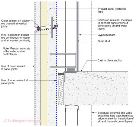

So what does a “low risk” wall look like when you use a face-sealed cladding (“perfect barrier”) that is impermeable to water vapor? Check out Figure 5. Note the air impermeable spray insulation or board insulation that is applied directly to the interior of the exterior cladding. The spray insulation should be spray polyurethane foam—the “high density” stuff—2 lb/ft3 (0.91 kg/m3) closed cell material when you are north of the Mason-Dixon Line. A big trick in making this work is pulling back the columns and beams at least 6 in. (152 mm) or so to allow continuous access to the back of the cladding. Trust me on this. The other big deal is to integrate the window into the assembly. Two-stage joints all around (Figure 6).
Figure 5: Low Risk Wall
–Impermeable face-sealed cladding (“perfect barrier”) that is internally insulated with air impermeable insulation. Typically spray applied 2 lb/ft3 (0.91 kg/m3) polyurethane foam or rigid foam board directly adhered to the backside of the exterior cladding with all joints sealed.

An even better approach is where you create a sandwich panel: a preinsulated precast panel (Figure 7). No fuss, no muss. About as low risk as you can get. Tom Cruise eat your heart out.
Figure 7: Sandwich Panel–
Low risk preinsulated precast panel. Rigid insulation located between two layers of concrete that comprise the panel.
