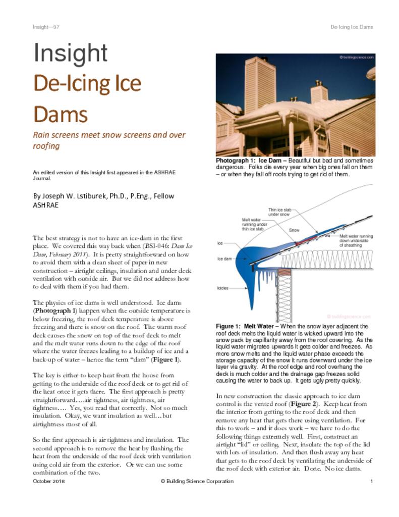

BSI-097: De-Icing Ice Dams
The best strategy is not to have an ice-dam in the first place.  We covered this way back when (BSI-046: Dam Ice Dam, February 2011).  It is pretty straightforward on how to avoid them with a clean sheet of paper in new construction – airtight ceilings, insulation and under deck ventilation with outside air.  But we did not address how to deal with them if you had them.
The physics of ice dams is well understood. Ice dams (Photograph 1) happen when the outside temperature is below freezing, the roof deck temperature is above freezing and there is snow on the roof.  The warm roof deck causes the snow on top of the roof deck to melt and the melt water runs down to the edge of the roof where the water freezes leading to a buildup of ice and a back-up of water – hence the term “dam” (Figure 1).
The key is either to keep heat from the house from getting to the underside of the roof deck or to get rid of the heat once it gets there.  The first approach is pretty straightforward….air tightness, air tightness, air tightness…. Yes, you read that correctly.  Not so much insulation.  Okay, we want insulation as well…but airtightness most of all.
So the first approach is air tightness and insulation.  The second approach is to remove the heat by flushing the heat from the underside of the roof deck with ventilation using cold air from the exterior.   Or we can use some combination of the two.
Photograph 1:  Ice Dam –Beautiful but bad and sometimes dangerous.  Folks die every year when big ones fall on them – or when they fall off roofs trying to get rid of them.
Figure 1:  Melt Water –When the snow layer adjacent the roof deck melts the liquid water is wicked upward into the snow pack by capillarity away from the roof covering.  As the liquid water migrates upwards it gets colder and freezes.  As more snow melts and the liquid water phase exceeds the storage capacity of the snow it runs downward under the ice layer via gravity. At the roof edge and roof overhang the deck is much colder and the drainage gap freezes solid causing the water to back up.  It gets ugly pretty quickly.
In new construction the classic approach to ice dam control is the vented roof (Figure 2).  Keep heat from the interior from getting to the roof deck and then remove any heat that gets there using ventilation.  For this to work – and it does work – we have to do the following things extremely well. First, construct an airtight “lid” or ceiling.  Next, insulate the top of the lid with lots of insulation.  And then flush away any heat that gets to the roof deck by ventilating the underside of the roof deck with exterior air.  Done.  No ice dams.
