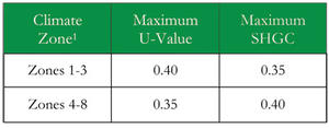

  • Windows with the following climate-specific1 performance values must be used. Windows outside these ranges can be used in certain designed circumstances, but these are our general guidelines to maximize both energy performance and thermal comfort.
