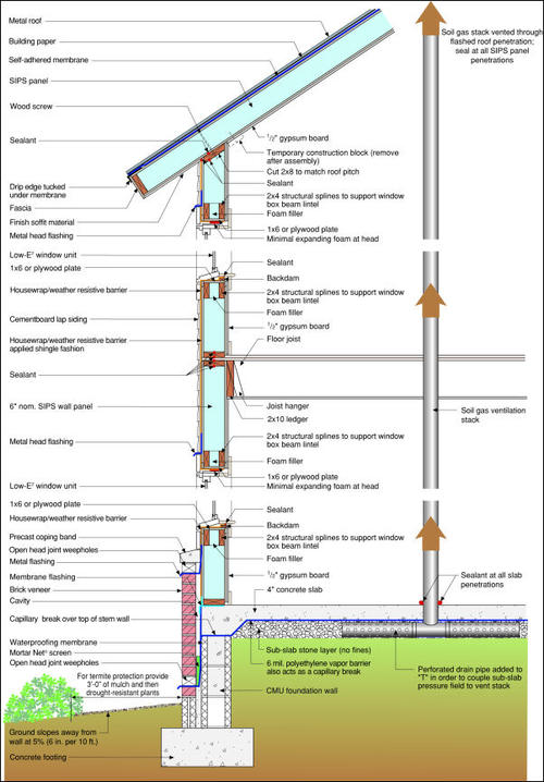

Figure 1: Alternative SIPS roof framing
Figure 2a: Sealant locations between panels
Figure 2b: Above grade wall spline
Figure 3: Load bearing window jamb assembly
  • Air sealing details at transitions- Air sealing is important at assembly transitions such as top-of-wall/roof assembly junctions, SIPS panel joints, and between attached garages and living spaces.
    • Top-of-wall/roof assembly junction – Air barrier continuity can be provided at this junction if sealant is used on the top and bottom of the top plate. See Figure 1 for an alternative roof framing option using SIPS panels.
    • SIPS panel joints – Air barrier continuity can be provided at SIPS panel joints with a continuous bead of sealant between foam sections and a continuous bead of sealant between the plywood or OSB skin panels on the interior. See Figure 2a for details. See Figure 2b for an alternative above grade wall spline detail. Also note on the cross section the wall/floor air sealing detail between the first and second floors.

  • Drainage plane, air barrier, and vapor control – The primary drainage plane behind both the cement board and the brick veneer is the housewrap/weather resistant barrier (WRB) over the SIPS panel and the waterproofing membrane over the slab and stem wall. Flashing details at penetrations must reflect this difference.
    The housewrap/weather resistant barrier (WRB) is an important “back-up” protection against liquid water penetration into the SIPS panels. On first and second floor, the air barrier is the SIPS panel. Control of moisture drive from the outside in is accomplished by the relative impermeability of the SIPS panel.
    The roofing paper underneath the standing seam metal roof has two functions. It serves as a slip surface for the roofing for expansion and contraction of the metal, and it serves as a secondary drainage plane for moisture that might condense on the underside of the metal roofing as the result of night-sky radiation and subsequent condensation.
  • Window flashing – Window flashing details are wall assembly or cladding specific. See Figure 3 for a detail of a load bearing window jamb assembly.
  • Framing on slabs - Installing a capillary break between the sill plate and a concrete slab on all walls—exterior, interior, partition—is good practice. A closed cell foam sill sealer or gasket works well. Alternatively, a strip of sheet polyethylene can be used. This isolates the framing from any source of moisture that may be either in or on the concrete slab (and using sill sealer on all walls maintains wall height exactly the same).
  • Soil gas ventilation – The sub-slab to roof vent system handles conditions that are difficult if not impossible to assess prior to completion of the structure— confined concentrations of air-borne radon, soil treatments (termiticides, pesticides) methane, etc. The cost of this "ounce" of prevention is well balanced against the cost of the "pound" of cure. Note that this system is a passive system that can easily be converted to an active ventilation system by installing an in-line fan into the stack in the attic.
  • Thermal barrier – The foam sandwiched between the plywood skins of the SIPS panels on the walls and roof is the thermal barrier. It should be noted that in this climate, moisture control does not require specific levels of insulation; but, it does require joints between panels be sealed to control air transported moisture. Inside/outside temperature differences do not require cavity-warming exterior rigid insulation to control wintertime condensing surface temperatures.
  • Sub-slab stone bed - The four-inch deep 3/4" stone bed functions as a granular capillary break, a drainage pad, and a sub-slab air pressure field extender for the soil gas ventilation system. The sub-slab stone bed is a practical method for venting soil gas should be necessary.
