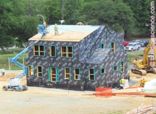

We are getting very good at building tight enclosures by wrapping them with fully adhered membranes and all manner of other things (Photographs 1, 2 and 3)—and retrofitting old ones and getting them tight—especially when we use spray polyurethane foam (SPF) (Photograph 4). With tight building enclosures we sure end up with problems if we don’t deal with the obvious…and deal with the obvious in the obvious way.
Photograph 1 (left): Ultra Tight House – Advanced frame house sealed with a fully adhered exterior air control layer installed over structural sheathing yields an enclosure with a leakage rate less than 0.5 ach@50 Pa as tested under pressurization or depressurization. Photograph 2 (right): More Ultra Tight House – Continuous exterior insulation installed over fully adhered exterior air control layer to control condensation at the exterior air control layer – structural sheathing interface. Note that the garage is not attached to the house. Good idea, but typically not possible.

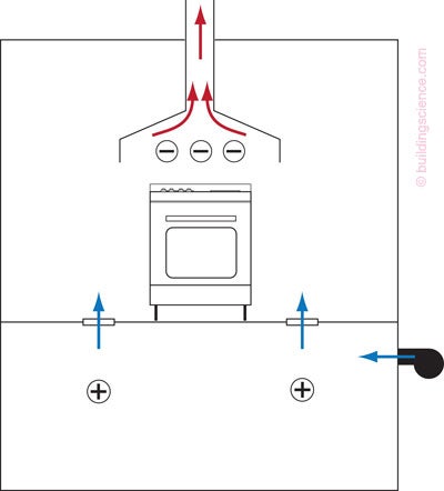

Lets say that you have a 1,000 cfm kitchen exhaust hood going into a tight house. Happens all the time. When the exhaust hood is operating you can suck a golf ball down a garden hose with the resulting negative pressure. The first thing we make sure of is that the exhaust hood actually works to capture the effluent. The hood must overhang the cooking surface big time. The absolute best approach is to use a backshelf hood with side panels and large over hangs on both sides and the front (Figure 2). Nothing new here – read Chapter 33.

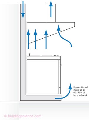

Now we need make-up air. When dealing with large hoods (greater than 400 cfm) we recommend providing two kinds at the same time but at different places. First we provide direct make-up air using a modified backwall approach such that this make-up air is introduced at floor level (Figure 2). This direct make-up air introduced at floor level should never provide more than 60 to 70 percent of the hood exhaust. So for our 1,000 cfm exhaust our direct make-up air flow should be between 600 and 700 cfm. This air is rarely conditioned – except when we deal with rich clients in Aspen or Naples.9 If you can’t stand the heat get out of the kitchen is based on reality.
Figure 2: Capture the Effluent - The first thing we make sure is that the exhaust hood actually works to capture the effluent. The hood must overhang the cooking surface big time. The absolute best approach is to use a backshelf hood with side panels and large over hangs on both sides and the front. Backshelf hoods can typically use 30 percent less exhaust to capture bad stuff compared to other hoods. Side panels can get you another 30 percent improvement. Note the direct make-up air using a modified backwall approach such that this make-up air is introduced at floor level. This direct make-up air introduced at floor level should never provide more than 60 to 70 percent of the hood exhaust. Why? Ah, we need a zone of negative pressure around the cooking surface – you don’t want to push the bad stuff, you want to pull the bad stuff.
Note that at this point we have only satisfied 60 to 70 percent of the make-up air requirement. We now provide a second system that meets the rest – plus a little bit – and this air is typically preconditioned. In our example we now provide around 350 to 400 cfm of conditioned make-up air at the perimeter of the kitchen area (Figure 3). We “suck” at the center and “blow” at the perimeter. The exhaust hood and the make-up air systems are interlocked. When they are operating the rest of the house does not know they are there. We in essence have uncoupled the kitchen from the rest of the building HVAC systems. We condition the kitchen cooking area with the house HVAC system pretending that the cook top/oven and range hood are not there.
Figure 3: Satisfaction – We satisfy 60 to 70 percent of the make-up air requirement with the modified backwall approach introducing air at floor level (the “blue arrows” at the lower grilles on each side of the appliance). We now provide a second system that meets the rest – plus a little bit (around 350 to 400 cfm) – and this air is typically preconditioned and introduced at the ceiling at the perimeter of the kitchen area (the “blue arrows” coming from the two ceiling registers). We “suck” at the center of the space at the appliance and “blow” at the perimeter. The exhaust hood and the two make-up air systems are interlocked. When they are operating the rest of the house does not know they are there. We in essence have uncoupled the kitchen from the rest of the building HVAC systems (the “black dashed arrows” entering from the floor registers and leaving up high on the wall). We condition the kitchen cooking area with the house HVAC system pretending that the cook top/oven and range hood are not there.

But what if I only have a 200 cfm kitchen range hood? It gets easier. Check out Figure 4. We interlock the range hood exhaust with a supply fan that provides make-up air at roughly a 10 percent greater flow rate than the hood exhaust rate. This make-up air is typically provided in a separate zone like a basement that provides ample tempering of the make-up air by mixing. It then is introduced via floor registers adjacent the cook surface. The zone around the appliance needs to “suck” but the rest of the space blows or is neutral. The 10 percent greater flow rate works because this air is not directly introduced under the appliance but into the adjacent zone and moves into the cooking area as transfer air.
Figure 4: Smaller Hoods Are Easier – With a 200 cfm kitchen range hood we interlock the range hood exhaust with a supply fan that provides make-up air at roughly a 10 percent greater flow rate than the hood exhaust rate. This make-up air is typically provided in a separate zone like a basement that provides ample tempering of the make-up air by mixing. It then is introduced via floor registers adjacent the cook surface. The zone around the appliance needs to “suck” but the rest of the space blows or is neutral. The 10 percent greater flow rate works because this air is not directly introduced under the appliance but into the adjacent zone and moves into the cooking area as transfer air.
