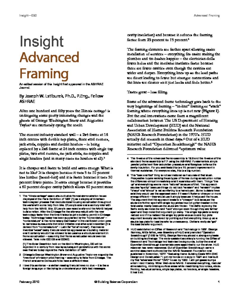

After one hundred and fifty years the Illinois cottage1 is undergoing some pretty interesting changes and the ghosts of George Washington Snow and Augustine Taylor2 are cautiously eyeing the result.
The current industry standard wall – a 2x4 frame at 16-inch centers with double top plates, three stud corners, jack studs, cripples and double headers – is being replaced by a 2x6 frame at 24-inch centers with single top plates, two stud corners, no jack studs, no cripples and single headers (and in many cases no headers at all).3
It is cheaper and faster to build and saves energy. What is not to like? It is cheaper because it uses 5 to 10 percent less lumber (board-feet) and it is faster because it uses 30 percent fewer pieces. It saves energy because it provides a 60 percent deeper cavity (which allows 60 percent more cavity insulation) and because it reduces the framing factor from 25 percent to 15 percent.4
The framing elements are farther apart allowing easier installation of services – everything fits easier making the plumber and tin-basher happier – the electrician drills fewer holes and the insulator insulates faster because there are fewer cavities even though the cavities are wider and deeper. Everything lines up so the load paths are direct leading to fewer but stronger connections and the lines are cleaner so it just looks and feels better.5
Tastes great – less filling.

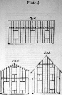

Some of the advanced frame technology goes back to the very beginnings of framing – “in-line” framing or “stack” framing where everything lines up is not new (Figure 1). But the real innovations came from a magnificent collaboration between The US Department of Housing and Urban Development (HUD) and the National Association of Home Builders Research Foundation (NAHB Research Foundation) in the 1970’s. HUD actually did research in those days.6 Out of a HUD initiative called “Operation Breakthrough” the NAHB Research Foundation delivered “optimum value engineering framing” or “OVE framing.” Today we call it “advanced framing.” Why the name changed no one knows.7
Figure 1: In-line Framing – Image from “The American Cottage Builder,” John Bullock, Stringer and Townsend, New York, NY, 1854. Great, great granddad figured this out way back when.
Figure 2: Advanced Framing - 2x6 frame at 24 inch centers with single top plates, two stud corners, no jack studs, no cripples and single headers in load bearing walls and no headers in non-load bearing walls.

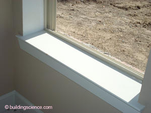

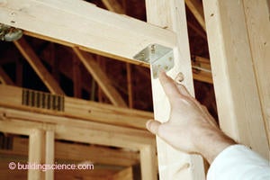

Figure 2 shows the current expression of advanced framing. Everything lines up so that double top plates are not necessary (Photograph 1). No headers in non-load bearing walls. Window openings are clean without jack studs and cripples (Photograph 2). Exterior corners have two studs (Photograph 3). Gypsum board is supported with “drywall clips” (Photograph 4). And all of this is code accepted by the model building codes courtesy of a whole bunch for foresight by HUD and the NAHB in the early 1980’s. Although it’s in the code most code officials are not aware of it and even fewer builders. And engineers? Talk about an information disconnect. The push back from structural engineers centers mainly around the fact that with advanced framing they would be required to do something they hadn’t done since graduation – a calculation. Yup, now they would have to deal with different values not found in tables. They would have to look at a textbook and re-program the computer.

Photograph 2: Window Opening - Non-load bearing wall window openings are clean without jack studs and cripples.

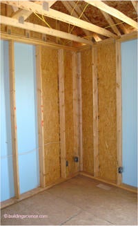

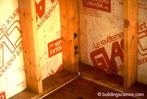

Photograph 3: Corner Framing - My first advanced frame building in 1982 using a two-stud corner.

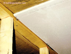

Photograph 4: Gypsum Board Support – Drywall clips result in floating corners, a good thing, as drywall cracking is reduced.

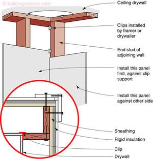

One of the biggest pushback’s from builders and code officials comes from corner support for gypsum board and trim (Figure 3 and Figure 4). Explaining that “floating corners” reduce drywall cracking and are therefore an improvement takes a little bit of time. Wood always moves because of changing moisture contents. Gypsum board does not want to move – ever. When you attach something that is always moving to something that does not want to move you get a problem. We call that a crack. They key to reducing drywall cracking is to attach it less. We learned this with truss rise in the early 80’s where we developed floating corners and drywall clips. Back then the easiest drywall clip was to cut a piece of corner bead into 2-inch lengths. Presto, a corner bead. The best way to attach the drywall “less” is to not have wood there to attach it to. Technically this is called adding an extra degree of freedom of movement. The rest of us would just call it smart.
Figure 3: Two-Stud Corner – Gypsum board supported by a corner clip yielding a “floating corner” reducing drywall cracks and call backs.

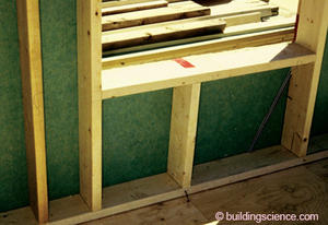

Folks, the interior walls are also framed on 24-inch centers. But these ones are 2x4’s. And almost all of them are not load bearing so the connections are pretty much non-structural (Photograph 5).
Photograph 5: Interior Wall Framing - Also framed on 24-inch centers. But these ones are 2x4’s. And almost all of them are not load bearing so the connections are pretty much non-structural.

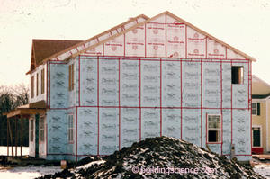

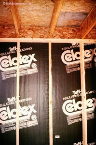

Things get interesting when we add insulating sheathing. Now insulating sheathing is not part of advanced framing. It is just that most folks that use advanced framing today also use insulating sheathing (Photograph 6). With insulating sheathing the water control layer is the exterior face of the insulating sheathing taped. Insulating sheathing provides no “racking resistance” or “shear” properties. For that we need OSB or plywood “braced wall panels” (a.k.a. “shear panels”) – and most builders build them into corners (Photograph 7). This leads to interesting corner construction (Photograph 8). The combination of advanced framing and insulating sheathing leads to deep window openings (Photograph 9). Window returns are typically gypsum board with wood trim only at the bottom.
Photograph 6: Insulating Sheathing - With insulating sheathing the water control layer is the exterior face of the insulating sheathing taped.
Photograph 7: OSB Braced Wall Panels - Insulating sheathing provides no “racking resistance” or “shear” properties. For that we need OSB or plywood braced wall panels – and most builders build them into corners.
Photograph 8: Corner Framing With OSB and Insulating Sheathing – Note that the foam sheathing is reduced over the OSB shear panel so that the thickness of both sheathing layers line up with the thickness of the sheathing in the field of the wall. Also, note the spacer strip between the cladding and the exterior face of the insulating sheathing to provide back ventilation and drainage of the cladding layer and trim.
Photograph 9: Deep Window Openings - The combination of advanced framing and insulating sheathing leads to deep window openings. Window returns are typically gypsum board with wood trim only at the bottom.
