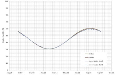

Open-cell spray foam is an air barrier, but is vapor permeable. The relative humidity was predicted in the center of the open-cell spray foam insulation and was found to be at safe levels (Figure 2).
Low permeance interior wall finishes should be avoided with this construction strategy.
Figure 2: Predicted RH at the interior surface of open-cell spray foam
