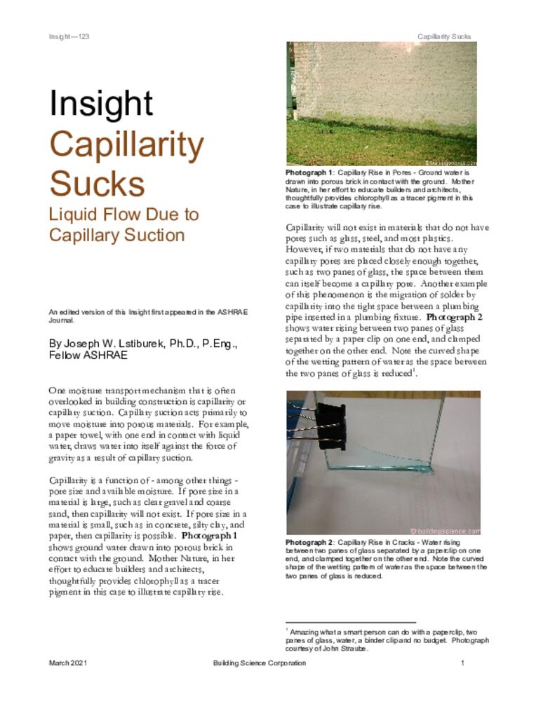

Photograph 1: Capillary Rise in Pores - Ground water is drawn into porous brick in contact with the ground. Mother Nature, in her effort to educate builders and architects, thoughtfully provides chlorophyll as a tracer pigment in this case to illustrate capillary rise.
Capillarity will not exist in materials that do not have pores such as glass, steel, and most plastics. However, if two materials that do not have any capillary pores are placed closely enough together, such as two panes of glass, the space between them can itself become a capillary pore. Another example of this phenomenon is the migration of solder by capillarity into the tight space between a plumbing pipe inserted in a plumbing fixture. Photograph 2 shows water rising between two panes of glass separated by a paper clip on one end, and clamped together on the other end. Note the curved shape of the wetting pattern of water as the space between the two panes of glass is reduced1.
Photograph 2: Capillary Rise in Cracks - Water rising between two panes of glass separated by a paper clip on one end, and clamped together on the other end. Note the curved shape of the wetting pattern of water as the space between the two panes of glass is reduced.

1 Amazing what a smart person can do with a paper clip, two panes of glass, water, a binder clip and no budget. Photograph courtesy of John Straube.
