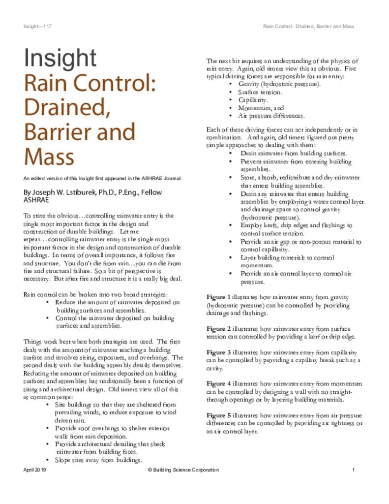

To state the obvious…controlling rainwater entry is the single most important factor in the design and construction of durable buildings.  Let me repeat….controlling rainwater entry is the single most important factor in the design and construction of durable buildings.  In terms of overall importance, it follows fire and structure.  You don’t die from rain…you can die from fire and structural failure.  So a bit of perspective is necessary.  But after fire and structure it is a really big deal.
Rain control can be broken into two broad strategies:
•    Reduce the amount of rainwater deposited on building surfaces and assemblies.
•    Control the rainwater deposited on building surfaces and assemblies.
Things work best when both strategies are used.  The first deals with the amount of rainwater reaching a building surface and involves siting, exposures, and overhangs. The second deals with the building assembly details themselves.
Reducing the amount of rainwater deposited on building surfaces and assemblies has traditionally been a function of siting and architectural design.  Old timers view all of this as common sense:
•    Site buildings so that they are sheltered from prevailing winds, to reduce exposure to wind driven rain.
•    Provide roof overhangs to shelter exterior walls from rain deposition.
•    Provide architectural detailing that sheds rainwater from building faces.
•    Slope sites away from buildings.
The next bit requires an understanding of the physics of rain entry.  Again, old timers view this as obvious.  Five typical driving forces are responsible for rain entry:
•    Gravity (hydrostatic pressure).
•    Surface tension.
•    Capillarity.
•    Momentum, and
•    Air pressure differences.
Each of these driving forces can act independently or in combination.   And again, old timers figured out pretty simple approaches to dealing with them:
•    Drain rainwater from building surfaces.
•    Prevent rainwater from entering building assemblies.
•    Store, absorb, redistribute and dry rainwater that enters building assemblies.
•    Drain any rainwater that enters building assemblies by employing a water control layer and drainage space to control gravity (hydrostatic pressure).
•    Employ kerfs, drip edges and flashings to control surface tension.
•    Provide an air gap or non-porous material to control capillarity.
•    Layer building materials to control momentum.
•    Provide an air control layer to control air pressure.
Figure 1 illustrates how rainwater entry from gravity (hydrostatic pressure) can be controlled by providing drainage and flashings.
Figure 2 illustrates how rainwater entry from surface tension can controlled by providing a kerf or drip edge.
Figure 3 illustrates how rainwater entry from capillarity can be controlled by providing a capillary break such as a cavity.
Figure 4 illustrates how rainwater entry from momentum can be controlled by designing a wall with no straight-through openings or by layering building materials.
Figure 5 illustrates how rainwater entry from air pressure differences can be controlled by providing air tightness or an air control layer.
