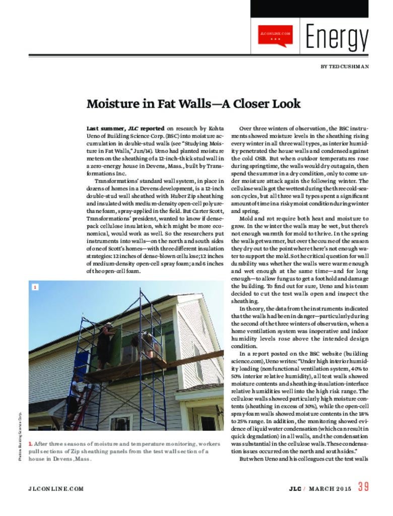

Transformations' standard wall system, in place in dozens of homes in a Devens development, is a 12-inch double-stud wall sheathed with Huber Zip sheathing and insulated with medium-density open-cell polyurethane foam, spray-applied in the field. But Carter Scott, Transformations' president, wanted to know if densepack cellulose insulation, which might be more economical, would work as well. So the researchers put instruments into walls—on the north and south sides of one of Scott's homes—with three different insulation strategies: 12 inches of dense-blown cellulose; 12 inches of medium-density open-cell spray foam; and 6 inches of the open-cell foam.
Figure 1: After three seasons of moisture and temperature monitoring, workers pull sections of Zip sheathing panels from the test wall section of a house in Devens, Mass.
Over three winters of observation, the BSC instruments showed moisture levels in the sheathing rising every winter in all three wall types, as interior humidity penetrated the house walls and condensed against the cold OSB. But when outdoor temperatures rose during springtime, the walls would dry out again, then spend the summer in a dry condition, only to come under moisture attack again the following winter. The cellulose walls got the wettest during the three cold-season cycles, but all three wall types spent a significant amount of time in a risky moist condition during winter and spring.

But when Ueno and his colleagues cut the test walls open to examine the sheathing after three seasons of monitoring, the results were surprising.
Says the BSC report: “Based on the data, calculations, and analysis, all three walls should be at high risk of failure; the analytic tools used indicate that these walls should have failed. However, disassembly showed that the walls were essentially undamaged by the monitored moisture exposure. This suggests that the walls, at least in the configurations tested, were far more robust than current analysis tools would indicate.”
“All the instrumentation and monitoring said that these walls got hammered in terms of moisture content, relative humidity, condensation, anything like that,” Ueno told JLC in a phone interview. “And the current analysis tools in the toolbox say this wall should be toast. But we opened it up and it was like, ‘Huh. Well, there’s a little bit of grain raise. The fasteners are a little bit rusty. That’s about it.’”
