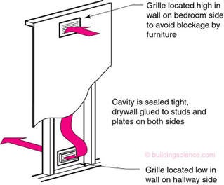

Figure 1b: Even More Negative – When you then install systems with central returns that are also unbalanced in that return paths are not provided from bedrooms to the central returns the pressure effects are magnified. Undercutting doors does not work unless you have a “knee high” undercut.

Figure 2b: Transfer Grilles – This also addresses the problem in Figure 1b. Less expensive than a “jump duct” but not as quiet.

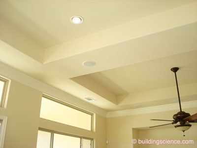

Photograph 3: Bulkhead Framing – Moving the ductwork into conditioned space typically requires bulkheads and soffits that are airtight.
Photograph 4: Soffit for Ductwork and Services – Changes the appearance. Sometimes folks like it, sometimes not.
