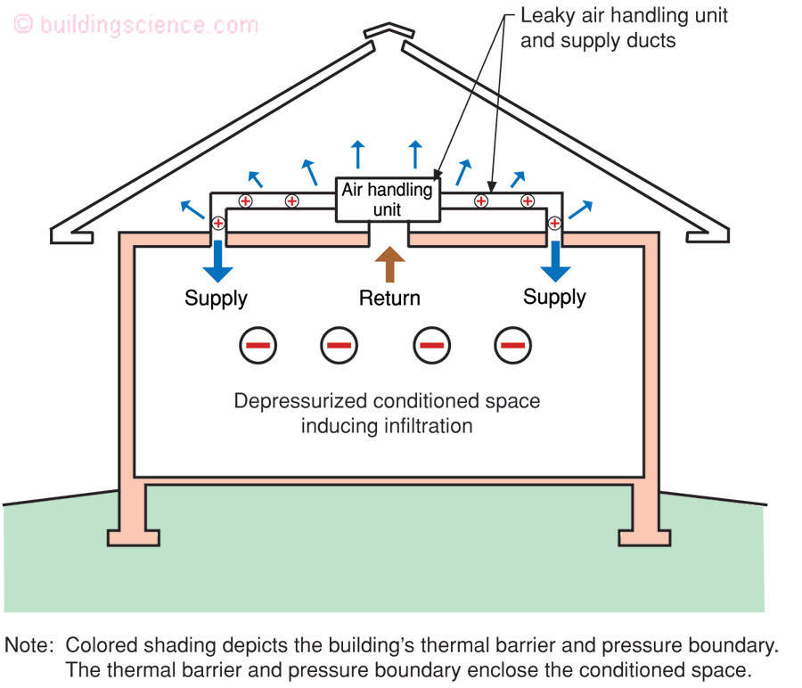

Also, as noted earlier, vented roofs are energy inefficient compared to unvented roofs.  This is particularly the case where ductwork and mechanical systems are located in vented attics.  Ductwork leaks and leads to negative air pressures, energy costs and part load moisture problems (Figure 1).  An unvented conditioned roof solves this problem (Figure 2).
Figure 1: Vented Roofs - Vented roofs are energy inefficient compared to unvented roofs.  This is particularly the case where ductwork and mechanical systems are located in vented attics.  Ductwork leaks and leads to negative air pressures, energy costs and part load moisture problems.
