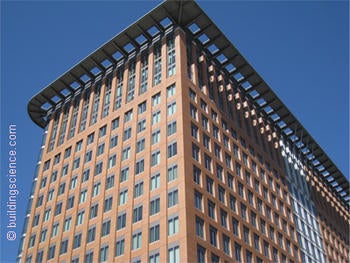

The third measure, visible transmittance (VT), reports the percentage of visible light transmitted through the glazing. A typical clear, double-glazed window will have a VT of 0.60, meaning it admits 60% of the visible light. When daylight in a space is desirable, as in showrooms, high VT glazing is a logical choice. In offices and classrooms, where glare is a real issue, mid-range VT may be specified for large glazing areas, or high VT for small glazing areas. Low VT glazings such as bronze, gray, or reflective-film windows were often used in office buildings of the past as they also reduced solar heat gain. Modern spectrally selective (SS) windows allow for both a high VT with a low SHGC (and always have a lower U-value than uncoated glass). These SS windows reduce allow for significant daylighting and psychological benefits while avoiding overheating during sunny days.
In the end, glazing is a classic design problem that requires one to balance the desire for thermal comfort, energy efficiency, and light quality (all of which require small window areas) with equally important desires for view, daylight, and connectivity with the outdoors (all of which benefit from large vision-glass areas). Less window / curtainwall area, and higher system performance is the low-cost, high performance prescription for buildings suffering from excessive glazing area. Carefully choosing, and then specifying, overall system U-value, SHGC, and VT is the best start to delivering high performance glazing on your next project.
Many designers have shown that beautiful and high-performance buildings can result from a proper balance of glazing quantity and quality. All too often, however, designers appear to choose all-glass curtain walls or floor-to-ceiling strip windows because they make it easy to create a sleek impression while leaving all the tricky details in the hands of the manufacturers. How much longer can we afford to pay the energy bills that result from that choice? It’s high time to revive the craft of designing beautiful facades that don’t cost the earth.
Photograph 4: A modern office building with a near-optimal window-to-wall area for energy and daylight performance in Boston, MA
