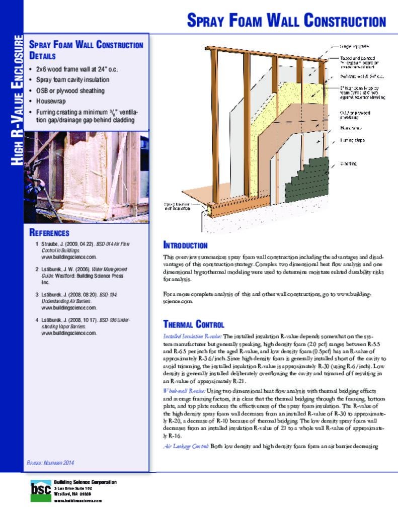

This overview summarizes spray foam wall construction including the advantages and disadvantages of this construction strategy. Complex two dimensional heat flow analysis and one dimensional hygrothermal modeling were used to determine moisture related durability risks for analysis.
  • Cladding
  • Furring strips creating a minimum 3/8" ventilation gap/ drainage behing cladding
  • Housewrap
  • OSB or plywood sheathing
  • 2x6 wood frame wall at 24" o.c. with 5" high-density spray foam cavity insulation
  • Interior gypsum wall board

Installed insulation R-value: The installed insulation R-value depends somewhat on the system manufacturer but generally speaking, high density foam (2.0 pcf) ranges between R-5.5 and R-6.5 per inch for the aged R-value, and low density foam (0.5pcf) has an R-value of approximately R-3.6/inch. Since high density foam is generally installed short of the cavity to avoid trimming, the installed insulation R-value is approximately R-30 (using R-6/inch). Low density is generally installed deliberately overflowing the cavity and trimmed off resulting in an R-value of approximately R-21.
Whole-wall R-value: Using two dimensional heat flow analysis with thermal bridging effects and average framing factors, it is clear that the thermal bridging through the framing, bottom plate, and top plate reduces the effectiveness of the spray foam insulation. The R-value of the high density spray foam wall decreases from an installed R-value of R-30 to approximately R-20, a decrease of R-10 because of thermal bridging. The low density spray foam wall decreases from an installed insulation R-value of 21 to a whole wall R-value of approximately R-16.
