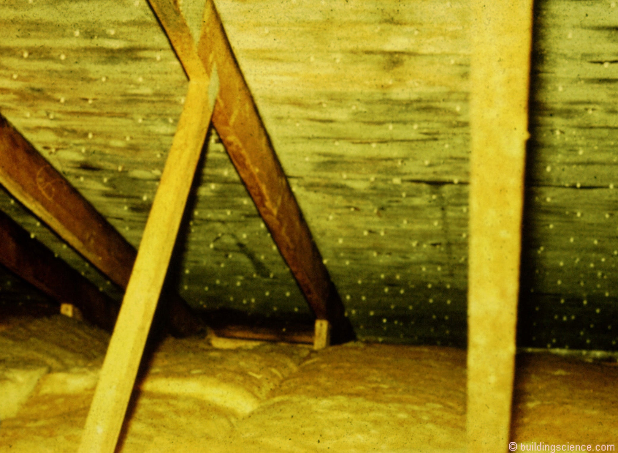

So what was the problem?  Ah, the insulation worked and reduced energy flow.  Drying requires an energy exchange.  We blew a lot of insulation into attics and into walls and that reduced drying potentials.  Attics would get wet from air leakage from the house below.  That moisture would be removed by attic ventilation in the old days.  The air outside was cold but when it moved into a poorly insulated attic the escaping heat would warm up that cold dry air and give it the capacity to pick up moisture and keep the attic dry.  With lots of insulation the attics stayed wet because there was insufficient heat loss from the house below to dry out the attic.  Yup attics rotted (Photograph 1).
BSI-151 Photograph 1
 Photograph 1:  Attic rot in a Canadian attic – thank you CHIP

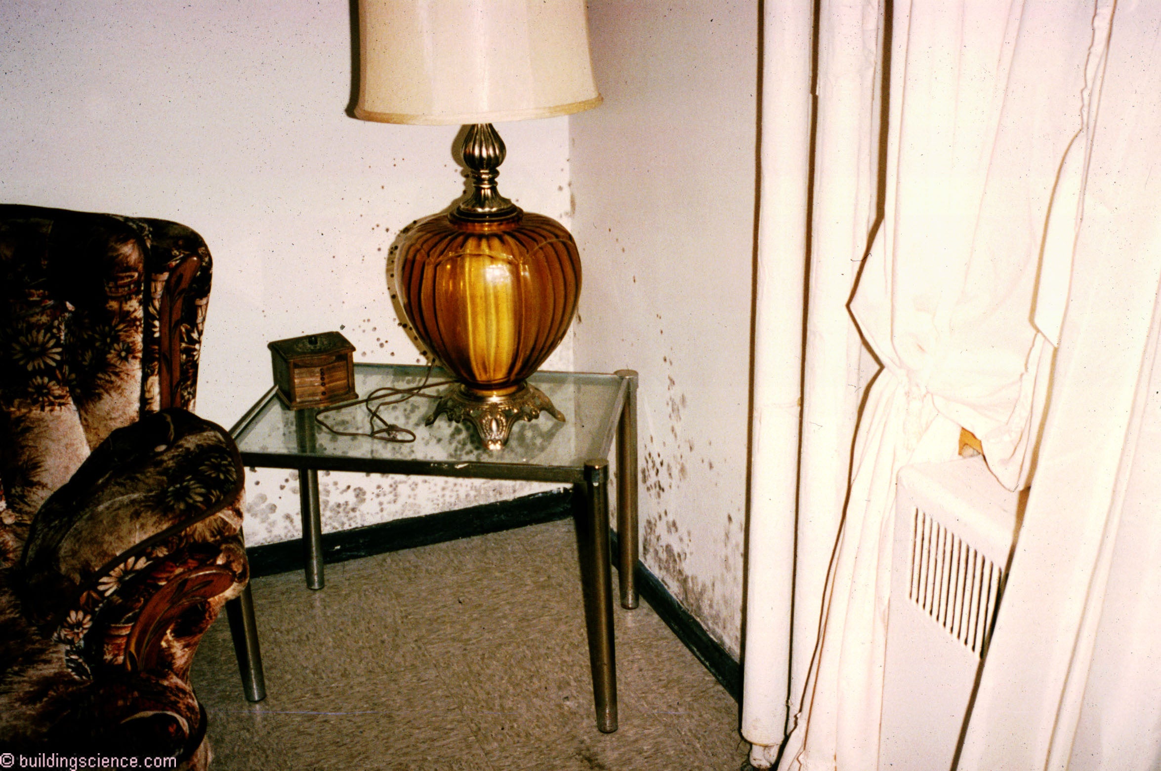

So what to do?  Air seal the attic floor to keep the house moisture from getting into the attic.  It worked….but…the air sealing made the occupied part of the house wetter and we got interior surface mold if we were lucky (Photograph 2).  If we were unlucky the oil and gas furnace chimneys would not work and we would get spillage and back drafting of products of combustion and folks would get sick and a bunch died.  The problem was made worse by replacing oil furnaces with gas furnaces and connecting them to the existing chimneys designed for oil furnaces.  The venting of products of combustion was made worse…condensation would occur in the chimney flues and sometimes even freeze over.
BSI-151 Photograph 2
Photograph 2:  Interior surface mold in a Canadian home – thank you CHIP and COSP

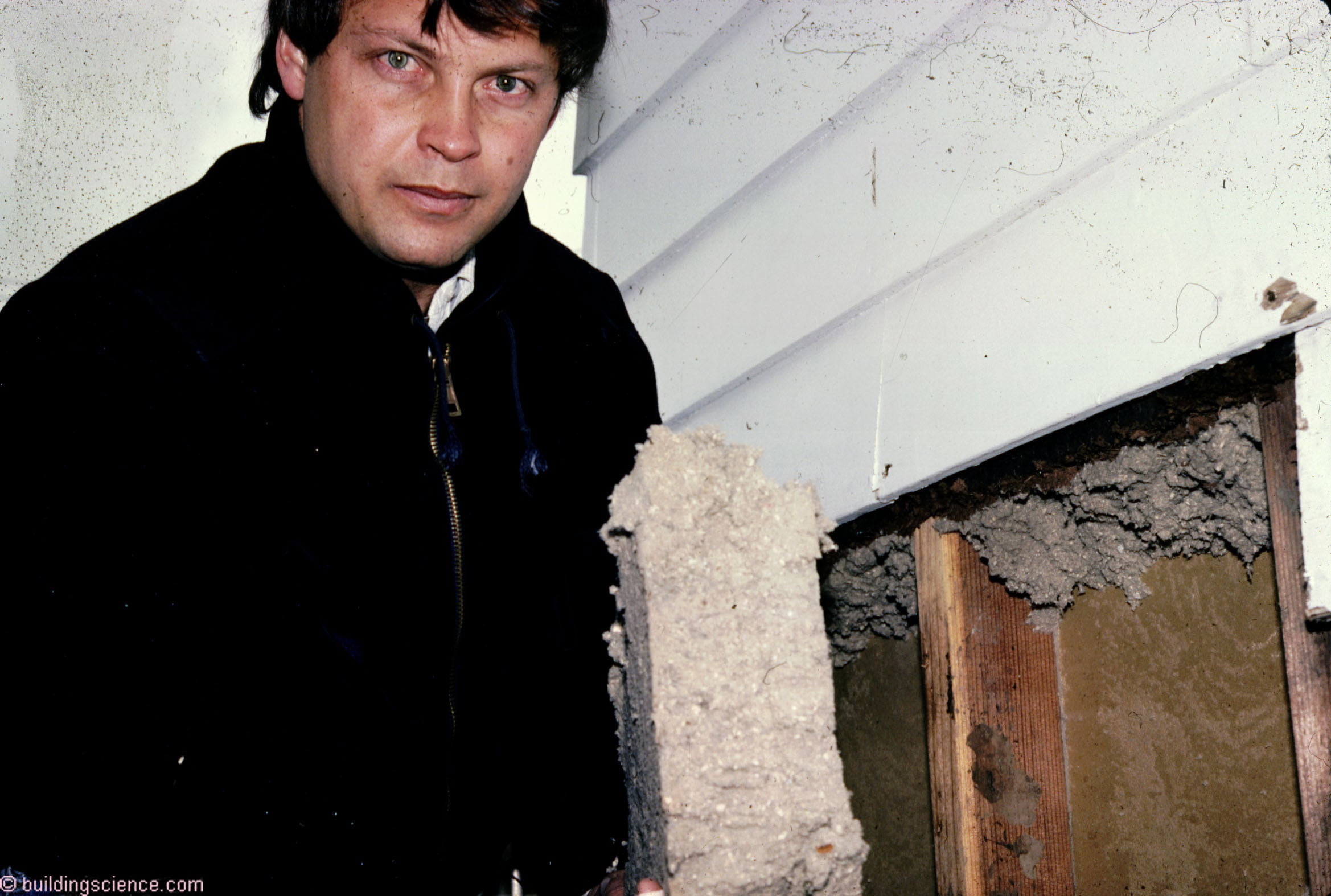

It got worse….we also insulated walls that were previously uninsulated (Photograph 3)….and caused the walls to rot and paint to fail (Photograph 4).
BSI-151 Photograph 3
Photograph 3: Retrofit wall insulation -thank you CHIP…that is what I looked like when I was 28…

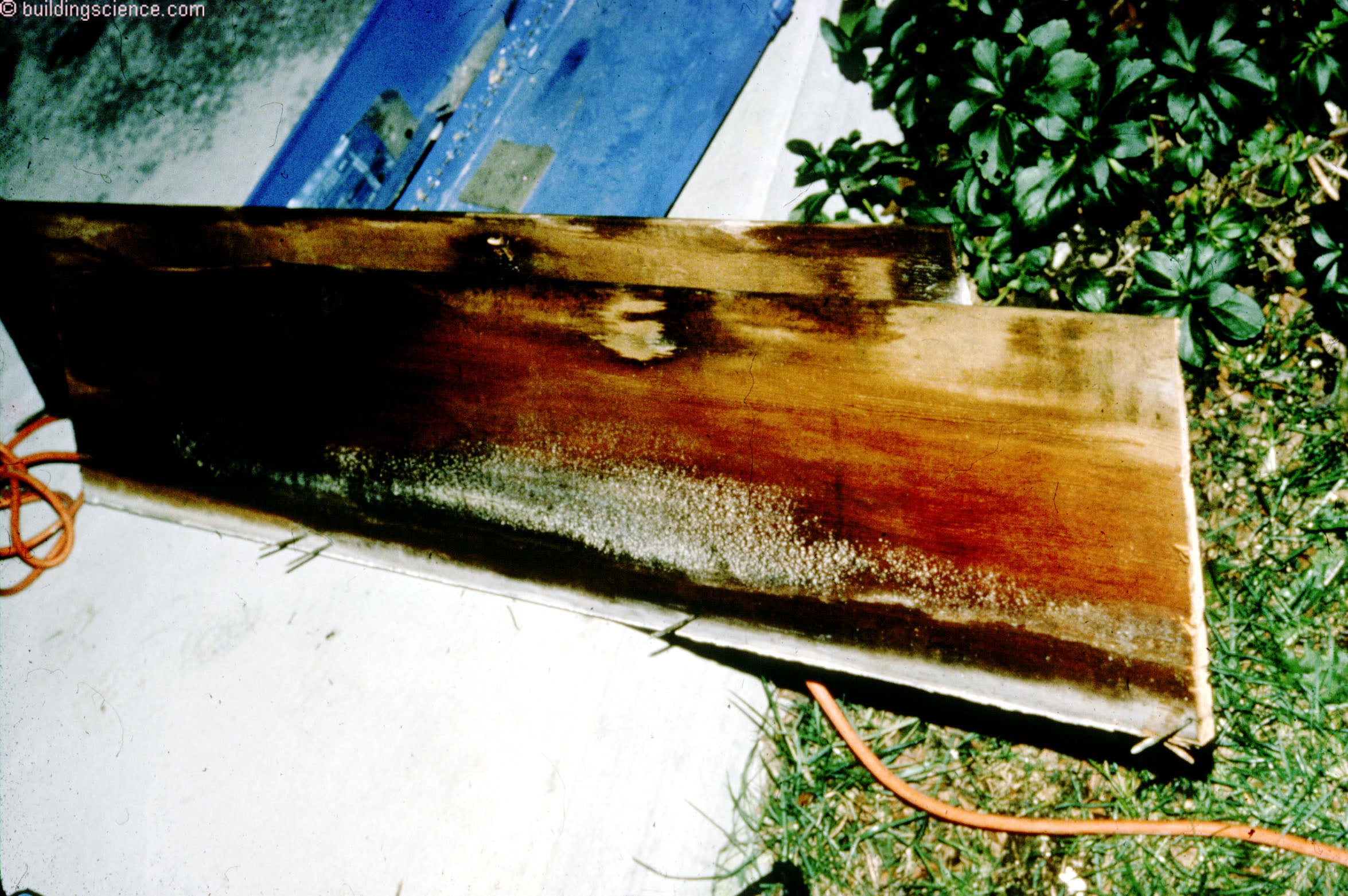

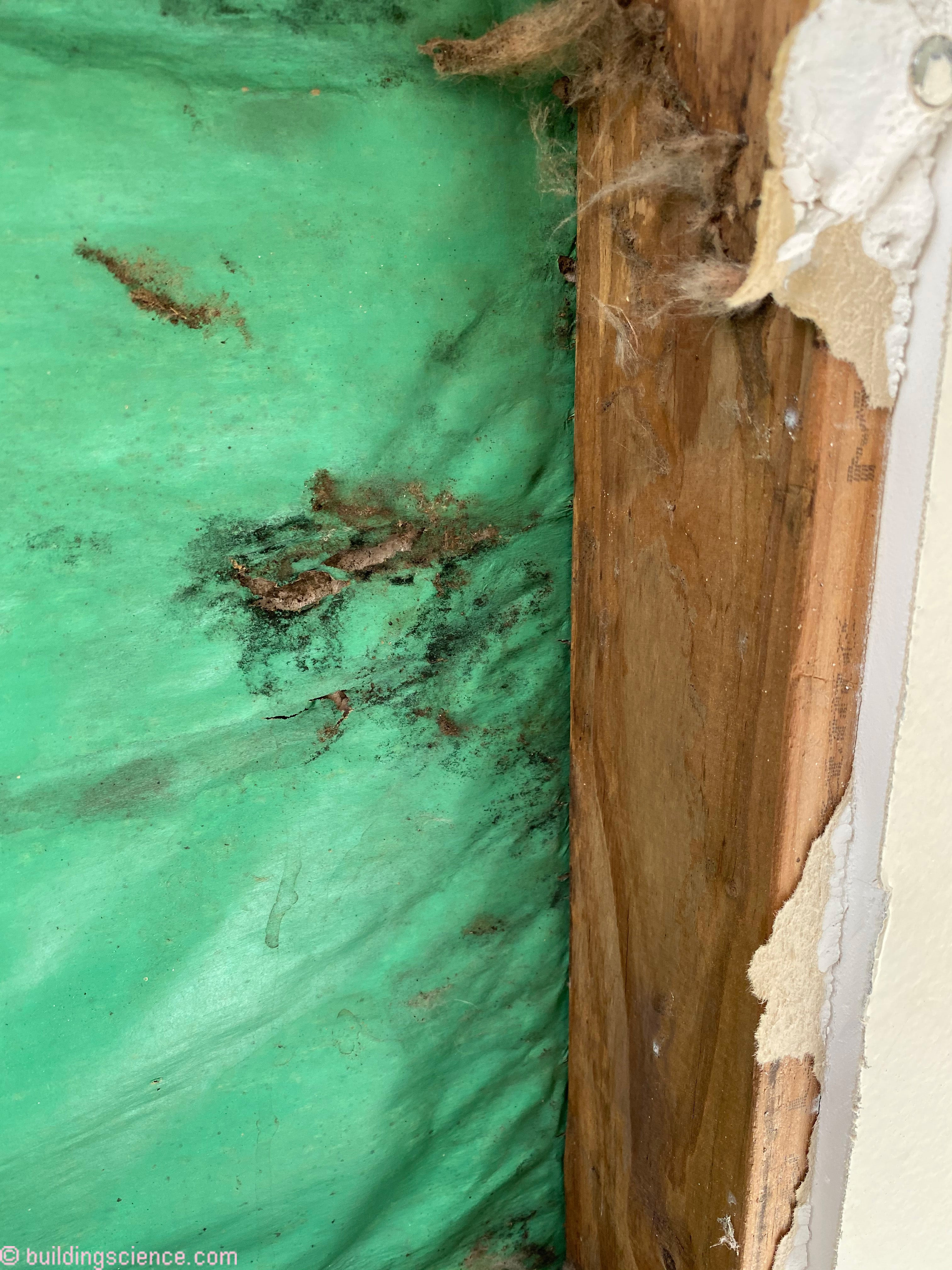

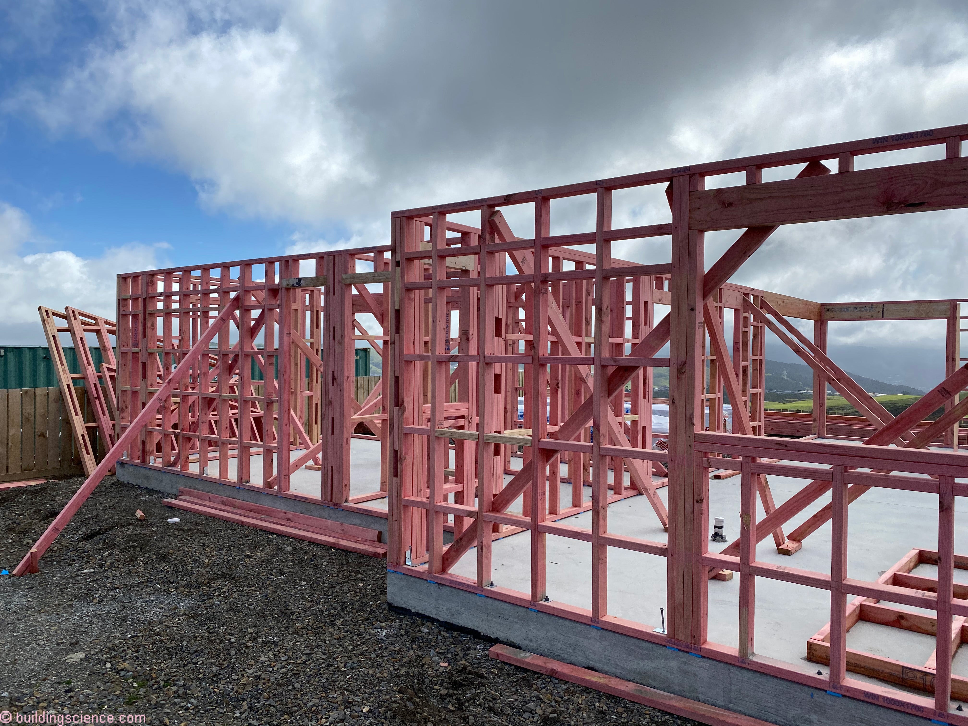

It gets worse….of course it does…the New Zealander’s have gone from using old growth wood to using plantation grown wood….  It worked at first because the plantation grown wood was treated to control decay (Photograph 5)…but you know where this is going…due to pressure from….I will be polite here….folks who did not like the treatment…wood stopped being treated.  It got worse…of course it did…adding wall cavity insulation reduced the drying potential.  There was no way untreated plantation grown wood stood a chance in an insulated wall or roof.  And more…the drying potential of the exterior claddings also was reduced and lead to decay and mold (Photograph 6).
BSI-151 Photograph 5
Photograph 5:  New Zealand treated plantation grown wood worked just fine
BSI-151 Photograph 6
Photograph 6:  The drying potential of the exterior claddings was reduced and lead to decay and mold

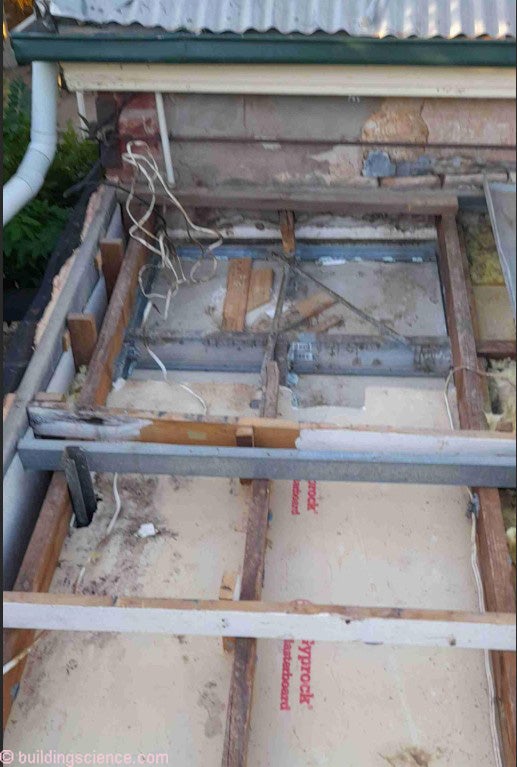

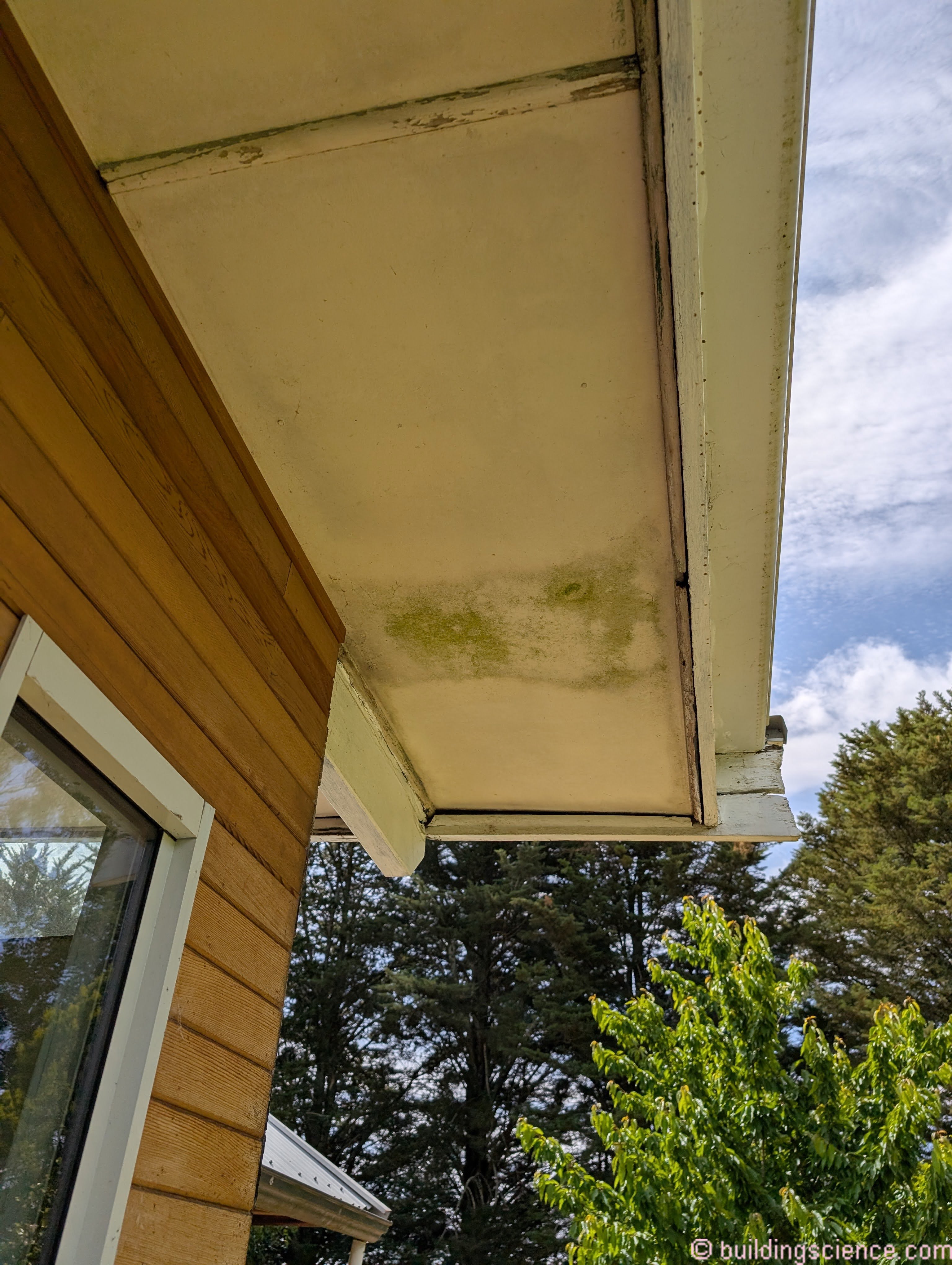

In Australia, not ever wanting to be second to New Zealand in anything, roofs have become a mess.  Yup, insulating Australian roofs reduces drying potentials…Canada and the US exported the rot technology across the Pacific (Photograph 7, 8 and 9).
BSI-151 Photograph 7
Photograph 7:  Insulated deteriorating Australian roof (photo Courtesy Jessica Allen, Climasure, Australia)

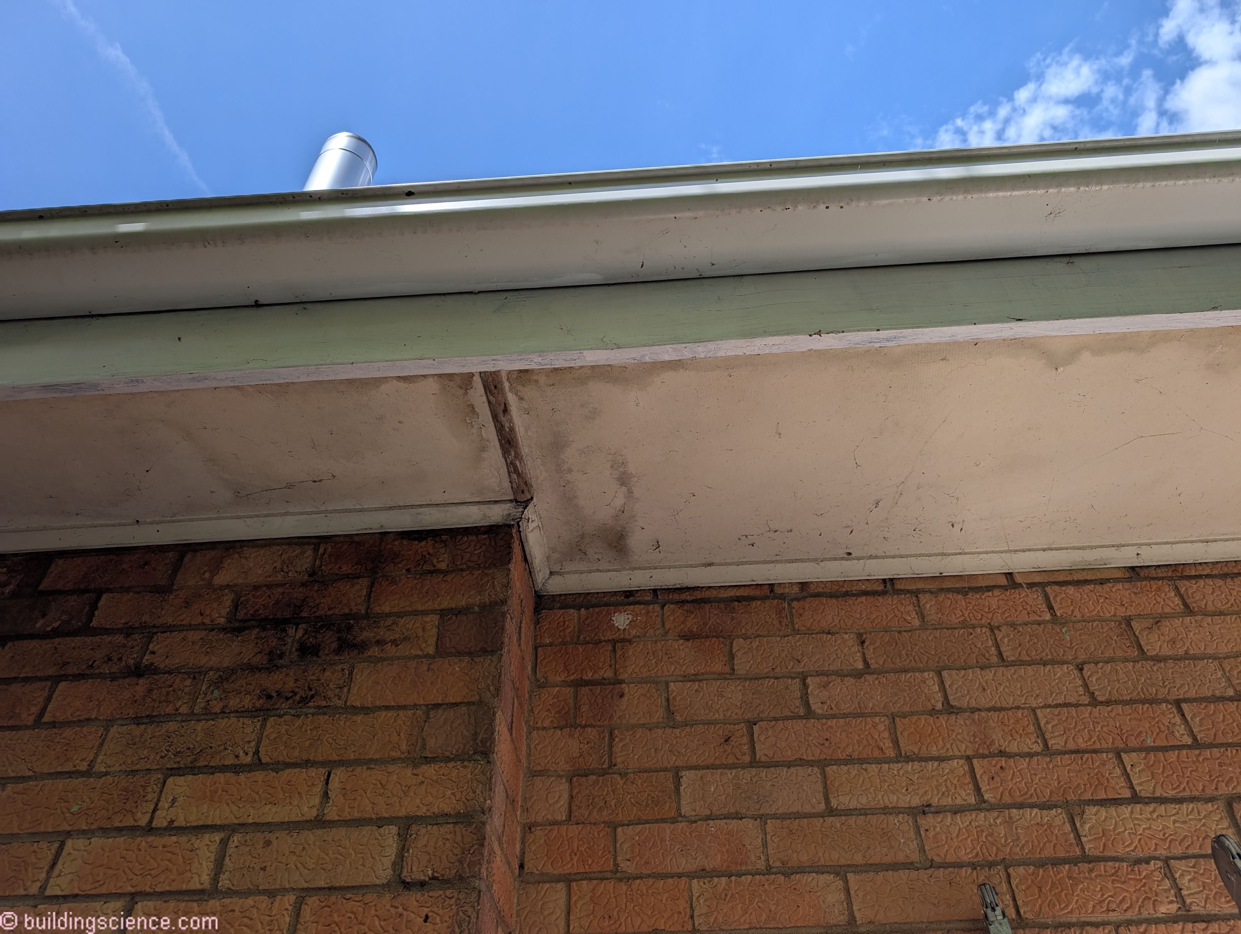

Photograph 8:  Soffit condensation damage (photo Courtesy Jessica Allen, Climasure, Australia)
BSI-151 Photograph 9
Photograph 9:  More soffit condensation damage (photo Courtesy Jessica Allen, Climasure, Australia)
