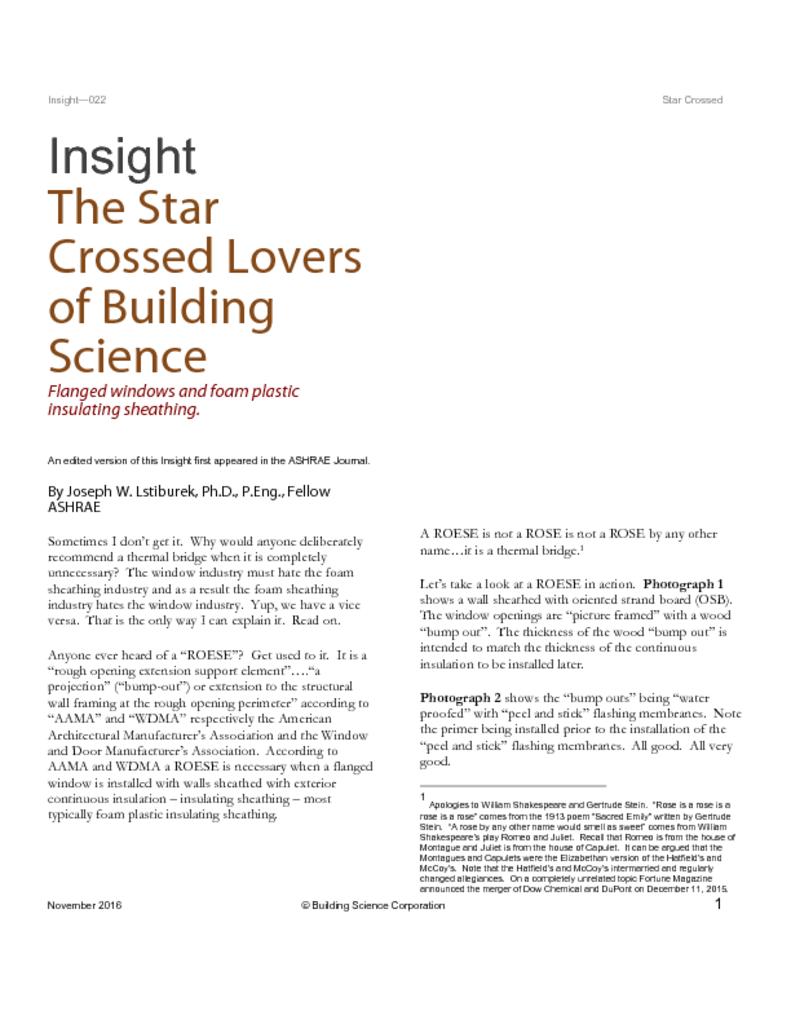

Flanged windows and foam plastic insulating sheathing.
Sometimes I don’t get it. Why would anyone deliberately recommend a thermal bridge when it is completely unnecessary? The window industry must hate the foam sheathing industry and as a result the foam sheathing industry hates the window industry. Yup, we have a vice versa. That is the only way I can explain it. Read on.
Anyone ever heard of a “ROESE”? Get used to it. It is a “rough opening extension support element”….“a projection” (“bump-out”) or extension to the structural wall framing at the rough opening perimeter” according to “AAMA” and “WDMA” respectively the American Architectural Manufacturer’s Association and the Window and Door Manufacturer’s Association. According to AAMA and WDMA a ROESE is necessary when a flanged window is installed with walls sheathed with exterior continuous insulation – insulating sheathing – most typically foam plastic insulating sheathing.
A ROESE is not a ROSE is not a ROSE by any other name…it is a thermal bridge.[1]
