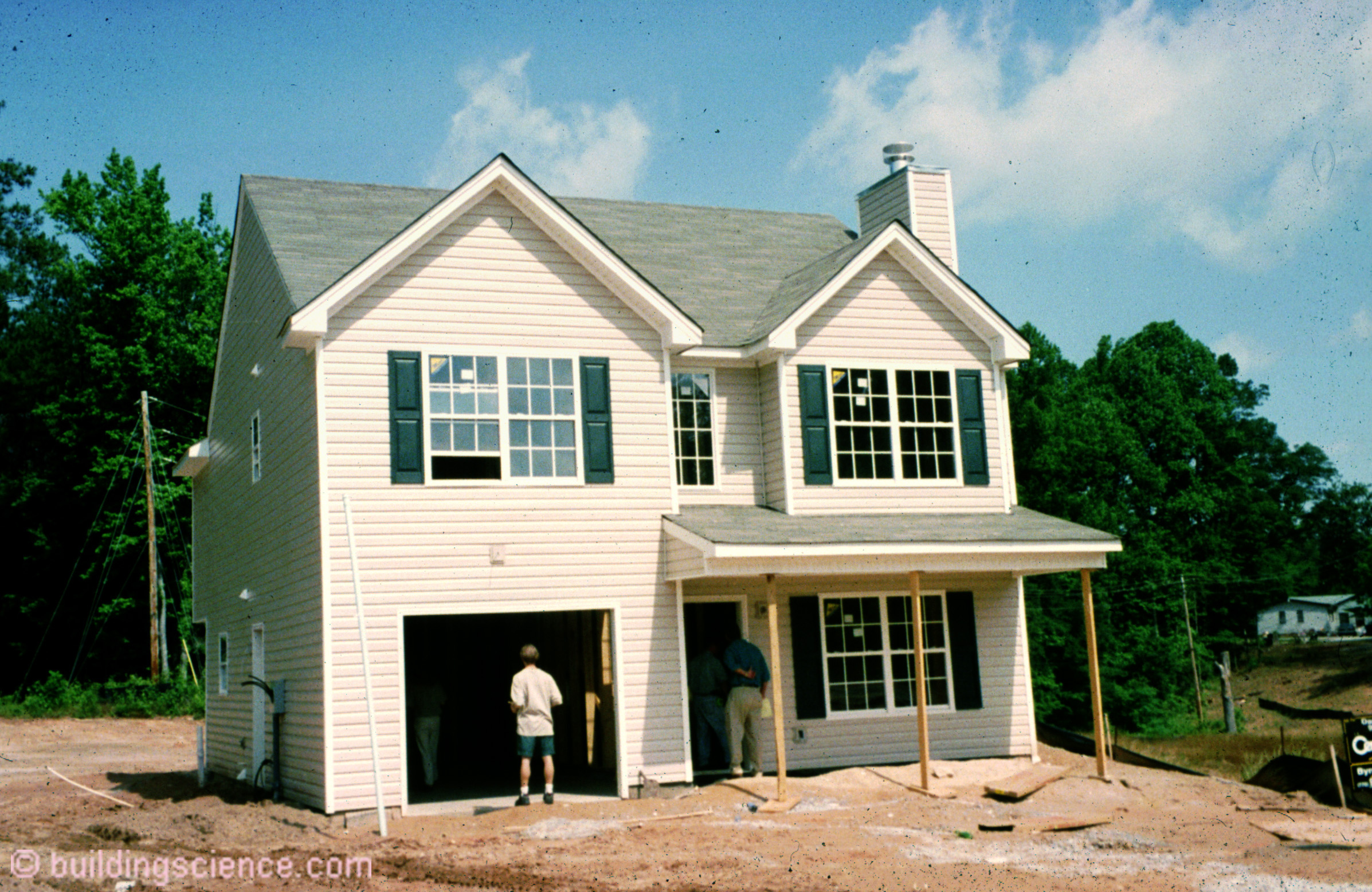

Garages were once easy to deal with. Their function was to store a vehicle. Not anymore. Garage space is becoming too valuable for just vehicle storage. They are becoming part of the house and often end up being conditioned. They also often end up being lived in.
We have learned that garages should be thermally isolated from the interior occupied space regardless of whether they are unheated, minimally heated or fully heated. Folks often turn off heating systems to save energy. Heated garages obviously should be insulated.
I am going to get into trouble with this next comment…unheated garages obviously should be insulated because over time they become part of the conditioned space…and wait for it…heated.

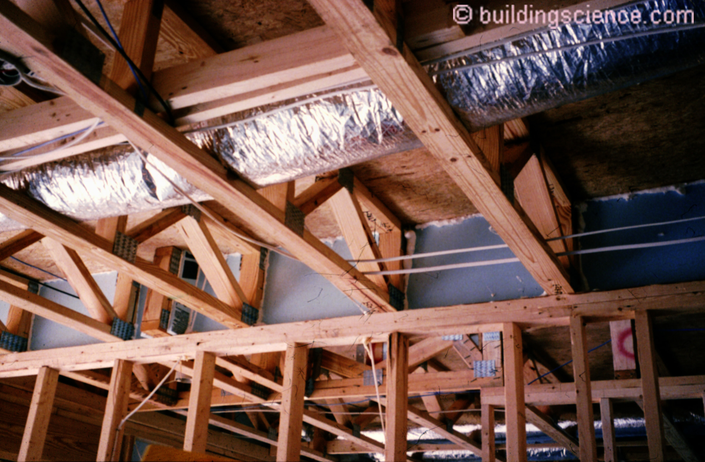

Garages are often “tucked in” to houses typically with living space/conditioned space above the garages (Photograph 1) the garages need to be effectively thermally isolated from interior occupied spaces if garages are intended to be unheated, minimally heated or fully heated.
Photograph 1: Garages are often “tucked in” to houses typically with living space/conditioned space above the garage

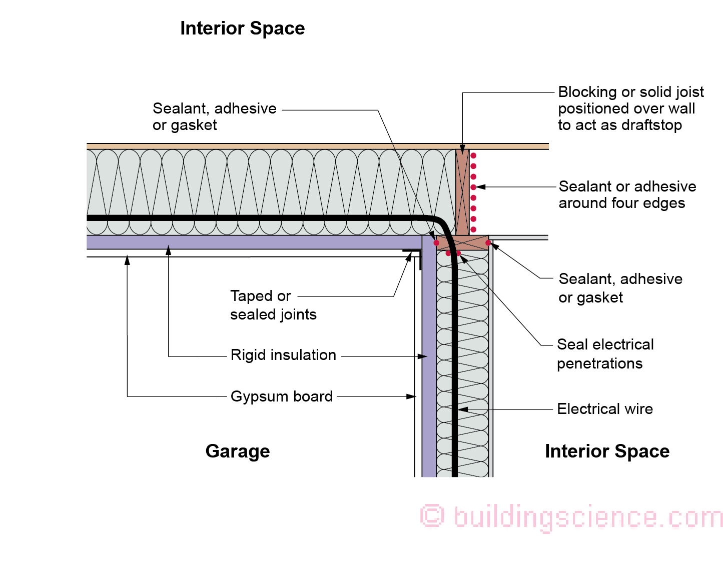

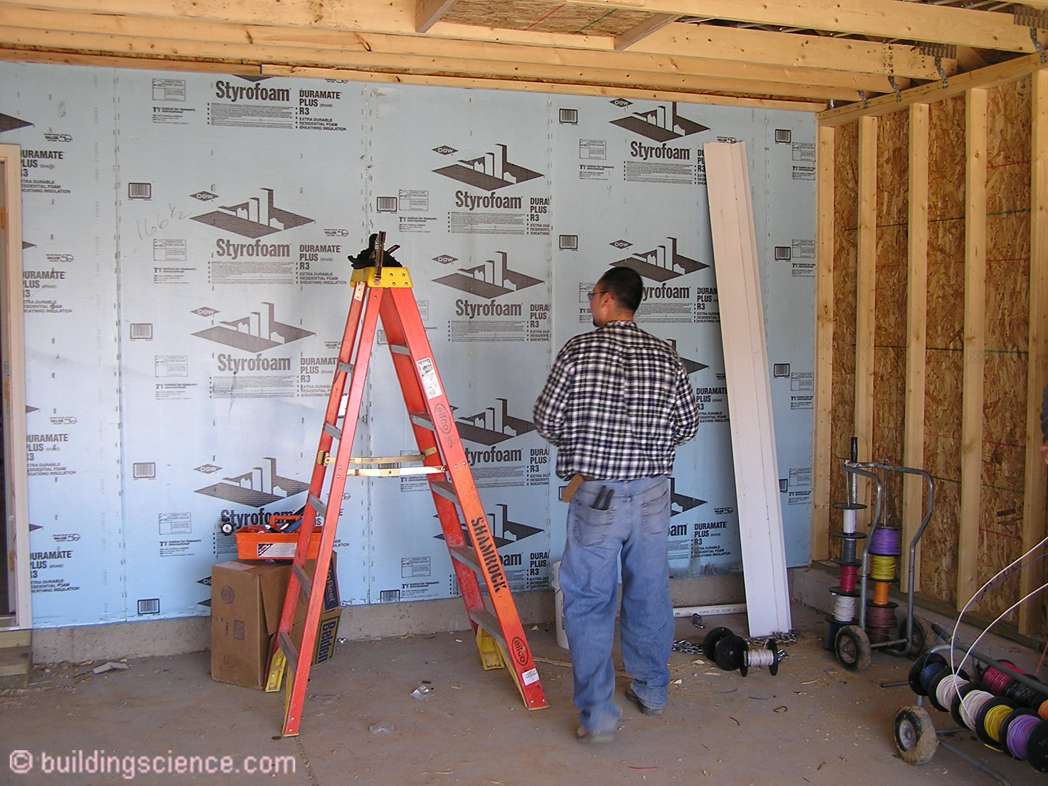

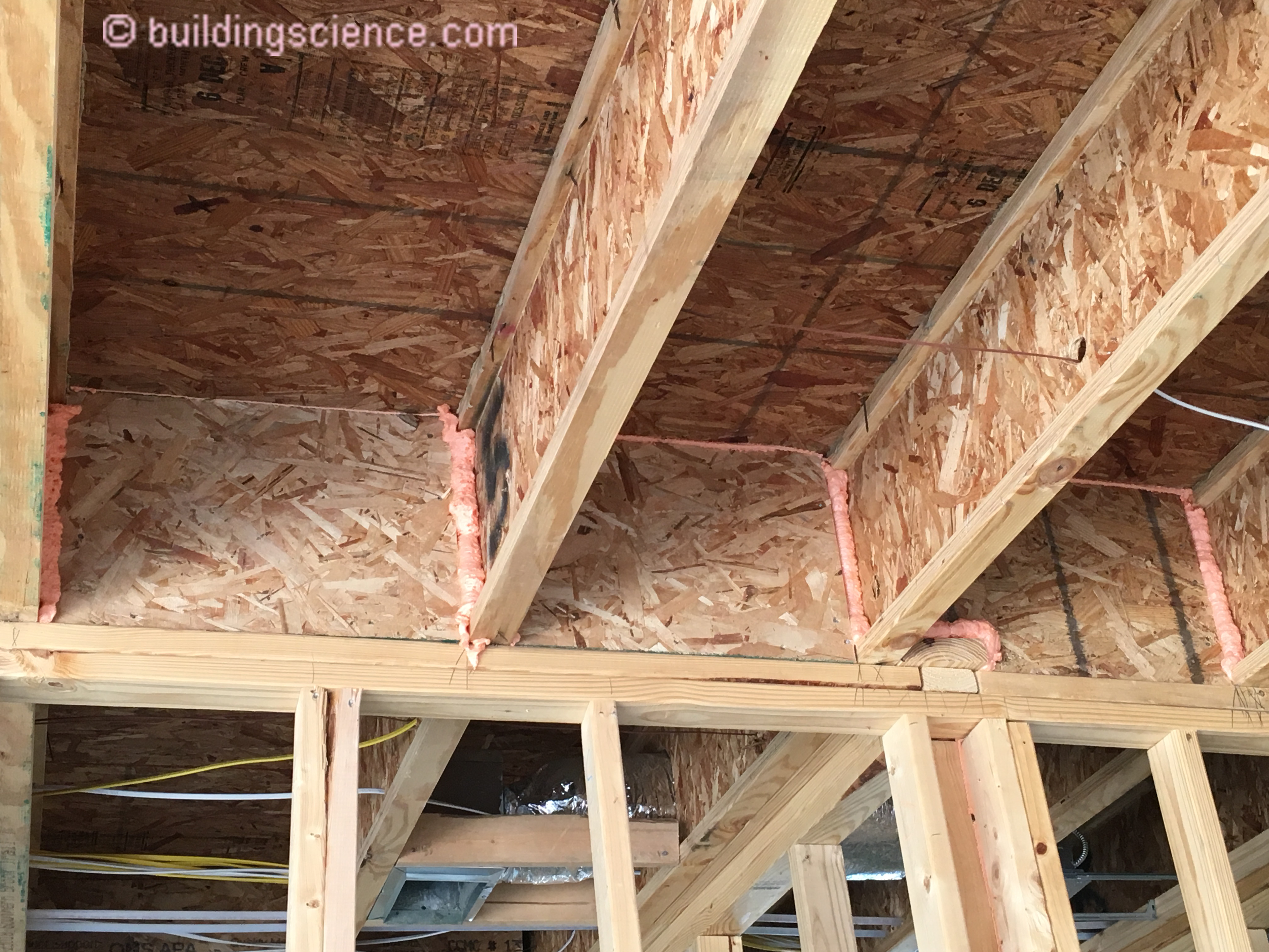

Figure 1 illustrates the use of rigid insulation and wood blocking for air sealing to provide thermal isolation between the occupied space and the garage. Photograph 2 illustrates the use of rigid insulating sheathing on the wall separating the house from the garage. Note that the rigid insulation assembly will need to meet applicable fire rating requirements. Photograph 3 illustrates the use of OSB blocking that is notched around wood I-joist floor framing. Photograph 4 illustrates the use of gypsum board blocking with a floor truss assembly. Note the location of a vertical member within the floor truss to simplify the installation of the truss gypsum board air sealing blocking.
Figure 1: Rigid insulation and wood blocking for air sealing to provide thermal isolation between the occupied space and the garage.
Photograph 2: Rigid insulating sheathing installed on the wall separating the house from the garage. Note that the rigid insulation assembly will need to meet applicable fire rating requirements
Photograph 3: OSB blocking that is notched and sealed around wood I-joist floor framing.

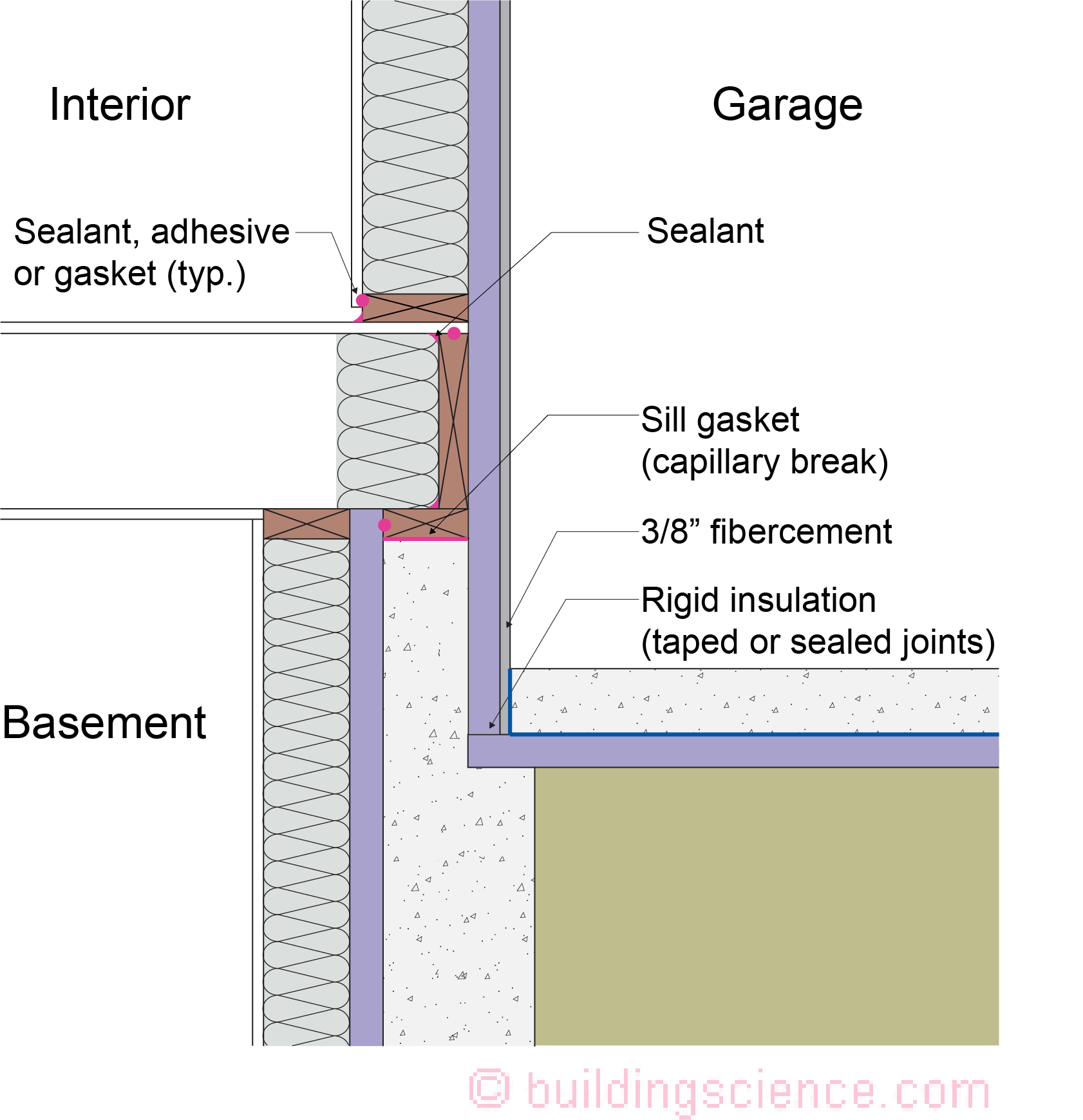

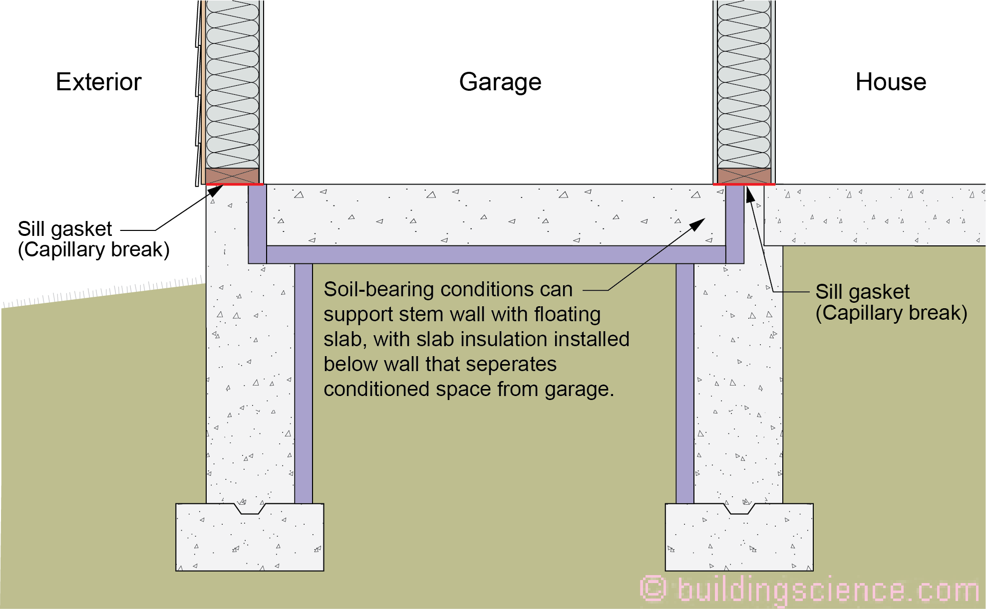

Where basement foundations are common effective thermal isolation is illustrated in Figure 2. Note that where insulated walls intersect garage slabs fiber cement is often used to provide physical protection of the rigid insulation rather than gypsum board. Where slab foundations are common effective thermal isolation is illustrated in Figure 3.
Figure 2: Basement foundation – attached garage thermal isolation.
Figure 3: Slab foundation slab foundation thermal isolation.

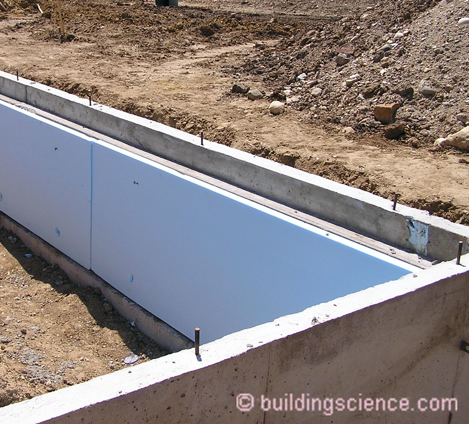

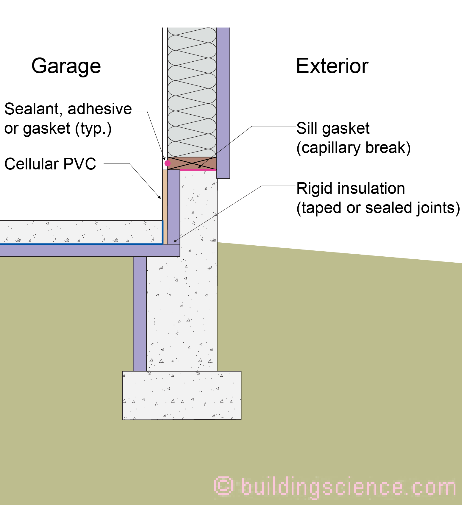

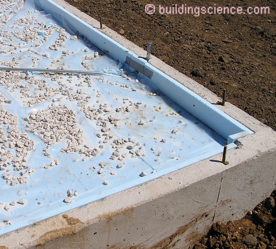

Figure 4, Photograph 5 and Photograph 6 illustrate the insulation detail at the stem wall portion of the garage foundation.
Figure 4: Stem wall garage foundation insulation.
Photograph 5: Insulation detail at the stem wall portion of the garage foundation.
Photograph 6: Insulation detail at the stem wall portion of the garage foundation.

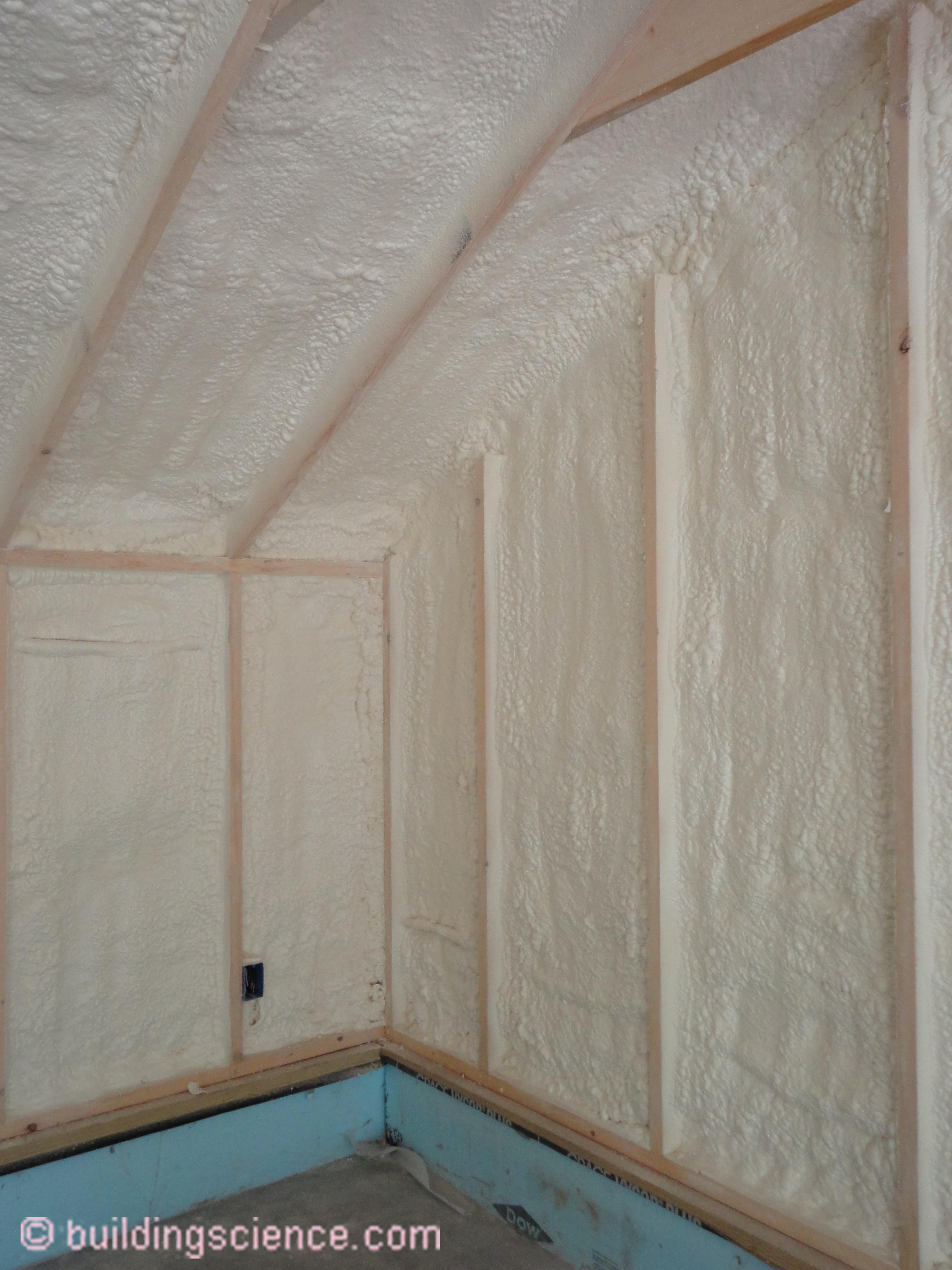

Photograph 7 illustrates the use of spray foam cavity insulation on the walls separating the garage from the exterior. Again, note that the wall assembly will need to meet the applicable fire rating requirements.
Photograph 7: Spray foam cavity insulation on the walls separating the garage from the exterior. Again, note that the wall assembly will need to meet the applicable fire rating requirements.

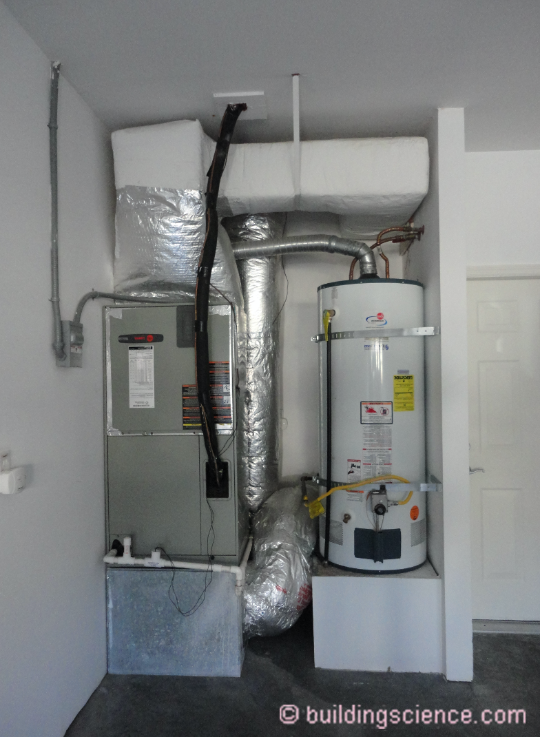

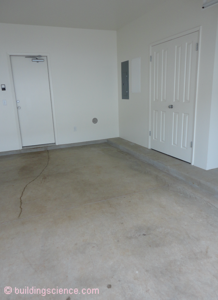

OK, more “danger…Will Robinson….danger” stuff. Mechanical air distribution systems (forced air furnaces/AC units) and associated ductwork should not be installed in attached garages (Photograph 8) due to the potential risk for air leakage of such systems drawing air from garages into occupied unit spaces4 unless such systems are located within “air-sealed” rooms (Photograph 9) that are connected to the occupied space.
Photograph 8: Mechanical air distribution systems (forced air furnaces/AC units) and associated ductwork should not be installed in attached garages due to the potential risk for air leakage of such systems drawing air from garages into occupied unit spaces
Photograph 9: Mechanical systems should be located within “air-sealed” rooms that are connected to the occupied space. Note the automatic door closer for the door to the occupied unit. Airtight door sweeps and weatherstripping are necessary.
