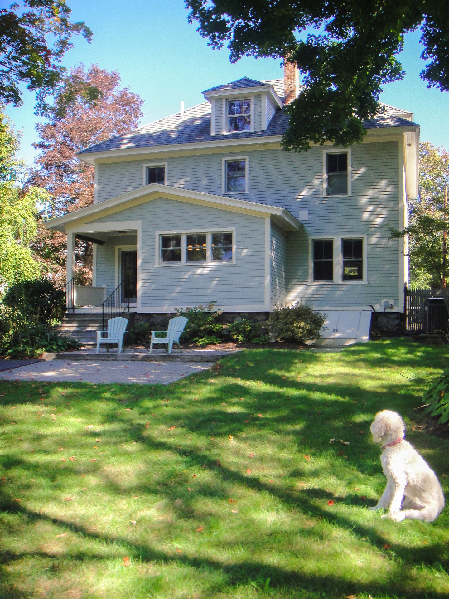

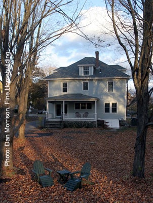

Rear exterior of home after renovation

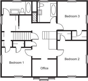

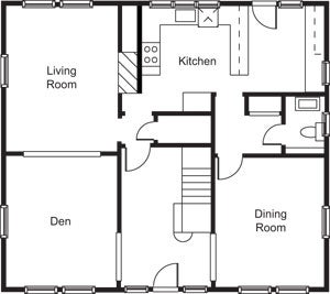

First (top) and second (bottom) floor plans

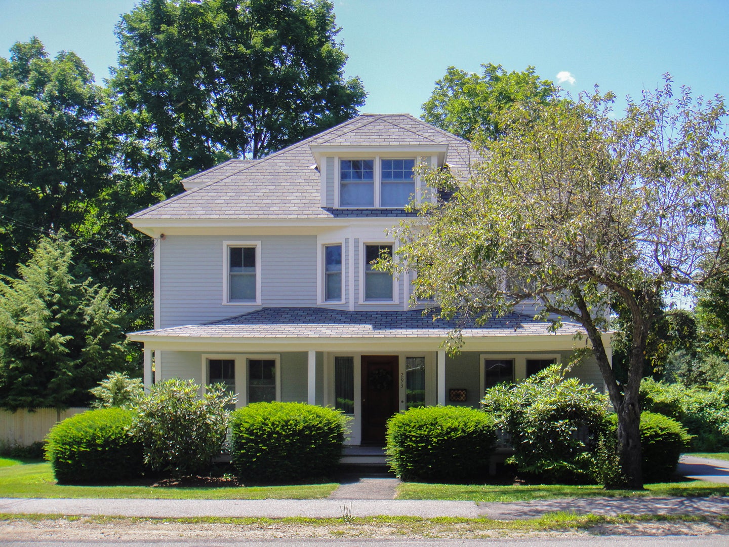

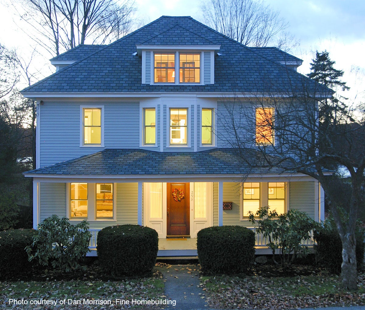

- Large overhangs with crown molding to accommodate additional exterior foam
- Front porch
- Maintenance-free fiber cement siding and trim
