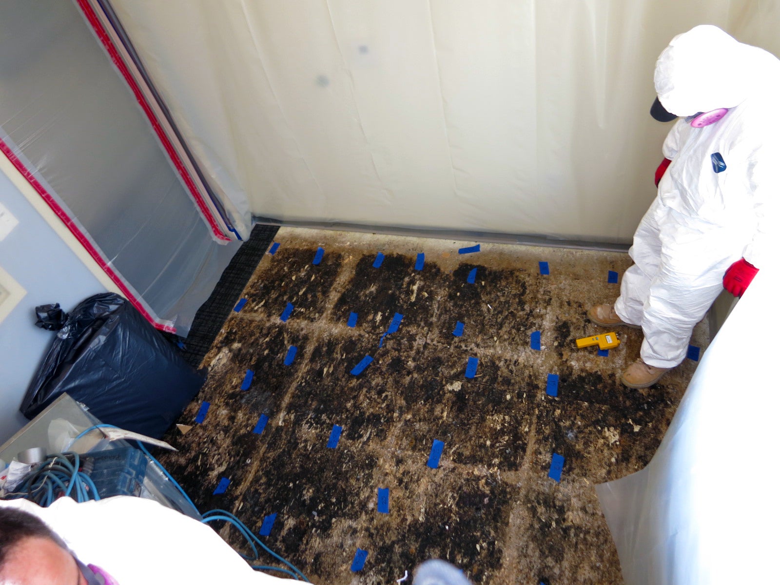

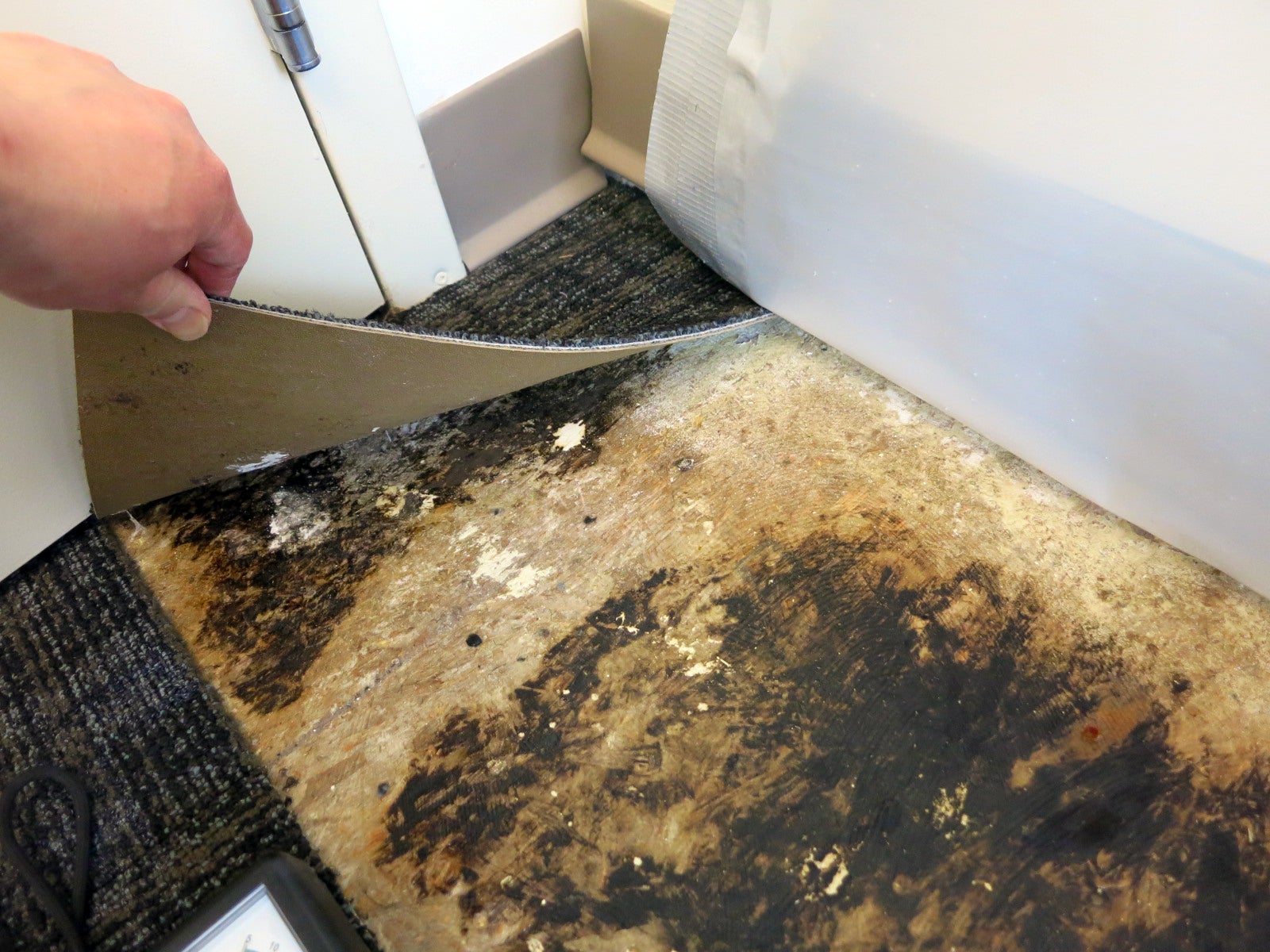

The finish floor is rubber-backed carpet tile, adhered to the OSB subfloor; removing the carpet tile revealed black staining at problem areas. The same subfloor and carpet were used over the basement, which had no moisture problems or black staining. Demolition of an office revealed the black patterns match the carpet tile layout.

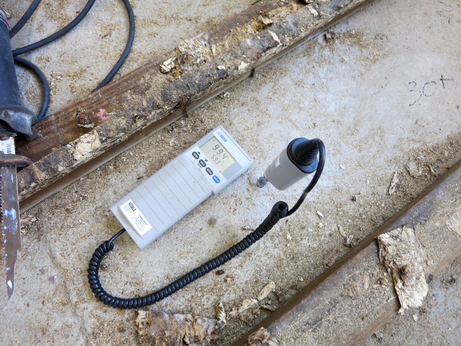

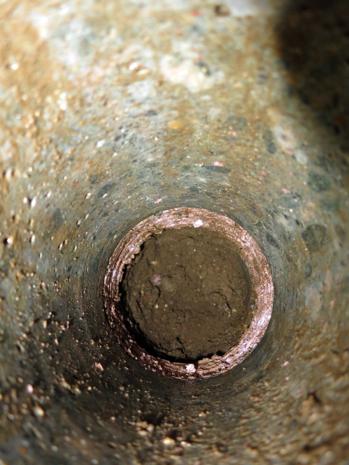

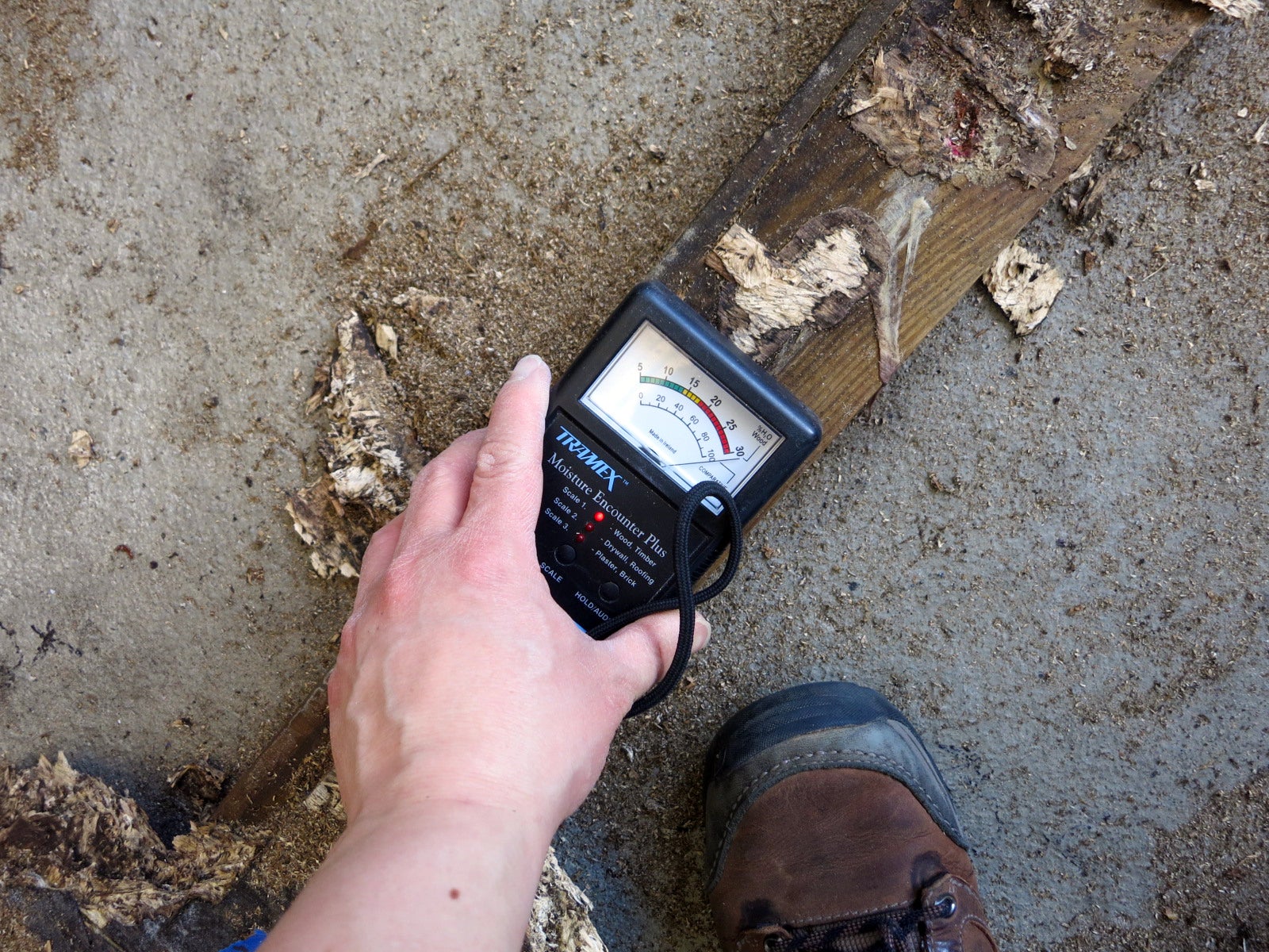

Demolition of the floor revealed extensive damage and high wood moisture contents in the subfloor and horizontal lumber sleepers on the slab. Measurement of slab relative humidity levels (field expedient version of ASTM F2170–11) revealed significant construction moisture retained in the slab (~100% conditions).

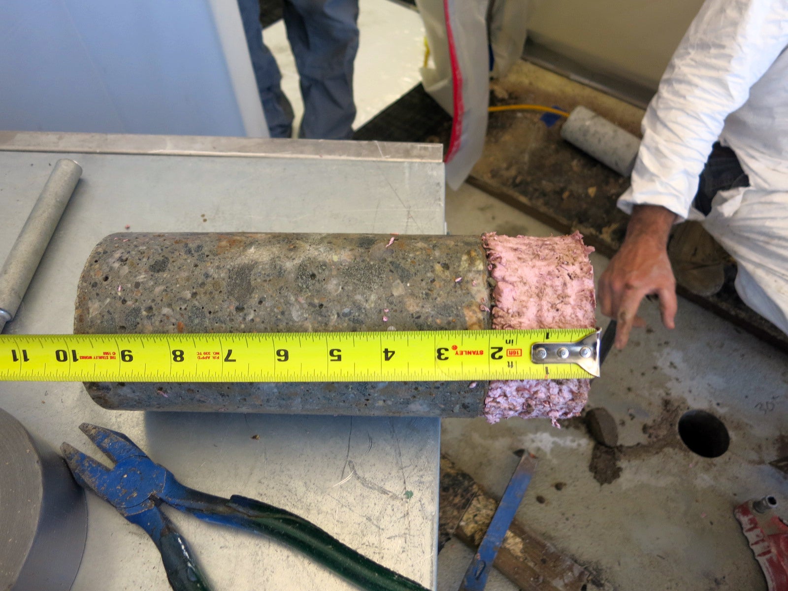

Coring of the slab was used to ascertain construction; the worst problem areas had an 8” thick structural slab. However, problems still occurred at thinner (4”) portions of the slab.
The problem was caused by moisture of construction in the concrete slab and the design of the sleeper and subfloor system. The rubber-backed carpet tiles are vapor impermeable (i.e., a “vapor barrier”), trapping moisture within the assembly. This moisture accumulated in the subfloor and sleepers, resulting in the rot damage. The assembly was built contrary to the subfloor manufacturer’s directions, which call for a polyethylene vapor barrier on top of the slab, below the sleepers.
