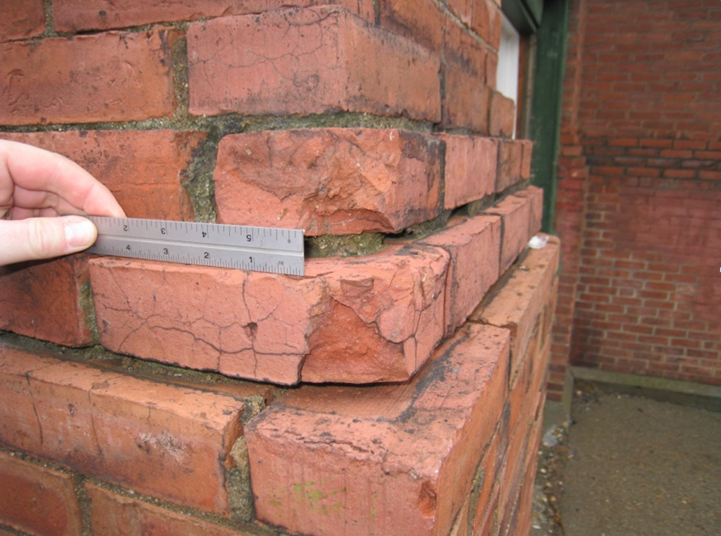

masonry-retrofit-bricks-and-ruler
Evidence of Freeze-thaw Damage
Freeze-thaw damage is a concern when adding insulation to the inside of masonry walls. When masonry walls are too wet during freezing spells, freeze-thaw damage can occur; insulation on the inside raises this risk by making masonry colder and less able to dry. However, careful assessment can help building owners manage risk and make informed decisions about whether and how to retrofit.

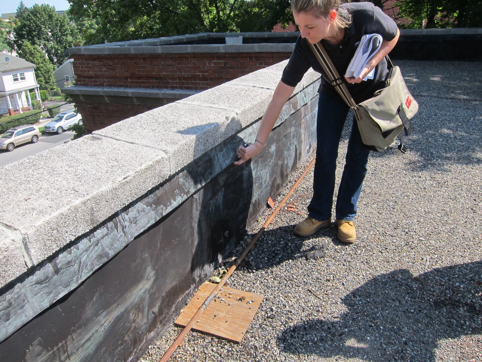

masonry-retrofit-site-visit-long2
The Value of a Site Visit
Inspection by a building scientist should be the first step in a freeze-thaw damage risk assessment. Visual inspection, combined with interviews of those familiar with the building, can yield critical information – sometimes enough information to make further assessment unnecessary. For example, very high-risk or low-risk assemblies are sometimes clearly identifiable without material testing or hygrothermal modeling.

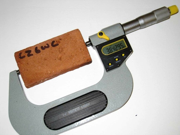

masonry-retrofit-measurement
Frost Dilatometry
This method of assessing the potential for freeze-thaw damage can help provide a realistic picture of possible risk. Frost dilatometry provides a measure of Scrit (the Critical Degree of Saturation) – in other words, the point of saturation that defines the onset of freeze-thaw damage. By estimating the typical degree of saturation for a building, and comparing it to Scrit, the risk of freeze-thaw damage can be predicted.

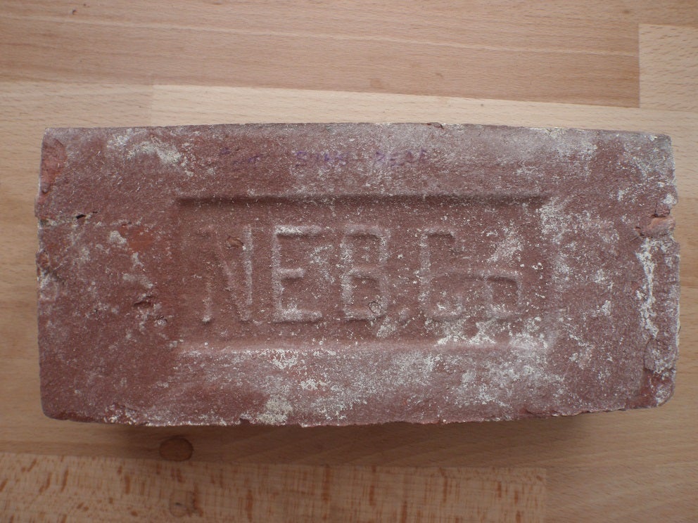

brick
Historic Brick Showing Damage
Traditionally, bricks have been treated as if they were fairly consistent in terms of freeze-thaw performance. However, BSC's research has shown a significant range in Scrit levels. Manufacturing methods have varied over time, even within a single factory; for historic buildings, understanding the particular brick used can be critical.

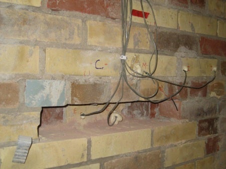

sensors rectangular
Field Monitoring Using Sensors
Wood “plug” sensors (relative humidity surrogates) are currently used (embedded in walls) for research purposes and in some historic retrofit projects. More research is needed to refine, improve, and evaluate sensor technology; the cost-effectiveness and capabilities of these sensors can be improved.
