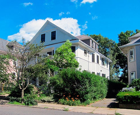

Location: Jamaica Plain, Massachusetts
Description: Comprehensive energy efficiency update of 1907 triple decker, 3,885 ft2 above-grade living space, 3-family residence with conditioned basement

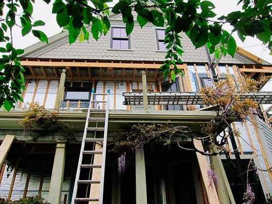

The retrofit strategy for the enclosure of the house was determined by the relative condition and accessibility of the different enclosure components. Since the siding was old and would require on-going maintenance, it was decided to replace it with fiber cement siding. With the siding being removed, it was possible to blow cellulose into the wall cavities from the outside, to apply insulating sheathing over the existing board sheathing, and to create a robust drainage plane behind the new siding.

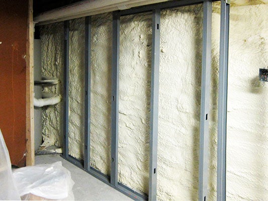

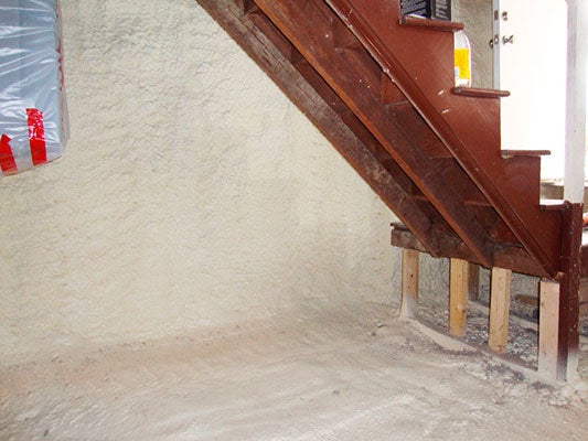

With the basement being used for mechanical equipment, laundry facilities, and storage space, insulation of the basement was included in the project. The approach taken was to apply closed-cell spray foam insulation directly over the existing walls and to place an insulated concrete slab over the existing slab.

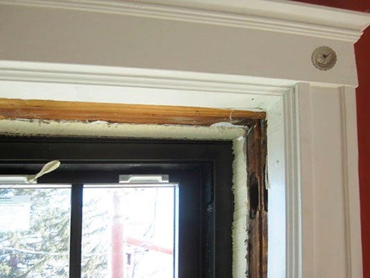

All windows were replaced with new construction “triple-glazed” windows. By installing the windows in the outer part of the retrofitted walls, they were easily integrated with the drainage plane and air barrier of the walls and installed without damaging the existing interior walls and trim.

Wall Assembly: R-40 (nominal): Fiber cement cladding installed over 1x4 vertical furring strips; two 2” layers of foil-faced polyisocyanurate insulating sheathing; housewrap applied over existing board sheathing; existing wall cavities filled with blown-in cellulose where needed.
Window Specifications: New construction windows–525 series fiberglass Serious Windows: U=0.22, SHGC=0.20; installed in alignment with surface of outer layer of insulating sheathing.

Foundation Assembly: Conditioned basement with 2” closed-cell spray foam applied directly to stone foundation walls and finished with a metal stud framed perimeter wall; 2” closed-cell spray foam applied directly over existing concrete slab and covered with new 11/2” concrete slab.*

The construction process for the above grade walls of the house was fairly straightforward since the contractor was experienced with the installation of exterior insulating sheathing and the detailing required for the outer layer to be a drainage plane and part of the air barrier. Although the roof and overhangs were not modified in this retrofit, there were places where special handling was required because the existing overhang was barely sufficient to cover the extra thickness of the retrofitted exterior wall.
To condition the basement, the contractor used a “bathtub” of spray foam created within the existing basement by applying the spray foam directly onto the existing walls and slab. The “bathtub” provides the thermal, air, water and vapor control layers for the basement. BSC recommended that XPS be used as the underslab insulation instead of spray foam and that a water management system be incorporated by placing a drainage mat under the insulation. However, given that the contractor had previous success using the “bathtub” approach, could do this method at a lower cost, and noted that there was no history of water in the basement, the contractor chose to use the spray foam “bathtub” approach.

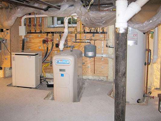

Combined Heating and Power: Retained existing FreeWatt hydronic system that includes a CHP power module that provides electricity for two of the units, a natural gas closed combustion boiler that provides heating for all three units; this uses a pre-existing radiator distribution.
Water heater (left) and pre-existing radiator (right)

Ventilation: For each unit, a Venmar EKO 1.5 HRV (ECM motor and 80% recovery efficiency); outside supply ducted to common space; inside exhaust taken from bathroom; units for upper two floors installed in 3rd floor kneewall space; unit for 1st floor installed in basement.
DHW: The existing FreeWatt hydronic system includes an indirect hot water tank that provides hot water for all three units.
