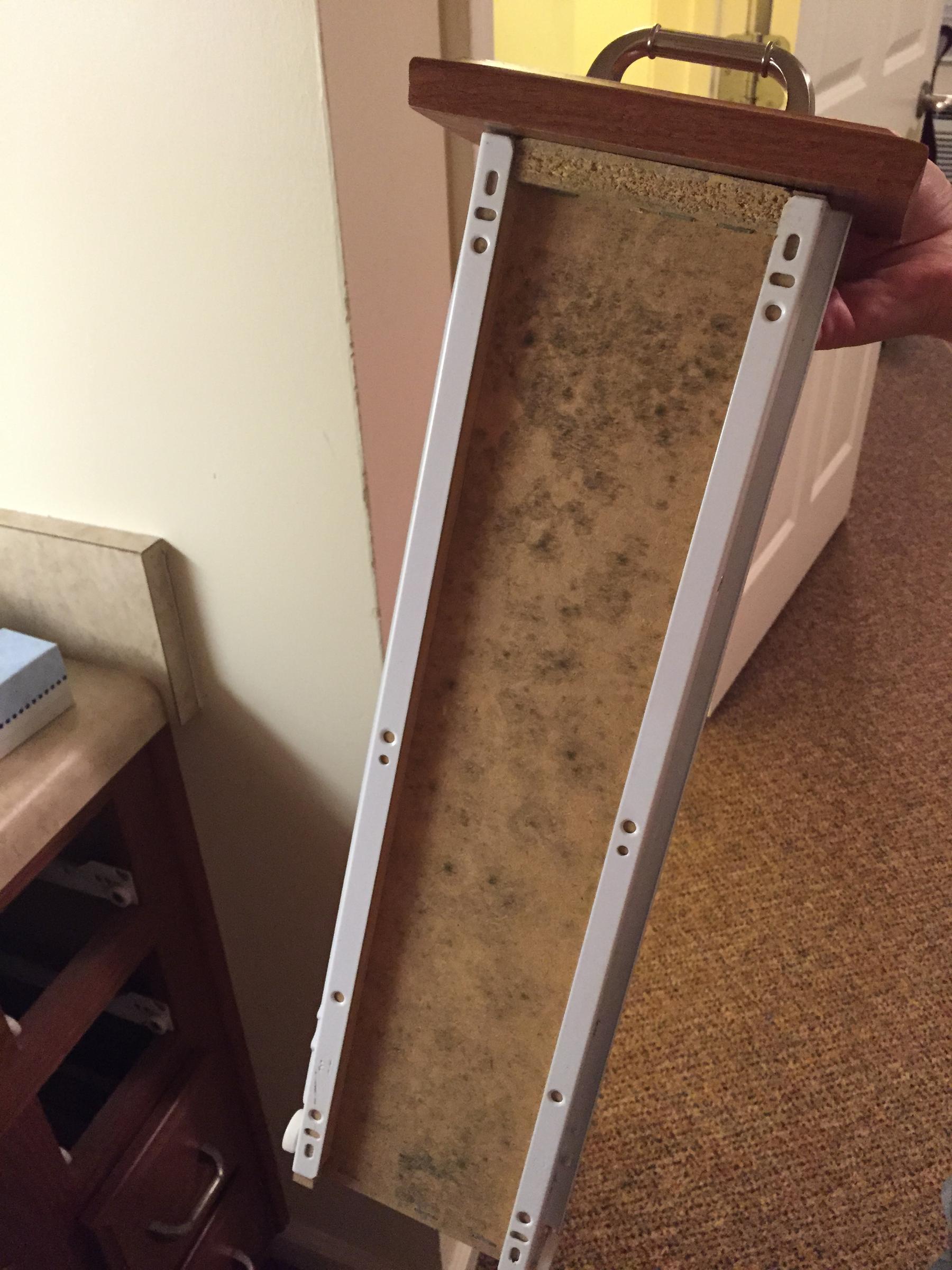

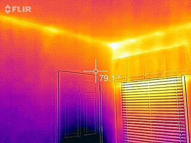

BSC was asked to investigate an 8-year old assisted care facility in a mixed-humid climate, which was experiencing interior humidity control problems, including interior dampness, mold growth on furniture and walls, and musty odors. BSC’s field work included examination of the building enclosure (shell) and measurements and analysis of the installed mechanical systems.

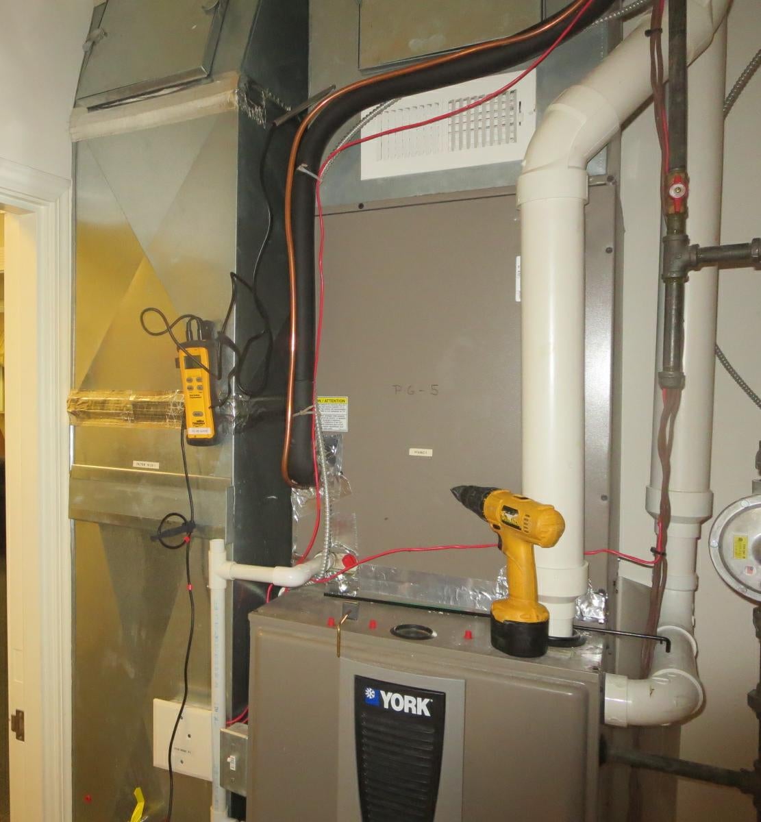

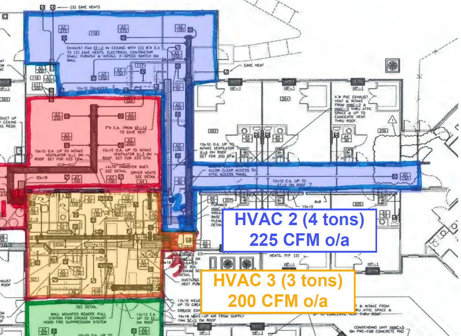

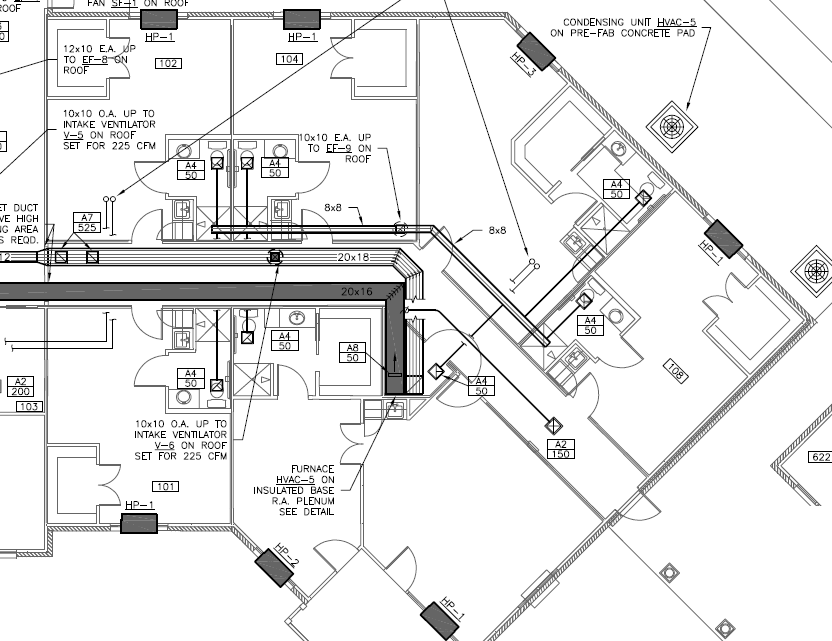

Measurements of the central HVAC systems demonstrated that several units were exhibiting poor dehumidification (small temperature drop and small dewpoint change). Continuous fan operation also reduced dehumidification capacity of these units: this strategy re-evaporates condensed moisture from the cooling coils. These systems also brought in excess amounts of exterior air from outside air ducts, via motorized dampers run using ineffective control strategies. In contrast, portions of the building with fewer problems used ERV (energy recovery ventilators) for outside air ventilation. Further calculations indicated that the cooling systems were oversized (exacerbating humidity problems) and had excess outdoor air ventilation rates.

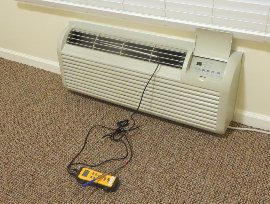

Several residential rooms were conditioned by PTAC (packaged terminal air conditioner) units. These units were also oversized (by a factor of 4 or 5), set on continuous fan operation, and had an excessively high ventilation rate (125%-170% of required). All of these exacerbate humidity problems in a mixed-humid climate.
Potential enclosure issues included a lack of brick cavity ventilation (possibly resulting in inward vapor moisture drives) and air leakage from the attic via unsealed wall top plates (as demonstrated by infrared thermography).
