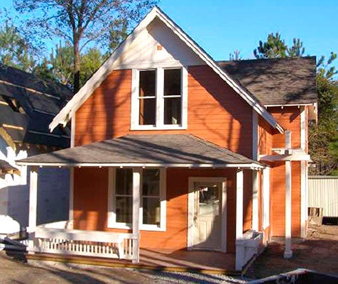

Hilton Head, SC
Project Team: Coastal Habitats, Building Science Corporation
Location: Hilton Head, South Carolina

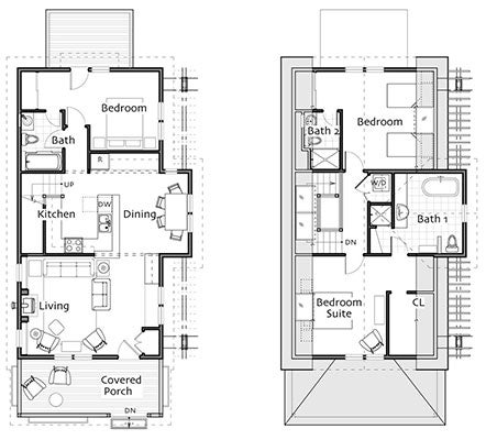

Description: 1,495 ft2 one-and-a-half story, three-bedroom, three bath single family house
Completion Date: September 2008
Estimated Annual Energy Savings: $426 per year with 50% source energy savings; with 6.5 kW PV array predicted source energy savings is 99%

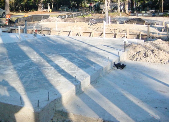

Foundation: 4” monolithic slab with turned-down edges poured over a 6-mil polyethylene vapor barrier over compacted stone/sand; slab-edge insulation was not used due to the long-term risk of termite infestation through or behind the insulation.
Monolithic slab

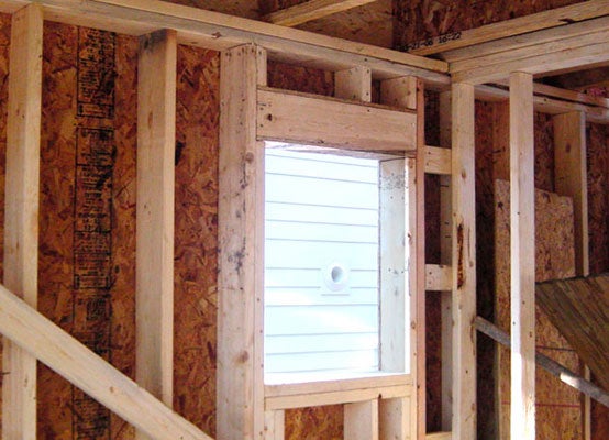

Air Sealing: Insulated headers were used in conjunction with other advanced framing techniques at corners and partition intersections to reduce unnecessary wood and increase insulation; foam gasket and capillary break between the pressure treated bottom plate and the foundation.
Insulated header

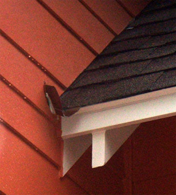

Drainage Plane: Butyl flashing membranes integrated with the house wrap drainage layer for all windows, doors, roof-to-wall flashings and through-wall penetrations for plumbing, venting, and wiring.
Roof-to-wall (kick-out) flashing

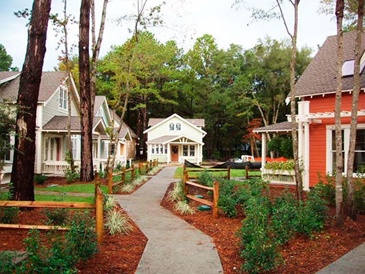

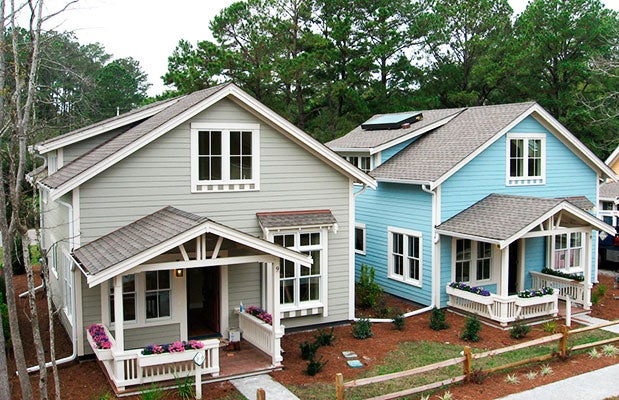

  • The site is a four-acre parcel with nearly two acres of freshwater wetlands that will remain undeveloped
  • Mature trees around the homes were left in place as much as possible to help shade the homes in summer

Landscape Plan: Low maintenance grasses and shrubs were purposefully designed into the landscape; all hard surfaces are pervious concrete.
Landscaping

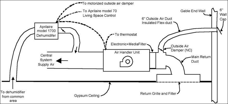

Ventilation: Central-fan-integrated supply (CFIS) with fan cycling and motorized damper
Dehumidification: Whole-house dehumidifier integrated with central system
Dehumidification system schematic

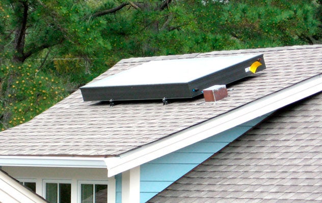

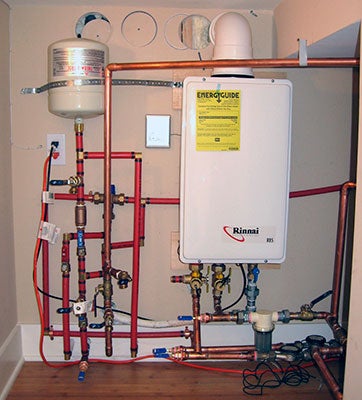

DHW: Sealed-combustion, direct vent tankless DHW; 0.85 EF; solar hot water optional
Direct vent tankless domestic hot water heater
Optional solar hot water panels

In this project, a 6 inch diameter insulated outside air duct and normally-closed motorized damper were fitted to the return side of the air handler unit generally according to the schematic.3 The system supplies about 50 cfm of outside air for a minimum and maximum of 33% of the time. This fan cycle rate will not provide the ASHRAE Standard 62.2 (ASHRAE 2007) airflow amount, although the system could meet the 62.2 airflow amount if the fan was operated continuously. Operating the central fan continuously is NOT recommended, especially in warm-humid climates, because of re-evaporation of moisture from the wet cooling coiling4 and excessive fan energy consumption which ends up as heat that the cooling system must remove. As was done in this project, the best practice is to install one 62.2 compliant exhaust fan in every house, which is the ventilation system of record for rating purposes. The existence of that fan exhaust fan, and an on/off switch, meets the 62.2 requirements by itself. Central fan cycling operation is then outside of the rating in the same way that the Fan On button on the thermostat is outside of the rating. In reality, about half the fan cycling operation for supply ventilation does double-duty because it is needed for thermal comfort mixing anyway.
The ventilation controls for this particular system are integrated with the whole-house dehumidifier controls. Here are the principals of operation:
a) The dehumidifier must be have power in order for any ventilation and central fan cycling and outside air damper cycling to occur. The dehumidifier will operate to reduce indoor humidity independently of ventilation and central fan cycling.
b) The central fan will operate for at least 10 minutes per half hour (including any operation due to thermostat demand).
c) The outside air damper will be open for 10 minutes per half hour while the central fan is operating.
The outside air damper will not be open for more than 10 minutes per half hour regardless of any additional fan runtime due to thermostat demand. The outside air fraction is about 10% or less, so, being mixed with 90% or more inside air, there is no need to dehumidify it first. The moisture will be removed with normal cooling demand, or by the dehumidifier if cooling demand does not control it.
d) The dehumidifier will run only as needed based on the measured humidity in the living space and the humidity setpoint. As humidity rises in the living space for any reason, ventilation or otherwise, the dehumidifier will be energized and bring the humidity back down.
