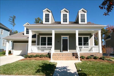

Fort Mills, SC - Baxter Community: High Performance Green Building - Case Study
Fort Mills, SC
Project Team: David Weekley Homes Charlotte, North Carolina Division, Building Science Corporation, MASCO—Environments for Living™
Address: Fort Mill, South Carolina
Description: 2,098 to 3,721 ft2 one- and two-story, 3 to 4 bedroom homes
Completion Date: To be completed 2009
Estimated Annual Energy Savings: $986 Energy savings per year
Project Website: http://tinyurl.com/bofwc6
Baxter Village is a residential community located approximately 20 miles south of Charlotte, North Carolina. The development is being constructed by the Charlotte division of David Weekley Homes (DWH).
Baxter Village in Fort Mill, South Carolina is located within DOE Climate Zone 3­—a mixed-humid climate. A mixed-humid climate is defined as a region that receives more than 20 inches of annual precipitation, has approximately 5,400 heating degree days or less, and where the monthly average outdoor temperature drops below 45˚F during the winter months.
DWH is actively reducing the energy consumption of their homes through the implementation of their David Weekley “Green Homes” program. This program is intended to promote certain features designed to make homes more economically sustainable over the long term and reduce energy usage and the resulting environmental impact. The DWH Green Program is not only being implemented successfully in Charlotte, but nationwide in almost all DWH divisions. The Charlotte division of DWH is reducing their energy demand through a number of techniques including advanced air sealing techniques, the installation of SEER 14 air conditioners, and Low-e windows in conjunction with conventional framing and insulation. The homes built by the Charlotte division of DWH have been able to maintain a competitive market advantage in all developments even within a soft housing market.
DWH is working with Southern Energy Management for ENERGY STAR® verification and Masco implementing their Environments for Living® (EFL) program. Masco EFL is providing the majority of the testing and rating the homes. All homes are attaining the Diamond class under the EFL program. The Diamond level of EFL ensures the homes have enhanced water efficiency, advanced indoor air quality and attain an air tightness of 0.25 cfm/ft2 of envelope area at 50 pascals as well as other performance standards (www.environmentsforliving.com). The EFL program standards have been developed with the support of BSC’s Building America researchers.
The target for the DWH Fort Mill development is to achieve a 40% whole house energy savings over the BA benchmark in a mixed-humid climate. All homes built will also be part of the DWH Green Program, EFL Diamond and in 2009 they will be part of the DOE Builders Challenge.

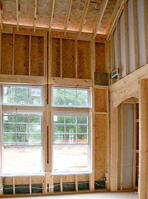

Roof: Trussed
Roof trusses stacked above wall framing
Framing: 2x4 conventional wall framing at 16 o.c.

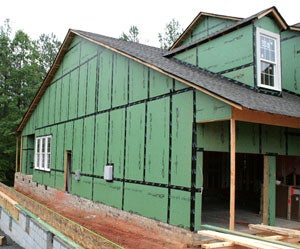

Air Sealing: Taped Huber ZIP System® sheathing; low expanding foam sealant around windows doors, penetrations and base plates
Huber ZIP System®
Air sealing electrical boxes
Roof Insulation: R-30 fiberglass batt insulation on flat ceilings; R-19 in sloped ceilings
Wall Insulation: R-13 fiberglass batt insulation
Drainage Plane: Taped Huber ZIP System® sheathing

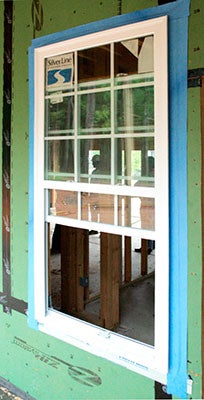

Window Specifications: Double pane vinyl spectrally selective Low-E: U=0.34, SHGC=0.27
Window installed and flashed

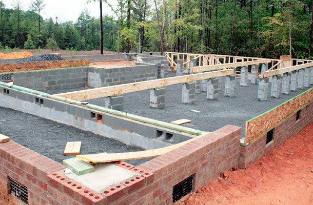

Foundation: Vented unconditioned crawlspace
Vented, unconditioned crawlspace

DWH in Charlotte utilizes the Huber ZIP System® sheathing in conjunction with self-adhered membrane flashings as a drainage plane to ensure water than passes the primary water shedding layer is not allowed to penetrate into the building assembly. Sub-sill flashings are also provided below all windows to ensure that in the event a window leaks the water will not enter into the wall assembly. The photos within the Building Enclosure section of this report show both the fully flashed window and the taped Huber ZIP System® sheating. The quality control coaches have paid special attention to these details and have consistently achieved a high level of quality workmanship.

Subsill flashing: windows and doors must be “pan-flashed”
  • All windows and door openings are “pan-flashed”
  • Pan-flashing installed with end dams and positive slope towards the exterior
  • Flashing materials are correctly lapped

The R-13 conditioned crawlspace option was not chosen in 2008. This would consist of sealing and insulating the crawlspace with a combination of foil faced polyisocyanurate foam and spray foam to ensure air barrier continuity. The floor would be covered and sealed with 6mil polyethylene with the joints taped to create an air seal.
