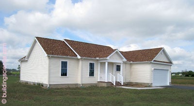

Ellendale, DE - Sandstone 40% Prototype - Case Study
Ellendale, DE
Location: Ellendale, Delaware
Project Team: Colter Construction, Building Science Corporation
Description: 1,280 ft2 one-story, three bedroom, two bath single family home
Completion Date: September 2009
Estimated Annual Energy Savings: 44% energy use reduction compared to the Building America benchmark
Sandstone is a 49-home subdivision located in Ellendale, DE. The project is Colter Construction’s first entry into community-scale development. The homes are intended to be attractive to the first-time homeowner, and to empty nesters, two strong markets in the region. The company has considerable experience building energy efficient custom homes in Sussex County.
Founder and owner Terrance Babbie contacted BSC in May of 2009 for help in bringing his construction practices up to the state of the art. Terrance was already familiar with much of BSC’s published materials, and works with subcontractors who are also accustomed to standard energy measures in the custom market. This experience was invaluable in rapidly implementing BSC’s recommendations for airtightness, insulating sheathing, duct layout, and other efficiency measures.
The homes are single-family detached residences of 1200 to 2000 ft2 with unvented crawlspaces. The community is located in DOE Climate Zone 4A, a mixed humid climate. Humidity control and mechanical efficiency, for both heating and cooling, were of special concern.
The Building America energy consumption reduction goals (minimum 40% source energy consumption reduction compared to the 1990’s Benchmark construction) were exceeded for the community. The homes were modeled at around 44% savings, an exceptional performance in this market.

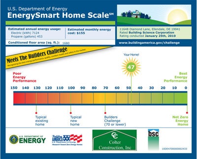

The Building America goals for the community were to achieve a minimum of 40% source energy consumption reduction when compared to the Building America benchmark. The builder’s goal was to achieve a HERS 50, which proved to be a slightly more stringent requirement. Because heating and cooling together account for half of the energy consumption in the base (unimproved) model, most of the improvements made are to insulation and airtightness. However, because the community is located in a mixed-humid climate, cooling and dehumidification are active for much of the year.

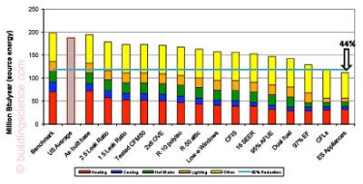

All of these strategies were modeled in an annual hourly model. The graph above shows the total household source energy use as predicted after each upgrade. The house as built meets both the 40% Building America and the 50 HERS score target.
Parametric Study
Builder's Challenge label

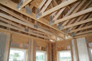

Roof Assembly: The roof assembly is designed as a vented attic framed with trusses.
Attic trusses

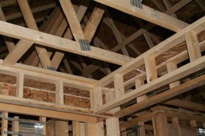

Wall Assembly: The walls are framed with 2x6’s on 24” centers. One-and-a-half inches of polyisocyanurate board insulation was installed on the exterior of the frame, reduced to 1” where OSB is required to provide racking resistance.
Wall framing

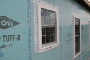

Window Specifications: The windows are BF Rich vinyl double paned low-e with argon. These windows have a U-Value of 0.27 and SHGC of 0.24. The windows were installed over a flexible membrane pan flashing to drain water that penetrates the windows.
Windows installed

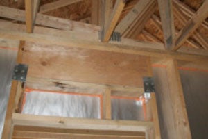

Air Sealing: Dropped soffits in the kitchen present a challenge to air barrier continuity. OSB blocking above the soffits allows the air barrier to continue in the same plane. This is much easier to execute than would be bringing the air barrier down around the soffit. A secondary airseal was accomplished between the exterior sheathing and the building frame. All framing members at the rim joist were connected with caulk to provide continuity between the foundation wall below and the wall assembly above.
Air sealing

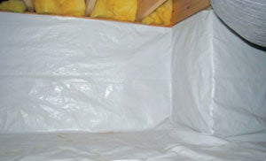

Foundation Assembly: The crawlspace floor is covered with 6-mil polyethylene to prevent infiltration of air, moisture, and soil gasses. Joints in the groundsheet are sealed with mastic. The foundation wall is concrete block, with 2” of XPS on the interior.
Crawlspace with 6-mil polyethylene

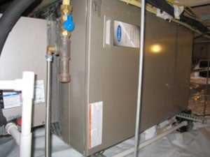

Heating and Cooling: The house features a dual fuel air source heat pump. Simulations and manufacturer data show that this system can save 10% to 20% of annual heating energy. A 16 SEER split system central air conditioner provides cooling. A separate central dehumidifier provides additional latent capacity during shoulder seasons.
Heat pump installed

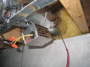

Ventilation: Outdoor air is provided by a central fan integrated supply system.
Central fan integrated supply system

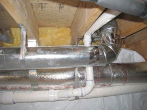

Space Conditioning Distribution: Ducts within conditioned space.
Ducts installed

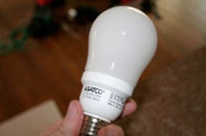

Lighting: ENERGY STAR®CFLs
Installed light bulbs

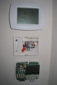

The dual fuel heating system is operated by a so-called “communicating” proprietary controller. These integrated systems can provide higher efficiency, increased comfort, and additional dehumidification capacity, but they do not always integrate well with other devices.
The balance of the HVAC system includes a dehumidifier and an outside air duct with a mechanical damper. Prior Building America research has established the importance of avoiding operation of the dehumidifier during cooling runtime Three separate controllers were required to control the various pieces of equipment.
BSC provided wiring diagrams to connect the fan cycler and lock out the dehumidifier during cooling. When this proved inadequate, BSC went to the site to troubleshoot, finding both undocumented changes to the hardware and errors in the site work. Two replacement relays later, the entire system was working as designed, and BSC has a new wiring diagram for this design.
