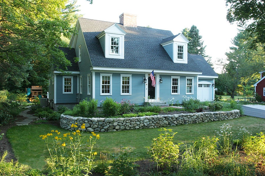

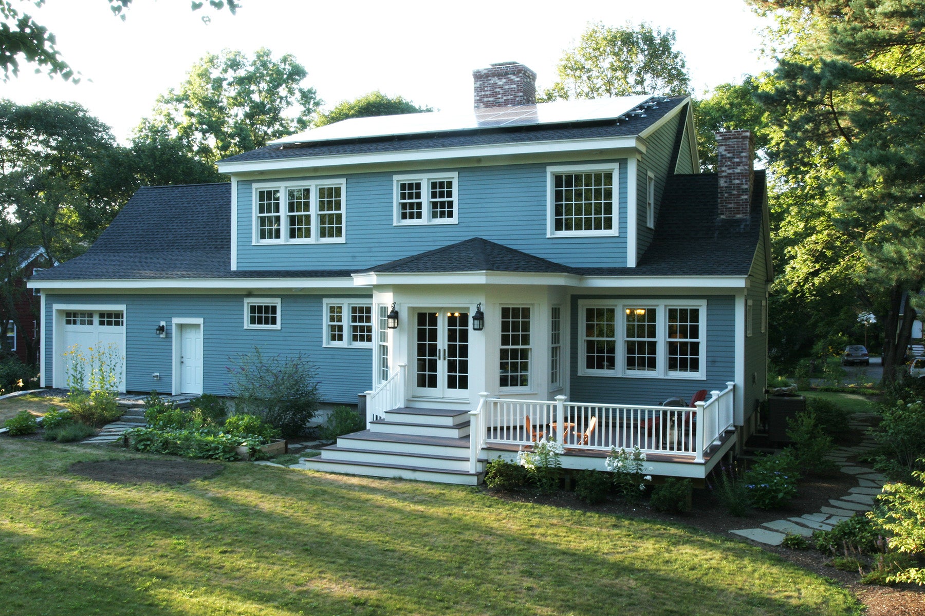

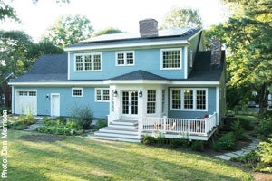

The design of the Concord Cape began in August of 2008. Architects and engineers at BSC developed the drawing set and specifications for the high performance custom home to be built in Concord, Massachusetts. The house is a Cape Cod style design with 5 bedrooms, 4 full bathrooms, 2 stories plus a finished basement. It is built into an existing neighborhood close to public transportation, restaurants, shops and other community resources. BSC worked closely with the homeowner to design a house that combined the desired design aesthetic, both interior and exterior, with high performance.

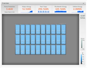

The house is designed to achieve an 87% reduction in source energy use when compared to the 2009 Building America Benchmark. This design features high-R walls, roof, and foundation along with a high efficiency mechanical system. Supplementing the high performance enclosure and mechanical system is a 7 kW PV array installed on the south facing roof. This 87% energy use reduction is equal to HERS 18 and a $4,700 annual utility bill savings to the homeowner.
The Concord Cape is not only part of the Building America Program, but is also registered in Builders Challenge and in USGBC’s LEED for Homes program, designed to achieve Platinum certification.

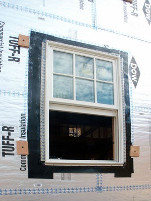

In order to go above and beyond the goal of a 50% energy savings when compared to the Building America Benchmark, exceptional airtightness was specified. And in order to achieve this level of airtightness, multiple methods of air sealing were detailed in the drawings. These methods included the Airtight Drywall Approach for walls and ceilings, high density spray foam at rim joists, backer rod and sealant at windows and doors and taping the XPS insulation joints on the basement walls. For additional airtightness, the builder chose to also tape the foil-faced polyisocyanurate installed on the exterior walls. The actual tested airtightness (0.07 leak ratio) is represented in the parametric chart.

Air Sealing: Maximum 0.15 CFM50 per ft2 of enclosure area. Spray foam at rim joist and breakfast area and dormer roofs, airtight drywall approach used in wall assembly, taped XPS insulation on basement walls. Adhesives and sealants used between framing members, around windows and doors, and at all mechanical and electrical penetrations through the enclosure.

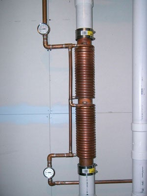

DHW: 0.94 EF gas condensing tankless water heater with drainwater heat recovery.

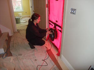

Concord Cape performance testing was done at both the rough-in stage as well as after construction was complete. At the time of the rough-in testing, the following had been installed: all windows and doors, high density spray foam at rim joists and unvented roofs (breakfast area and dormers), second floor ceiling drywall, taped exterior insulation, sheet metal ductwork and mechanical equipment in the basement. The blower door test result was 1019 CFM50, which is equal to 0.13 CFM50 per ft2 of enclosure area and 1.44 ACH50. Even before the Airtight Drywall Approach was implemented on the walls, the Concord Cape met the specified airtightness. Final performance testing revealed an even more airtight house with the following blower door test results: 505 CFM50, equal to 0.07 CFM50 per ft2 of enclosure area and 0.72 ACH50. Duct leakage to outside was measured at 18 CFM25.

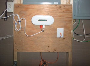

BSC is planning to collect monthly gas and electricity bills from the homeowner for at least one year. Actual energy use will then be compared to predicted energy use. In addition to the utility bills, the team will install and monitor a comprehensive circuit-by-circuit home energy monitoring and management system. The system displays electricity use by individual circuit so you can see real-time and historical information on specified circuits including major appliances, heating and cooling equipment, home offices and entertainment areas.
Design Highlight: 7 kW PV Array with Microinverters |
