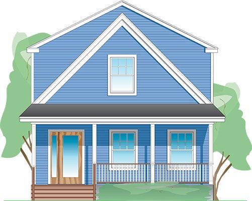

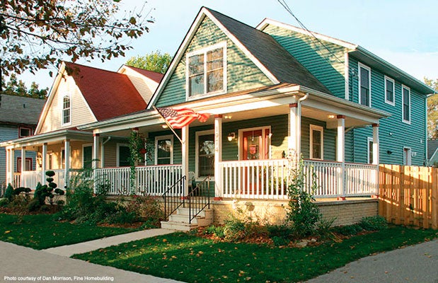

Project Team: Building Science Corporation, GreenBuilt Ltd.
Address: Cleveland, OH
Description: 1,824 ft2, three bedroom with a loft, 21/2 bath with a 1,065 ft2 fully insulated basement
