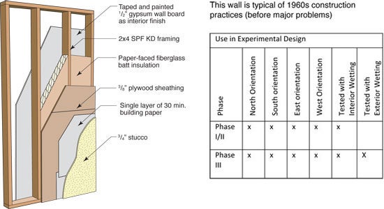

Panel 1: Early 2x4 (R-8 paper-back batt)

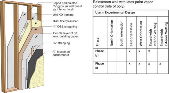

Panel 6: Rainscreen 2x6 (no poly, 3/4" cavity)

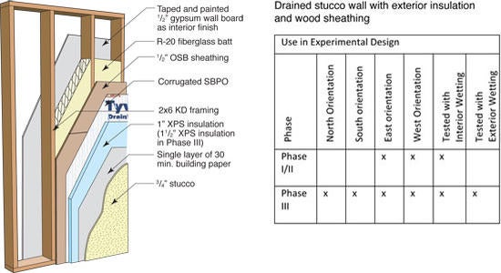

Panel 7: Exterior insulation and wood sheathing (no poly, OSB, XPS insulation)

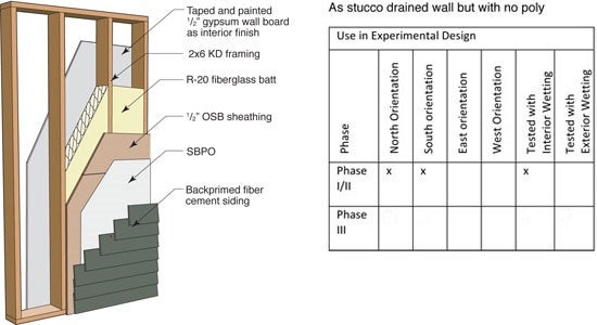

Panel 9a: Fiber cement board, direct (no poly, direct applied)

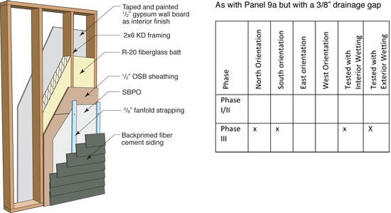

Panel 9b: Fiber cement board, strapped (no poly, 3/8" cavity)
Panel 9b: Fiber cement board, direct (no poly, 3/8" cavity)

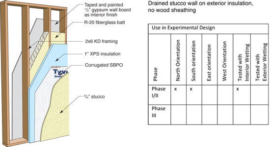

Panel 10: Exterior insulated (no poly, no OSB, XPS insulation)
