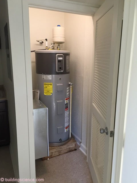

See Photograph 1 - a HPWH indoor closet install. The closet is small so, in accordance with manufacturer instructions, a fully louvered door was installed, allowing new air into the closet. This HPWH has the exhaust at the back, and the air blows directly on the back wall, which happens to be an exterior wall. The installation is in Richmond, Virginia, and the new air entering the closet is both warm and has high relatively humidity. Moisture condensed on the back wall and eventually resulted in water damage and mold, affecting both the building and its occupants. The rectangle in the foreground of the closet is a dehumidifier, installed after remediation.
Photograph 1 from Nikki Krueger. HPWH Closet Installation. Cold air discharge impacts back wall. Full louvered door allows gravity convection air exchange. However, incoming air has high humidity/dew point.

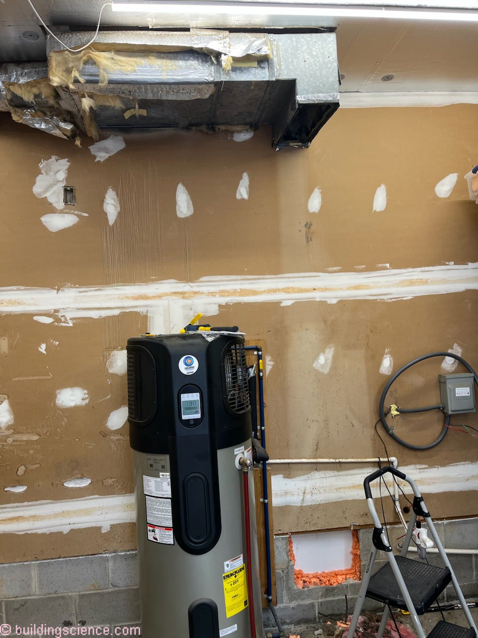

See Photograph 2 – a HPWH garage install. The garage is larger than the minimum volume requirement. However, the side exhaust blew air directly at the air handler unit. You can see the outline of where it used to be. The cold exhaust air was below the dew point of the air in the garage and moisture condensed on the supply ductwork and air handler, which had to be removed to remediate the mold. This installation is also in Richmond, Virginia.
Photograph 2 from Alex DeSpain. HPWH Garage Installation. The outline of the now missing air handler unit is visible on the dry wall. Cold air discharge pointed directly at air handler. High dew point temps in garage near Richmond, VA. Condensation on air handler and supply ductwork caused mold. Equipment was removed.

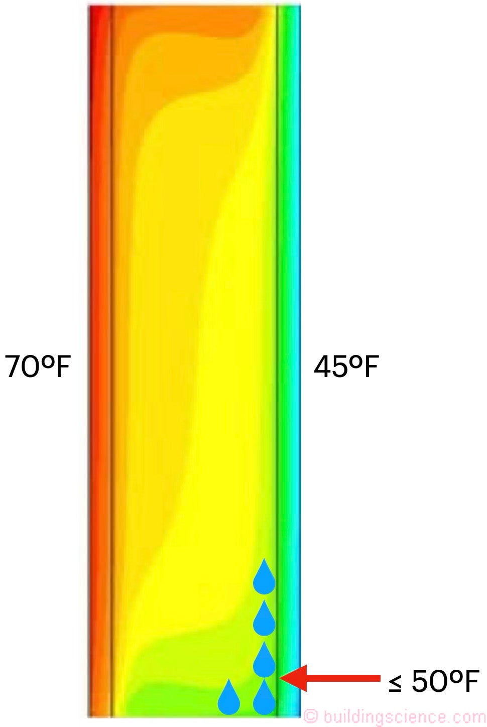

See Figure 2 – wall section showing the temperature gradients inside the wall. Cold air will tend to settle to the bottom and surface condensation will tend to accumulate along the bottom of the wall.
Figure 2 Close up of the Interstitial Space in the Wall. Notice the temperature gradients within the wall. Moisture will condense on surfaces below the dew point, this time hidden within the wall cavity. What if this was an external wall with insulation and some outdoor summer air leakage into the wall cavity?
