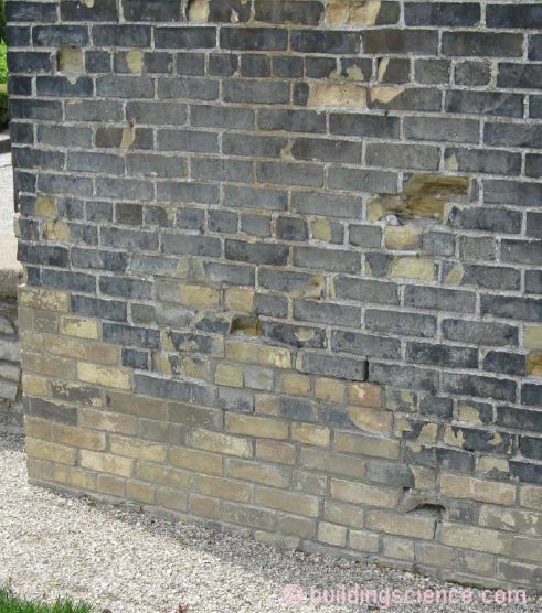

Freeze-thaw damage, spalling and efflorescence are related in an amazing strange way. In freeze-thaw damage water changes from a liquid to a solid (Photograph 1). In spalling (Photograph 2) and efflorescence (Photograph 3) water changes from a liquid to a vapor.
![BSI-144 Photograph 1](/sites/default/files/inline-images/BSI-144%20Photograph%201_0.jpg)
Photograph 1: Freeze-Thaw Damage – Water changes from a liquid to a solid.

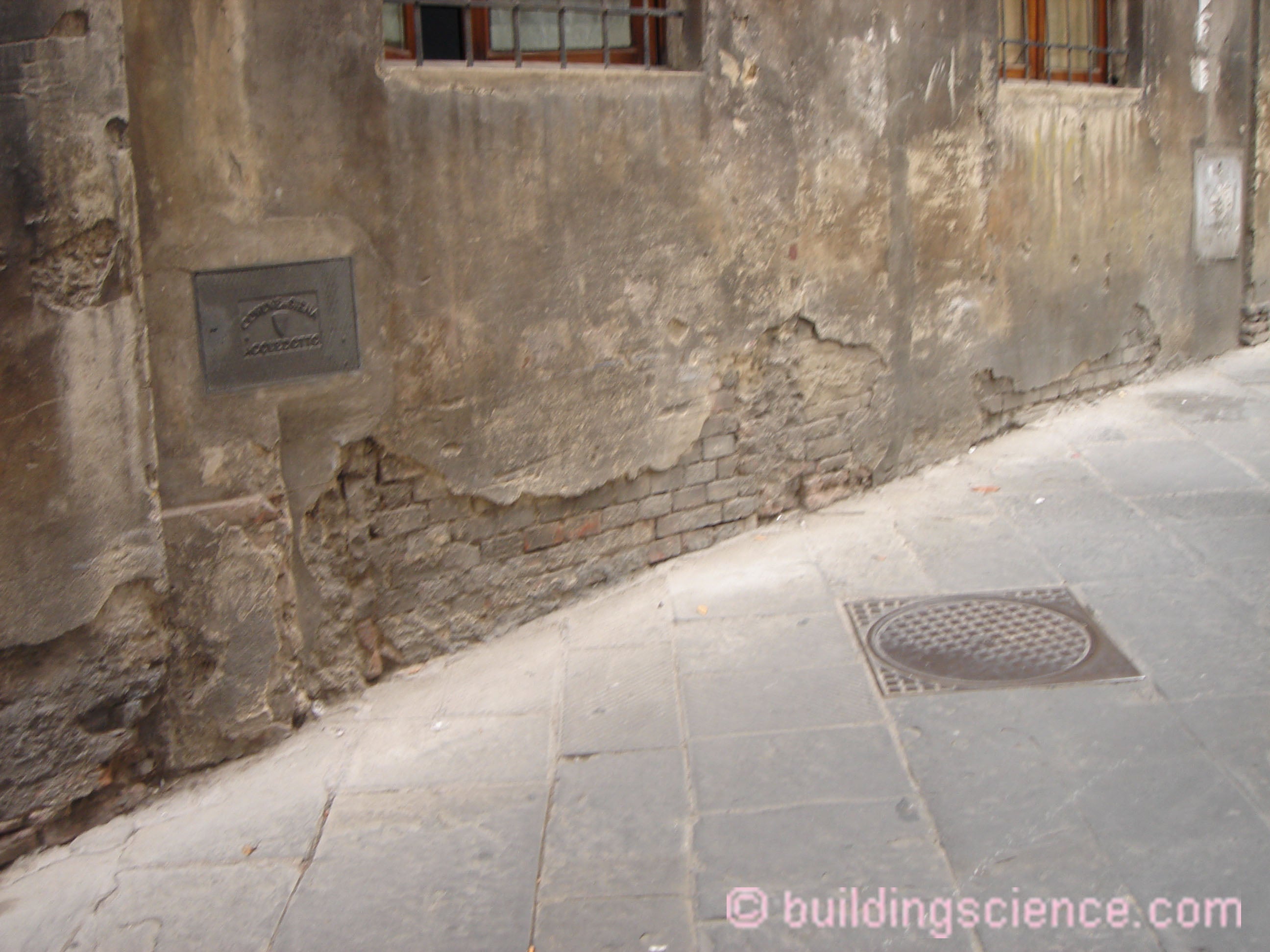

![BSI-144 Photograph 2](/sites/default/files/inline-images/BSI-144%20Photograph%202_0.jpg)
Photograph 2: Spalling – Water changes from a liquid to a vapor.

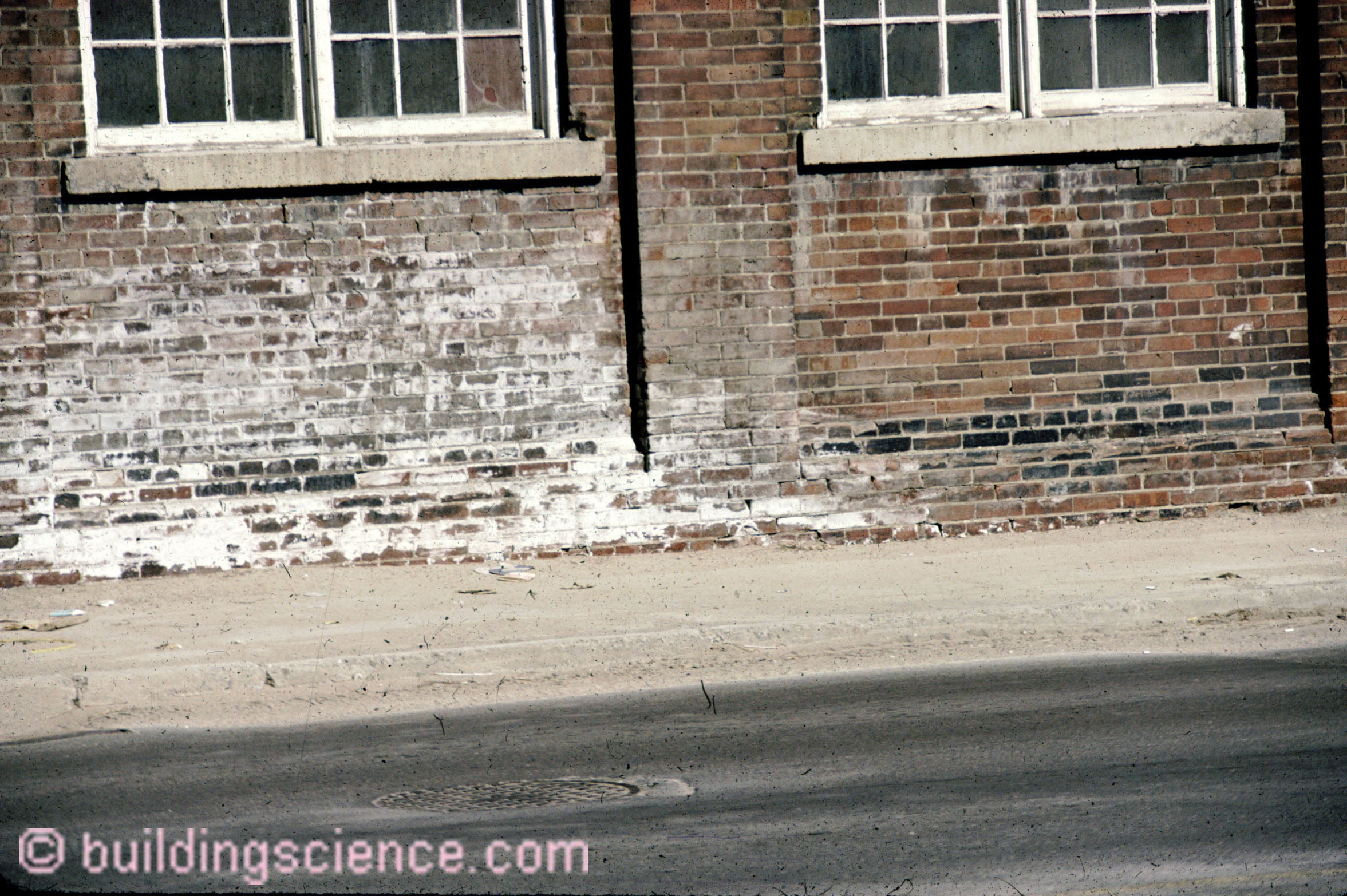

![BSI-144 Photograph 3](/sites/default/files/inline-images/BSI-144%20Photograph%203_0.jpg)
Photograph 3: Efflorescence – Water changes from a liquid to a vapor.
Freeze-thaw damage does not occur because when water freezes its volume increases by 9 percent. Note that the water does increase in volume, but this is not what leads to the freeze-thaw issues. Let me repeat, this change in volume is not what leads to freeze-thaw issues.1

When water changes phase from a liquid to a solid… stuff is left behind. Let me repeat that…because it is a big deal and folks don’t get it…when water changes phase from a liquid to a solid…stuff is left behind.
If you have soluble salts in brick or concrete and they are in solution because the brick or concrete is wet because of bad water management. When the water changes phase by freezing the concentration of salt goes up. The Second Law of Thermodynamics does not like that and water from elsewhere in the brick or concrete rushes to the increased concentration of salt to dilute the concentration. The forces that are involved can be huge…thousands of PSI….osmotic forces…and the brick and concrete burst apart. When the phase change is from liquid to solid and there is damage we call it freeze-thaw.
The osmosis pressures can exceed the cohesive strength of most porous materials and they literally blow apart.
Diffusion Vapor Pressure 0.3 to 0.5 psi (2.1 to 3.5 kPa)
Capillary Pressure 300 to 500 psi (2.1 to 3.5 MPa)
Osmotic Pressure 3,000 to 5,000 psi (21 to 35 MPa)
In concrete we address the issue by adding voids…airspaces…in the concrete….air entrained concrete to reduce the tremendous hydrostatic pressures to allow the water to squirt into the tiny air bubbles.3
In brick we address the issue by manipulating the voids in the brick by controlling the brick kiln temperature or by changing the chemistry of the mortar to attract the dissolved salt water….sacrificial mortar. To determine the effect of voids within brick you can measure the brick to determine the “critical degree of saturation”4 (yes, we were here before….”BSI-047: Thick as a Brick”, May 2010). Usually, the building already tells you if the brick is good or bad if it is old and if you look…no damage no problem. There is a catch, however, there always is. Note that the “no damage” part could be because things don’t get wet enough to matter…or the brick is good….or both. Further note that you can make things work with bad brick by making sure the brick does not get really wet….duh!!!
Guess what? Here it comes. When water changes phase from a liquid to a vapor, stuff is also left behind. Woah.…. Let me repeat that…because it is a big deal and folks don’t get it…when water changes phase from a liquid to a vapor…stuff is left behind. If it is salt…bad things happen. Sound familiar? We call it spalling and efflorescence (yes, we were here way back when…"BSI-011: Capillarity—Small Sacrifices", July 2007).

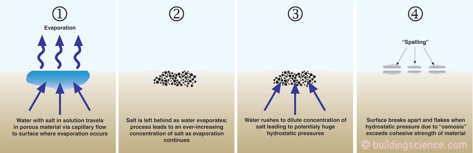

Figure 1 shows water with salt in solution traveling through a porous material by capillary flow to a surface where evaporation occurs. As the capillary water evaporates from the surface the salt is left behind. As water continues to evaporate from the surface this leads to an ever-increasing concentration of salt in the material. This increasing concentration of salt disturbs matters and to re-establish equilibrium water rushes towards the salt to dilute the concentration of salt. This can lead to huge hydrostatic pressures within the porous material caused by “osmosis”.
![BSI-144 Figure 1](/sites/default/files/inline-images/BSI-144%20Figure%201_0.jpg)
Figure 1: Spalling of Porous Materials – Without salt present evaporation of water from porous surfaces can often be easily managed – with salt present significant damage can occur.
Photograph 3 shows salt on the above grade exposed surface of a brick foundation. Water carries salt in solution to the surface of the brick where the water evaporates leaving behind the salt on the surface of the brick in the form of salt crystals. The white deposits of mineral salts are called “efflorescence”. When the crystallization of salts happens beneath the surface of the brick-mortar matrix the phenomenon is called “sub surface efflorescence” or “subflorescence”. If the subflorescence leads to sufficiently strong osmotic pressures – greater than the strength of the brick - and the brick flakes apart the damage is called “spalling”.
