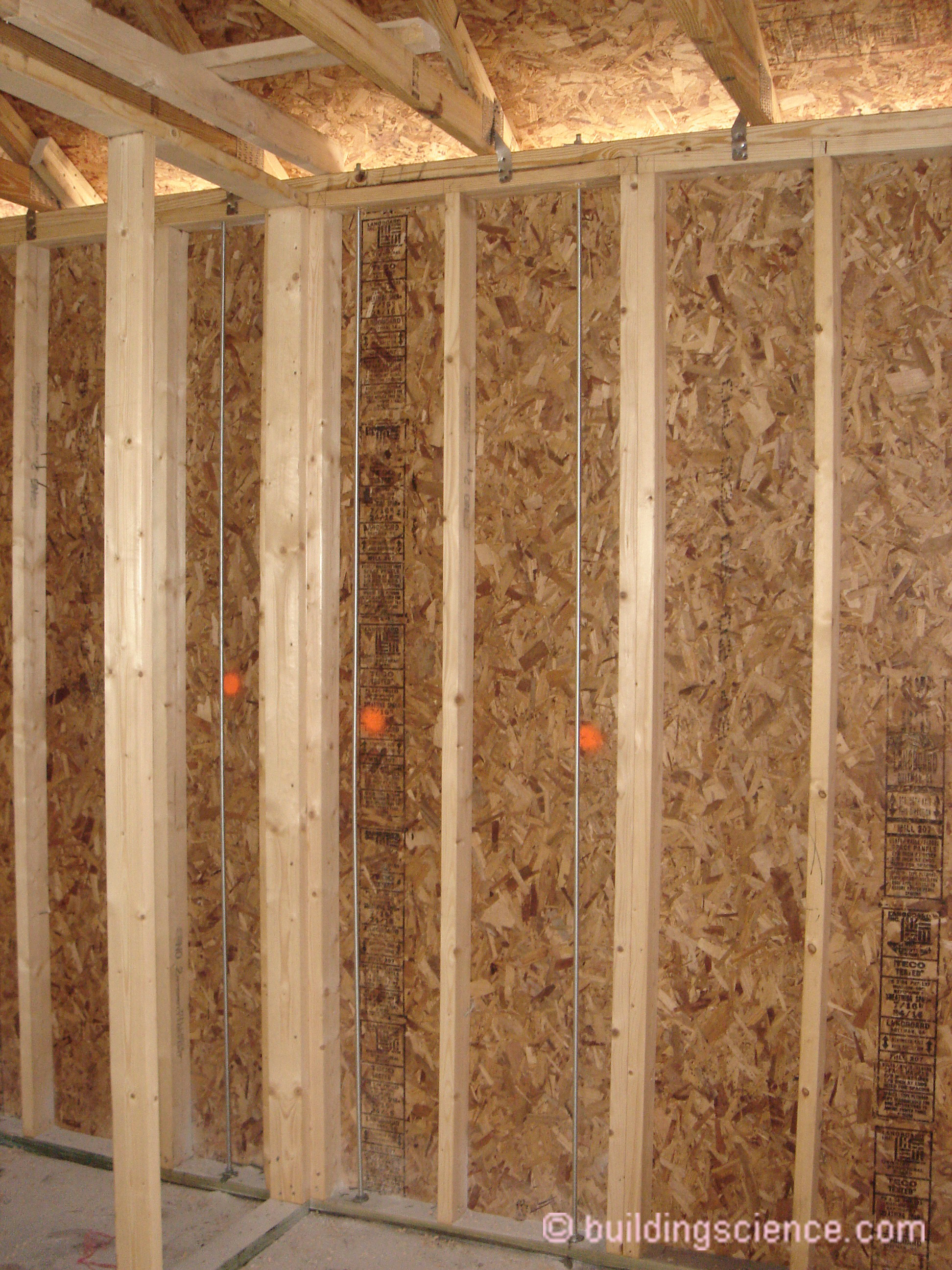

First, the materials that buildings are constructed from have changed dramatically.  The newer materials are by and large more sensitive to water damage than the older traditional materials (Photograph 1).  I am beginning to view engineered wood as an insult to wood and to engineers.  We used to go to forests and take big trees down, cut them into boards, build boats out of them, and sail them around the world.  Try doing that with oriented strand board (OSB).  We have paper-faced gypsum in place of plaster and lath.  We are lining the buildings with paper….we are building paper buildings.  Even the dumbest of the Three Little Pigs didn’t build his house out of paper.  So are we going to go back to rocks and hundred-year-old trees?  Nope.  We have to change the way we build to accommodate the new realities.
p1
Photograph 1: Moisture Sensitive Materials - The newer materials are by and large more sensitive to water damage than the older traditional materials.  Oriented Strand Board (OSB) is significantly more moisture sensitive than plywood.

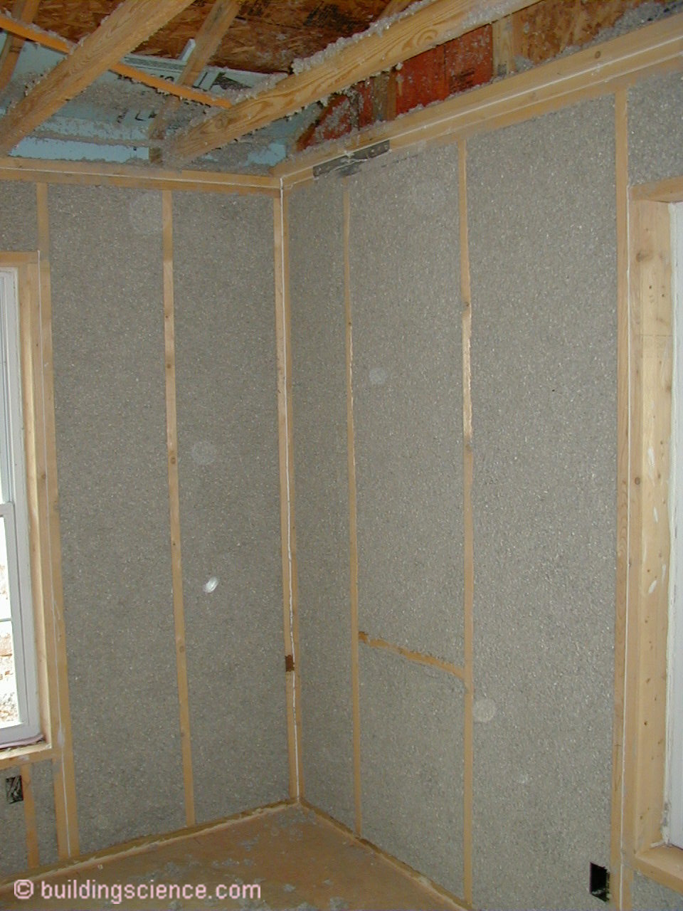

Second,  thermal  insulation was added to wall assemblies, roof assemblies, and foundation assemblies (Photograph 2).  The function was to keep the heat inside during the heating season and keep the heat outside during the cooling season. We added more and more and more.  We have reached the point where very little energy exchange happens across building assemblies.  This is both good and bad.  The good is that buildings are very comfortable and consume very little energy.  The bad is that the ability of building assemblies to dry - should they start out wet or get wet during service - has been reduced.  Drying is an energy exchange process.  Less movement of energy yields less drying.
p2
Photograph 2: Thermal Insulation - Significant increases in thermal  insulation added to wall assemblies, roof assemblies, and foundation assemblies.

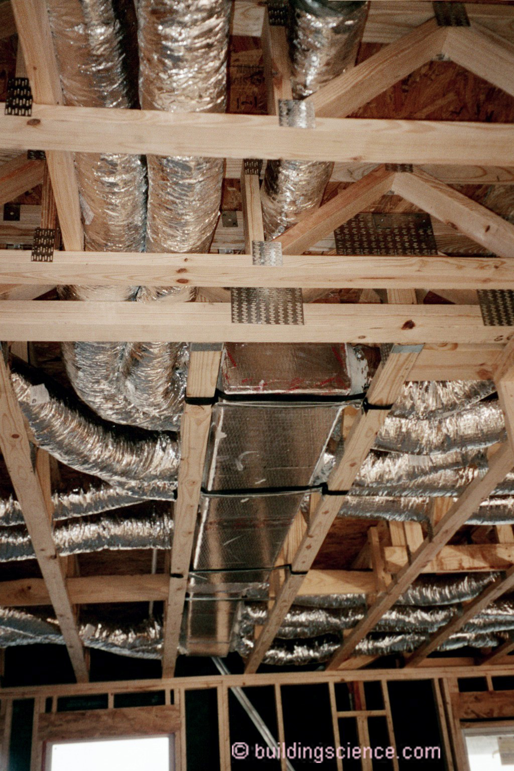

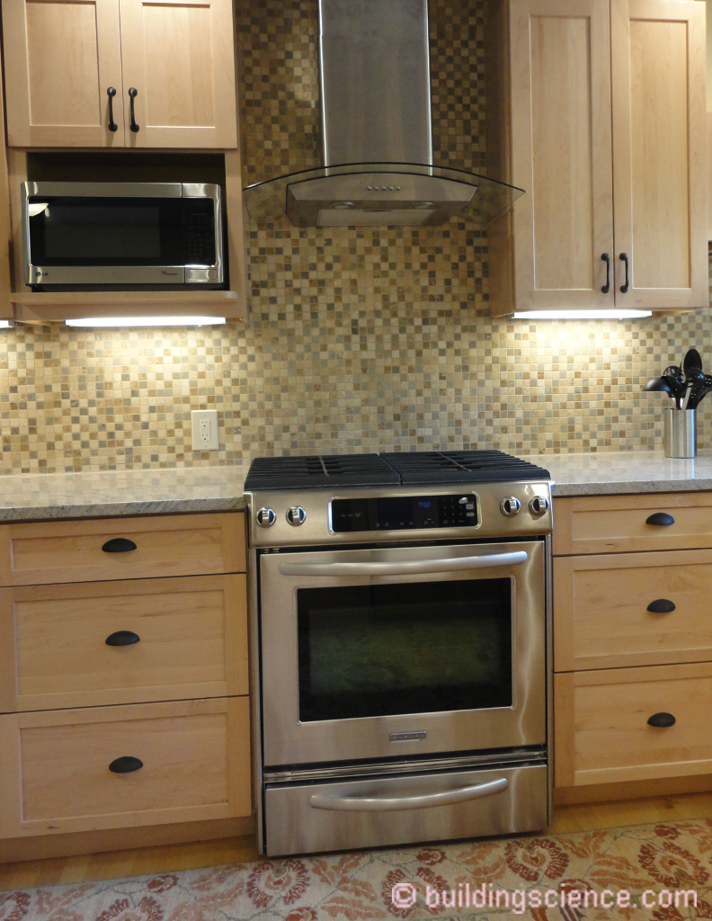

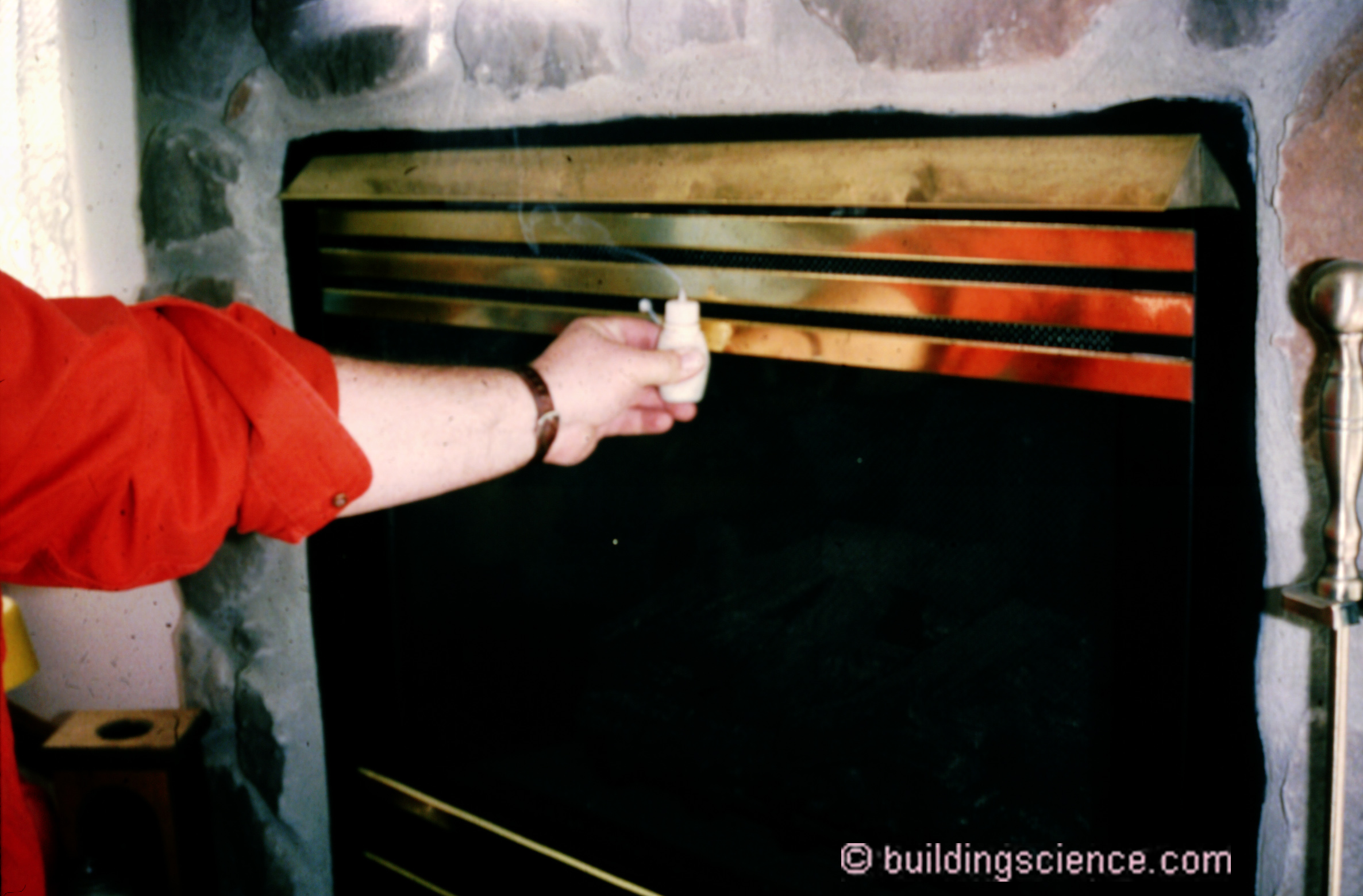

It gets even more complicated with ducted and fan- driven heating, cooling and ventilation systems (Photograph 3).  Buildings are significantly more airtight, so moving large quantities of air within them can lead to unacceptably high negative and positive air pressure differences.  And we are not done yet.  Exhaust systems such as kitchen range hoods can lead to significant negative pressures (Photograph 4) and backdraft combustion systems such as fireplaces (Photograph 5).  Because of the huge improvements in efficiency, typical air conditioning systems no longer run long enough to sufficiently dehumidify  the  interior  of  buildings.   On top of that,  modern  high  efficiency air conditioning systems provide less dehumidification than old, inefficient units.
p3
Photograph 3: Ductwork – Buildings now have ducted and fan- driven heating, cooling and ventilation systems and are significantly more airtight, so moving large quantities of air within them can lead to unacceptably high negative and positive air pressure differences.
p4
Photograph 4: Kitchen Range Hoods - Exhaust systems such as kitchen range hoods can lead to significant negative pressures.
p5
Photograph 5: Back-drafting Fireplace - Negative pressures due to air exhausting systems backdraft combustion systems such as fireplaces.

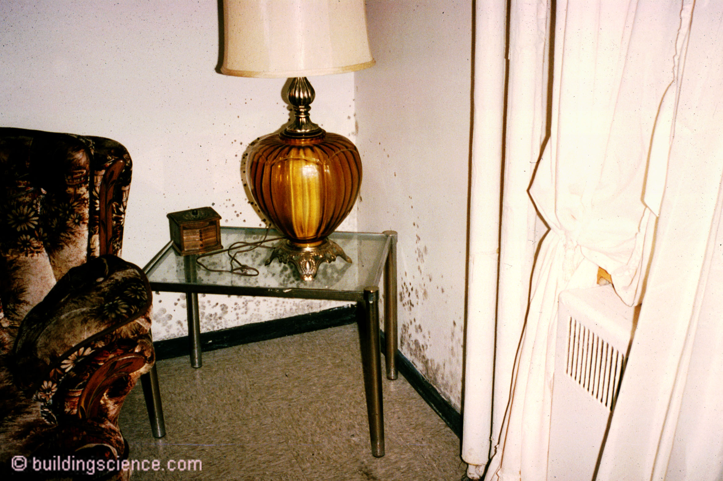

When we insulated old buildings, the paint peeled off them and attics rotted.  When we caulked and sealed old buildings we reduced air change, increased pressure differences, messed up combustion air and chimney performance, spilled and back-drafted furnaces and water heaters, collected radon and other soil gasses, increased mold (Photograph 6), increased part load humidity, increased mold again.  We should have learned.  Actually we did….but we seemed to have forgotten today1.
p6
Photograph 6: Mold - When we caulked and sealed old buildings we reduced air change and increased interior mold.
