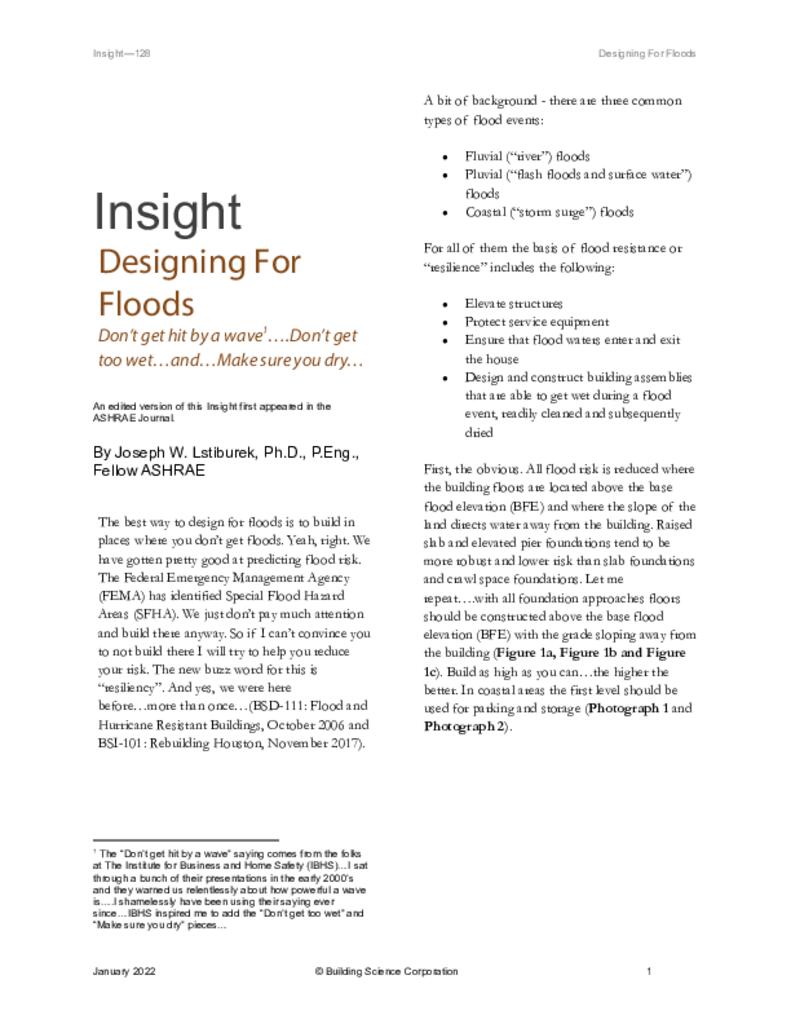

Don’t get hit by a wave1….Don’t get too wet…and…Make sure you dry…
The best way to design for floods is to build in places where you don’t get floods. Yeah, right. We have gotten pretty good at predicting flood risk. The Federal Emergency Management Agency (FEMA) has identified Special Flood Hazard Areas (SFHA). We just don’t pay much attention and build there anyway. So if I can’t convince you to not build there I will try to help you reduce your risk. The new buzz word for this is “resiliency”. And yes, we were here before…more than once…(BSD-111: Flood and Hurricane Resistant Buildings, October 2006 and BSI-101: Rebuilding Houston, November 2017).
A bit of background - there are three common types of flood events:
- Fluvial (“river”) floods
- Pluvial (“flash floods and surface water”) floods
- Coastal (“storm surge”) floods
For all of them the basis of flood resistance or “resilience” includes the following:
- Elevate structures
- Protect service equipment
- Ensure that flood waters enter and exit the house
- Design and construct building assemblies that are able to get wet during a flood event, readily cleaned and subsequently dried
First, the obvious. All flood risk is reduced where the building floors are located above the base flood elevation (BFE) and where the slope of the land directs water away from the building. Raised slab and elevated pier foundations tend to be more robust and lower risk than slab foundations and crawl space foundations. Let me repeat….with all foundation approaches floors should be constructed above the base flood elevation (BFE) with the grade sloping away from the building (Figure 1a, Figure 1b and Figure 1c). Build as high as you can…the higher the better. In coastal areas the first level should be used for parking and storage (Photograph 1 and Photograph 2).
Figure 1a, Figure 1b and Figure 1c: All flood risk is reduced where the slope of the land directs water away from the building and where the building floors are located above the base flood elevation (BFE). Raised slab and elevated pier foundations tend to be more robust and lower risk than slab foundations and crawl space foundations.
Photograph 1: Build as high as you can…the higher the better.
Photograph 2: In coastal areas the first level should be used for parking and storage.
