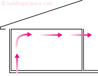

In cold climates warm air would be blown up against the cold glass from floor registers located under the windows.  The “blown” air would rise to the ceiling and the assumption was that the air would flow across the ceiling, be cooled, fall downwards and be picked up at the bottom of interior walls by a return register (Figure 1).
Figure 1:  Cold Climates - Warm air would be blown up against the cold glass from floor registers located under windows.  The “blown” air would rise to the ceiling and flow across the ceiling, be cooled, fall downwards and be picked up at the bottom of interior walls by a return register.

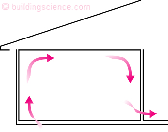

As buildings became better insulated it turned out that the air at ceilings would no longer be cooled in cold climates and fall to floor.  The simple fix to this issue was to locate returns at the top of interior walls (Figure 3).
Figure 3:  High Returns - As buildings became better insulated air at ceilings would no longer be cooled in cold climates and fall to floor thereby requiring high returns.

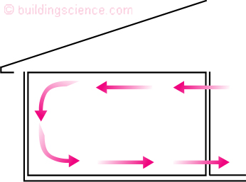

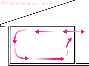

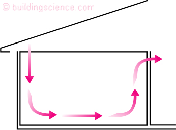

As window thermal performance improved we learned to “throw” the air across the room from registers located high on interior walls (Photograph 1).  The air would “flow” across the ceiling, get to a window, be cooled, fall to the floor, flow across the floor and be picked up by a return register located at the bottom of the wall on interior walls (Figure 4).
Photograph 1:  High Supply Registers - As window thermal performance improved we learned to “throw” the air across the room from registers located high on interior walls.
Figure 4:  “Throwing the Air” – With good windows air could “flow” across the ceiling, get to a window, be cooled, fall to the floor, flow across the floor and be picked up by a return register located at the bottom of the wall on interior walls.

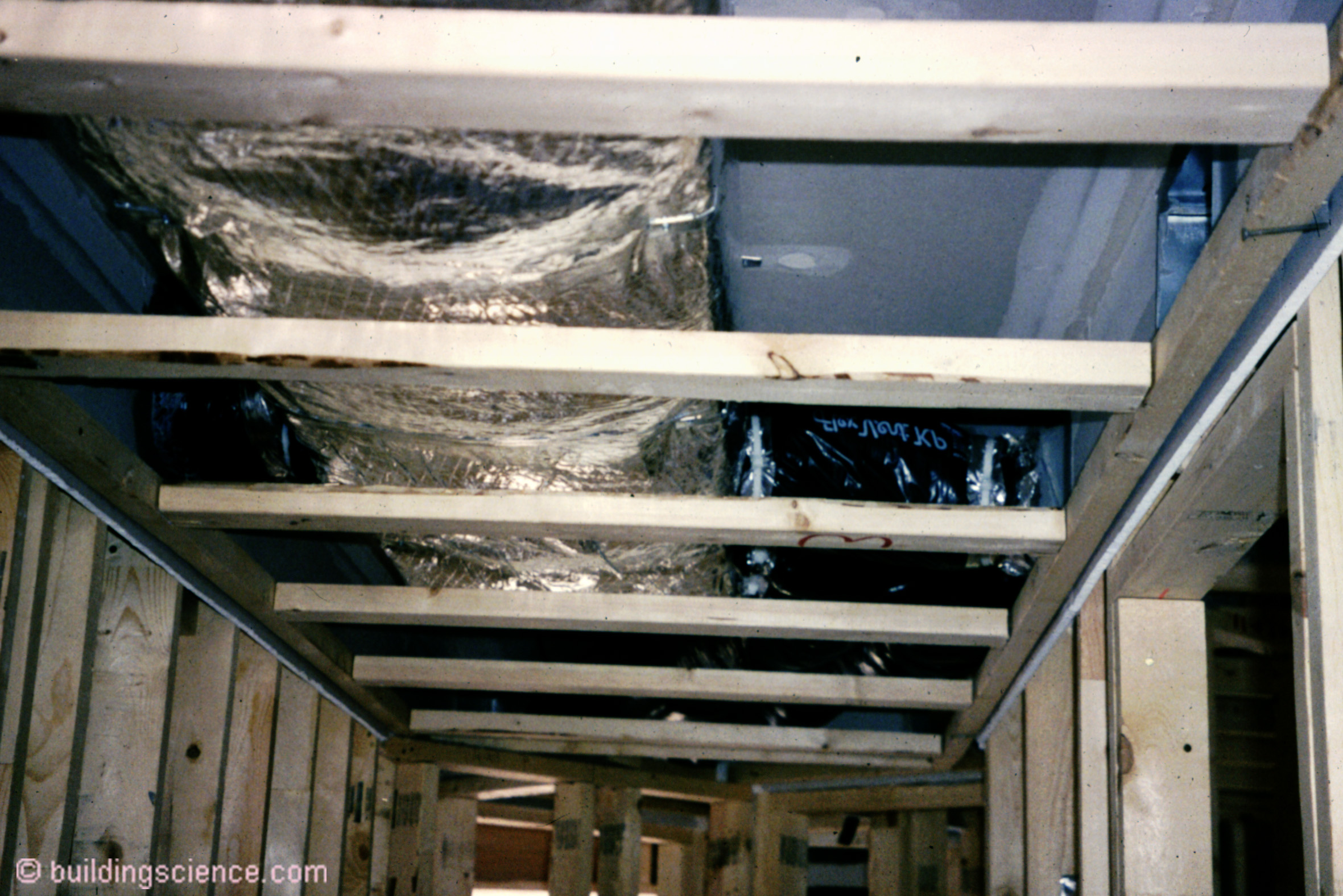

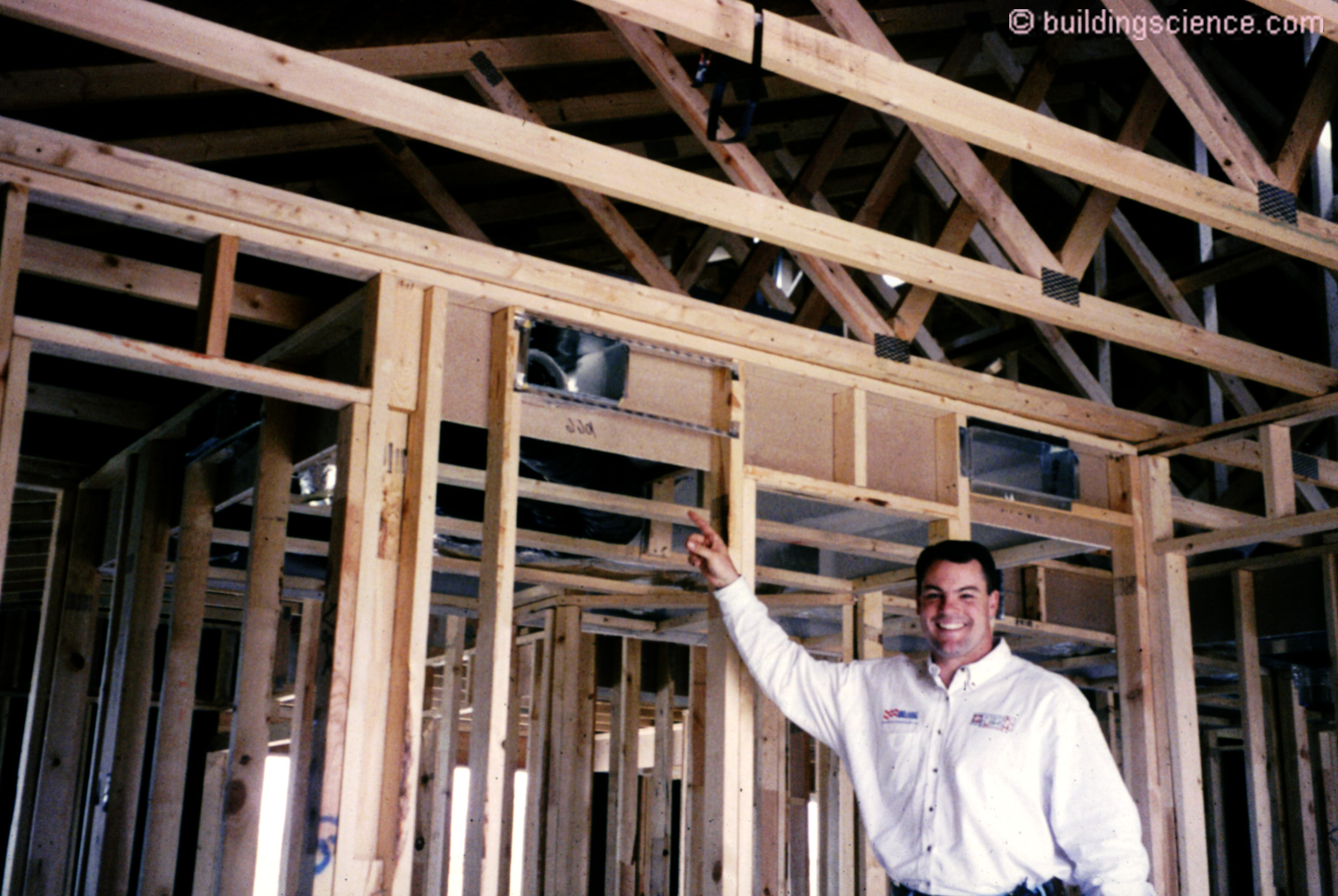

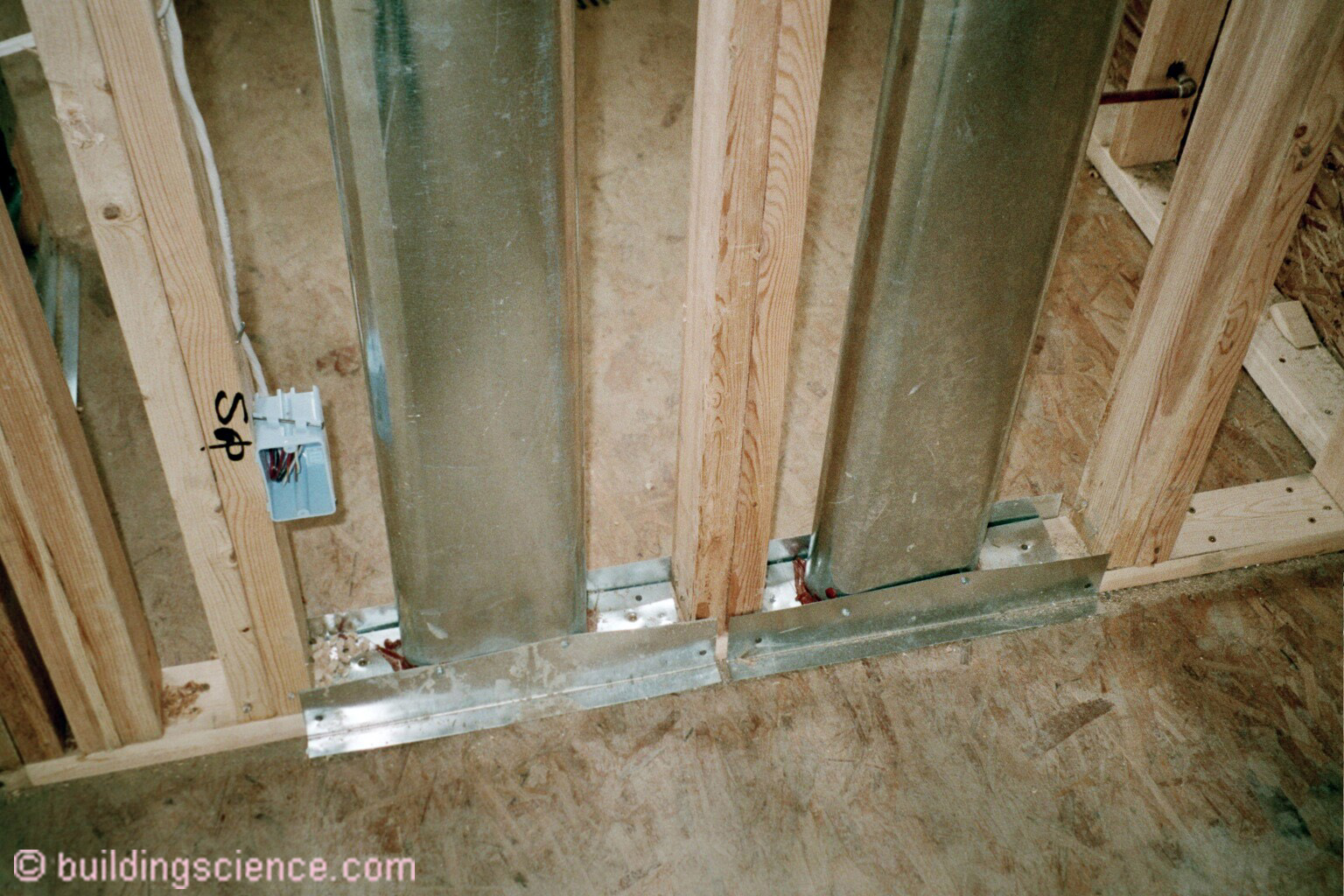

Better windows also meant smaller ducts.  Ducts could easily fit in interior walls (Photograph 2).  Not done yet.  It got even better with better windows.  The return at the bottom of the wall in Figure 4 could be moved to the top of the wall. (Figure 5).  What was nice about Figure 5 is that furniture did not interfere with air flow.  Let me repeat, furniture did not interfere with air flow.  Yeah!  Can’t tell you how much interior designers interfered with ductwork layout.
Photograph 2:  Small Ducts - Better windows also meant smaller ducts.  Ducts could easily fit in interior walls.

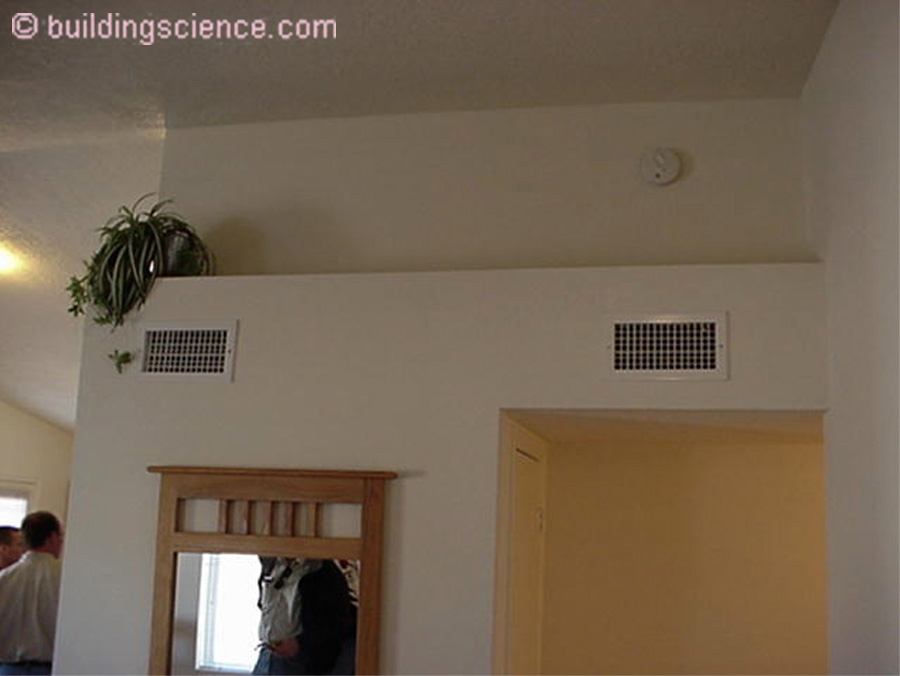

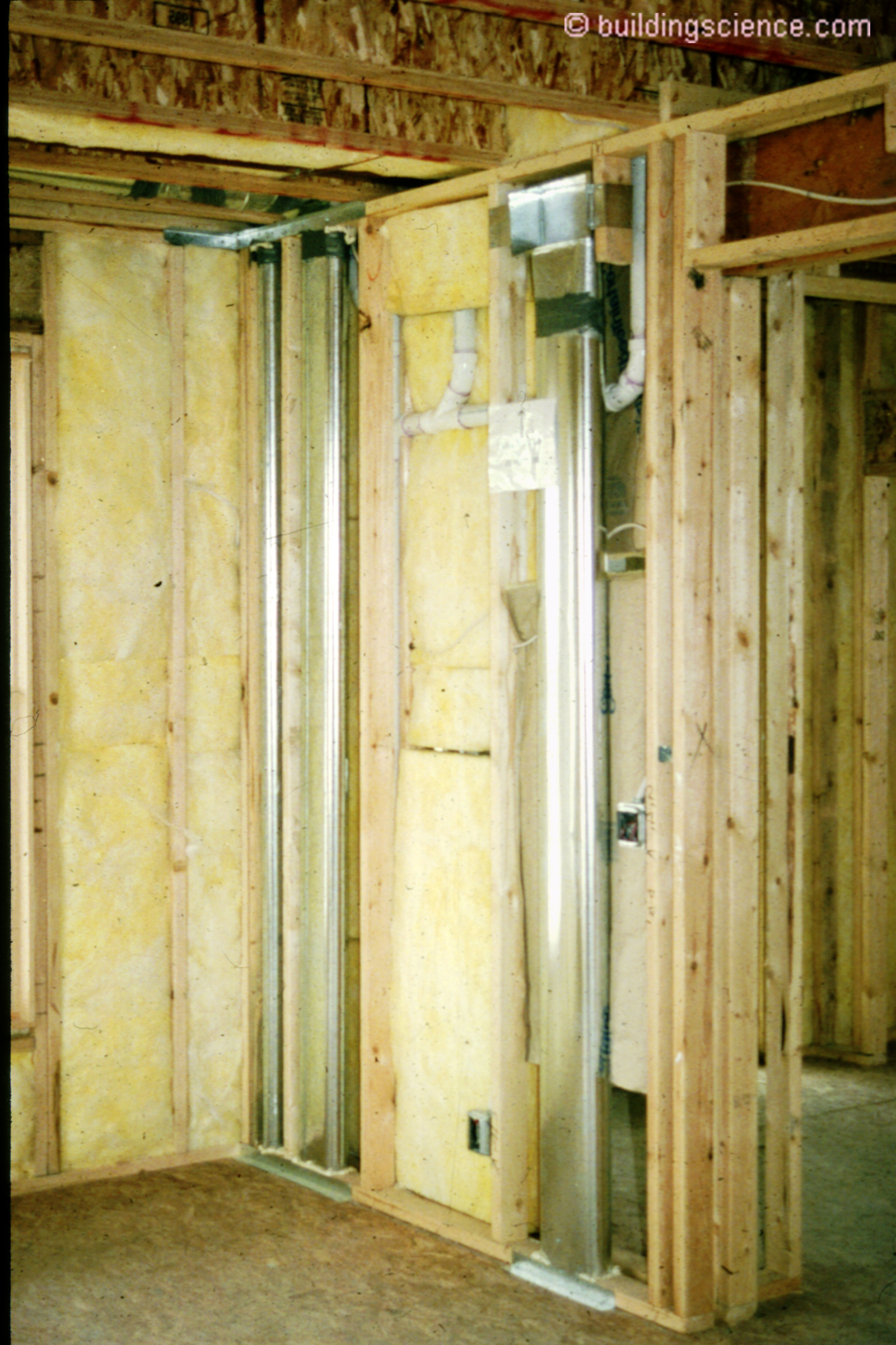

The supply duct and the return duct could be located up high on the same wall a couple of feet apart (Photograph 3).  Short circuiting of flows did not occur because the supply air was “thrown” with a high positive pressure whereas the return had a small negative pressure.  With well insulated walls and ceilings and real good windows, Figure 5 worked in all climates.
Photograph 3:  No Short Circuiting - The supply duct and the return duct could be located up high on the same wall a couple of feet apart.

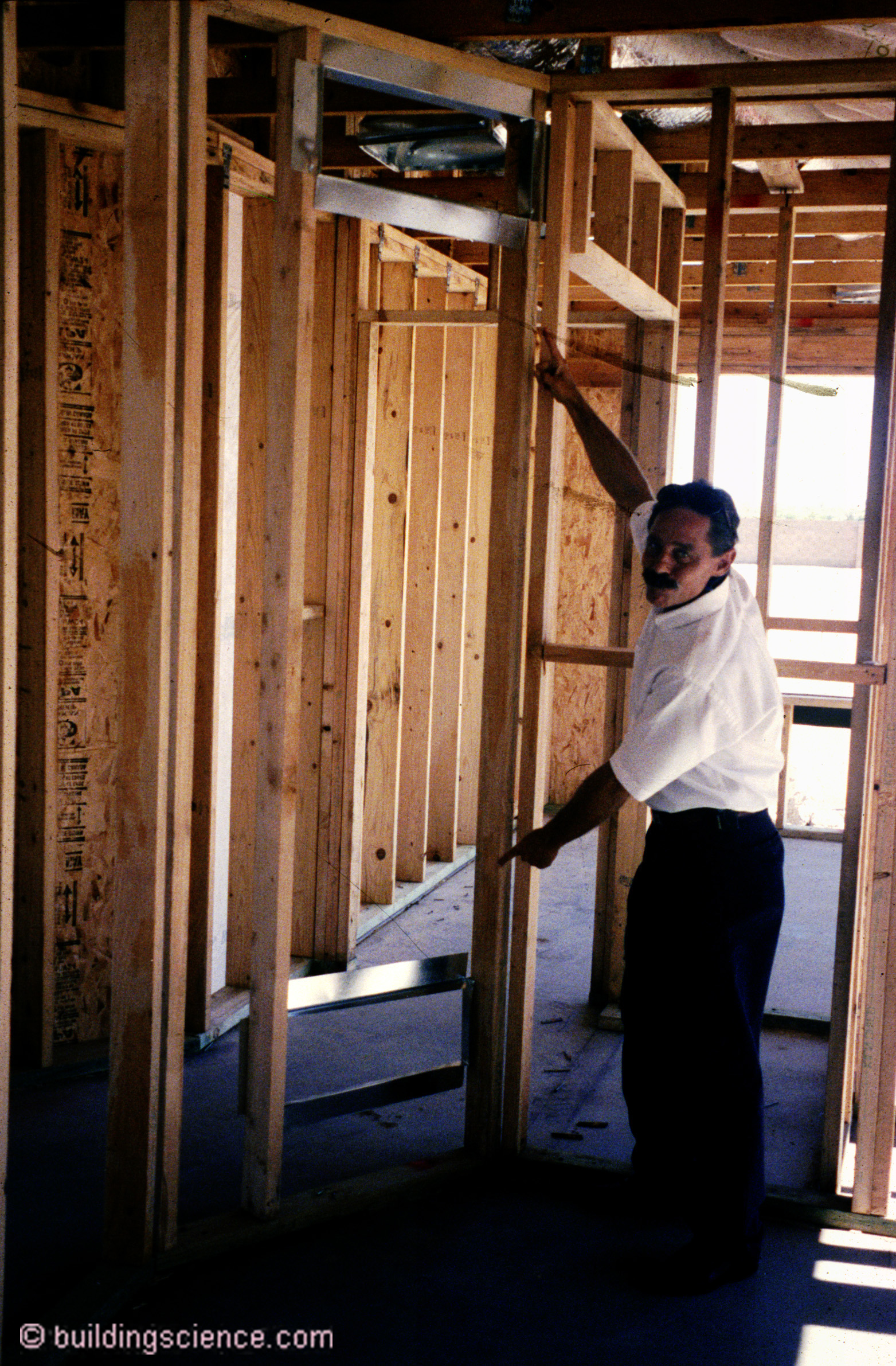

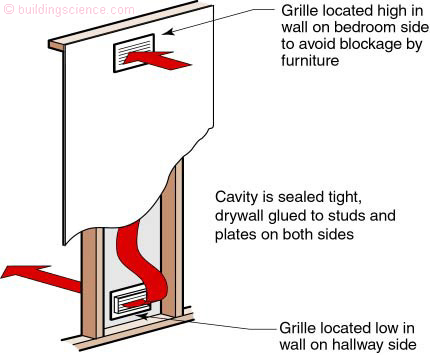

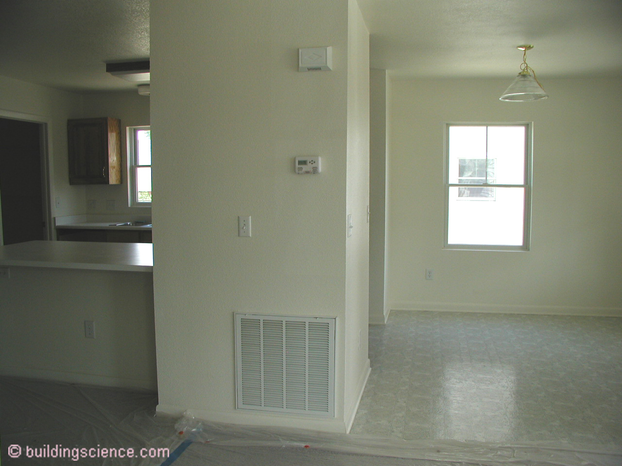

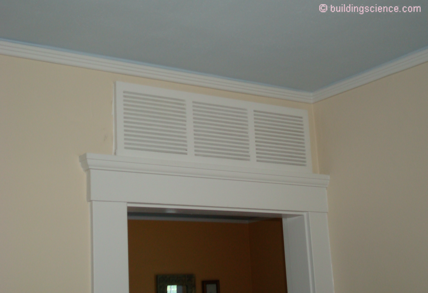

While all of this was going on we started to really look at return systems.  Did we in fact need them in each room?  We discovered “transfer grilles” (Figure 6 and Photograph 4) and “sound attenuated” transom vents that were baffled (Photograph 5) that allowed the hallway and stairwell to act as the return system with a single return hard ducted to the air handler.  What?  Folks freaked out.  A single return…and on the main floor of a two story house…no way that will ever work.  But it did2.
Figure 6:  Transfer Grilles – This approach allowed the hallway and stairwell to act as the return system.
Photograph 4:  Transfer Grilles -  Grille high on one side, low on the opposite side to control light and noise transfer.
Photograph 5:  Transom Vents - “Sound attenuated” by being internally baffled.

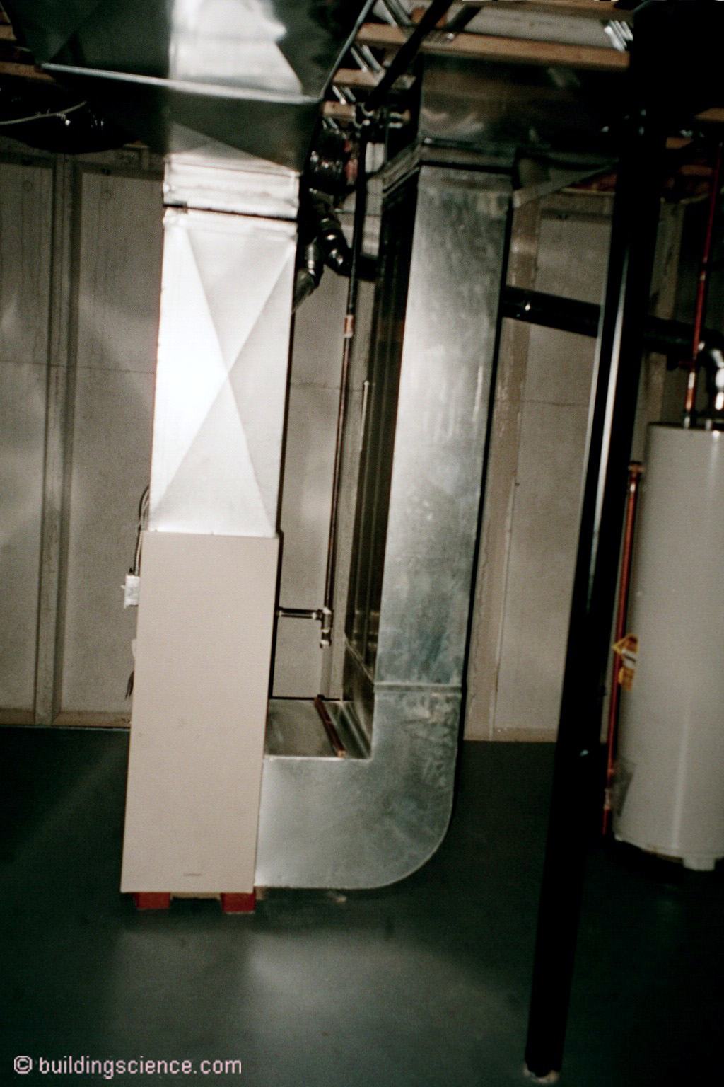

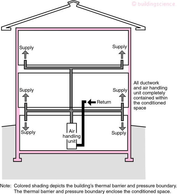

All kinds of options.  Figure 7, Photograph 6 and Photograph 7 show a basement air handler with a single return at the main floor level.  Note that the supply system is fully “hard” ducted.  The single return had an “offset” to handle blower noise.  Folks in cold climates loved it.
Figure 7:  Single Ducted Return - Basement air handler with a single return at the main floor level coupled with transfer grilles.
Photograph 6:  Basement Air Handler - Single hard ducted return.
Photograph 7:  Single Return - The single return at the main floor level has an “offset” to handle blower noise.

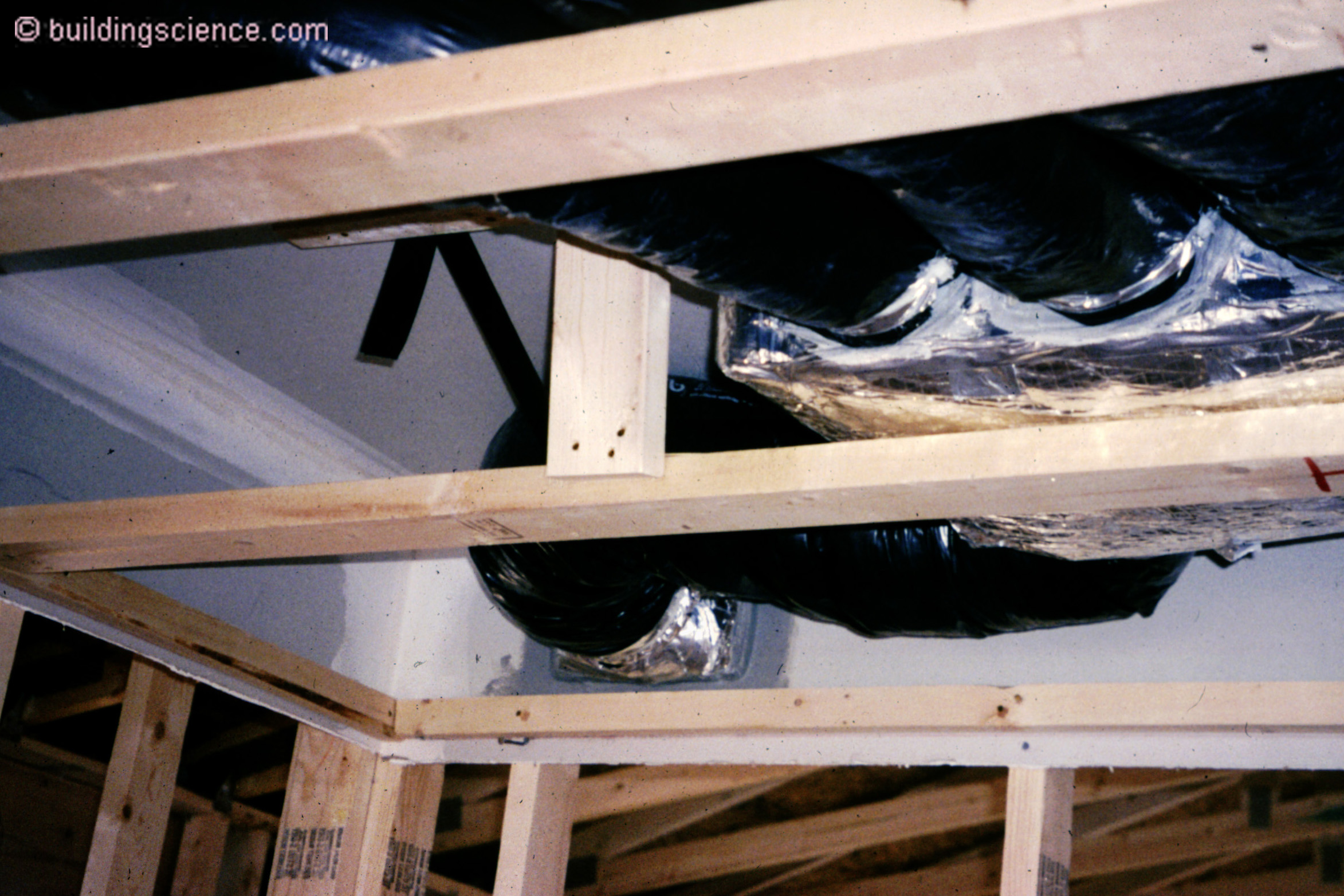

We weren’t done yet.  In cold and hot climates we soon coupled the “throwing the air across the room” from interior located high wall registers with single returns (Figure 10 and Figure 11).  Ductwork could be located in a hallway/corridor dropped ceiling (Photograph 8 and Photograph 9).  The supply and returns could be in the same dropped ceiling.  The returns were “passive” – transfer grilles into the dropped ceiling and a large ceiling register in the corridor dropped ceiling connecting the dropped ceiling to the corridor.  The supplies were “active” hard ducted.  The supply grilles and return grilles shared the same wall (Photograph 10).

Photograph 8: Dropped Ceiling – Ductwork located in a hallway/corridor dropped ceiling. The supply and returns are in the same dropped ceiling.
