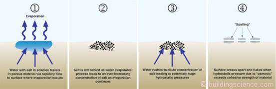

First a little “engineering physics”1 to help us get our arms around salt and water in porous materials. Figure 2 shows water with salt in solution traveling through a porous material by capillary flow to a surface where evaporation occurs. As the capillary water evaporates from the surface the salt is left behind. As water continues to evaporate from the surface this leads to an ever-increasing concentration of salt in the material. This increasing concentration of salt disturbs matters and to re-establish equilibrium water rushes towards the salt to dilute the concentration of salt. This can lead to huge hydrostatic pressures within the porous material. Aficionados (a.k.a. “geeks”) will recognize this as “osmosis.”
![Figure_02](/sites/default/files/resize/migrate/jpg/BSI11_Figure_02-553x179.jpg)
Figure 2: Spalling of porous materials—Without salt present evaporation of water from porous surfaces can often be easily managed—with salt present significant damage can occur.
The forces are not trivial (see below)(2). The osmosis pressures can exceed the cohesive strength of most porous materials and they literally blow apart.

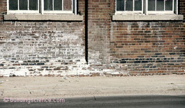

Photograph 1 shows salt on the above-grade exposed surface of a brick foundation. Water carries salt in solution to the surface of the brick where the water evaporates leaving behind the salt on the surface of the brick in the form of salt crystals. The white deposits of mineral salts are called “efflorescence.” When the crystallization of salts happen beneath the surface of the brick-mortar matrix the phenomenon is called “sub surface efflorescence” or “sub-florescence.” If the subflorescence leads to sufficiently strong osmotic pressures—greater than the strength of the brick—and the brick flakes apart the damage is called “spalling.”
Photograph 1: Efflorescence on brick foundation
Figure 3 illustrates the all too common situation at the base of a brick foundation in an old building. The mortar fails near the base of the wall due to sub-efflorescence. The damage is localized near the base of the wall as the capillary water does not travel upward very far as it is easier for it to evaporate inwards rather than travel upwards. If it is prevented from evaporating inwards, the capillary water will travel upwards—again as we shall see.
Figure 3: Efflorescence and spalling brick in foundations—Damage is limited to lower portions of foundation, closest to the source of capillary water and salt.

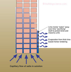

Figure 4 illustrates the elegant solution to the problem of efflorescence, sub-efflorescence and spalling courtesy of a long dead old world mason. The re-pointing of brick with weak lime based mortar was seen to protect the brick from damage. The mortar would “sacrifice” itself to protect the brick. The re-pointing of the brick with “sacrificial” lime mortar over time evolved into applying “sacrificial” coatings over the entire brick surface. The lime-mortar rendering (or “parge coat”) would preferentially attract the capillary salt-water solution and evaporation would happen in this layer not in the brick-masonry assembly. The spalling and damage would be limited to the sacrificial layer. The lime-mortar layer would act like a “poultice” sucking the “salt poison” out of the assembly. The sacrificial layer would eventually fail and fall off—as expected—and would need to be replaced 3 or 4 times a century.
Figure 4: Sacrificial layers—Old world technology at its best. If you can’t stop the damage function, at least concentrate it at a location where you can deal with and within a material you can replace.

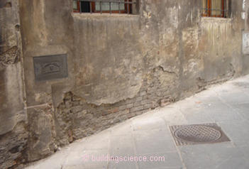

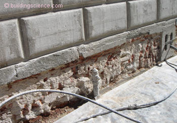

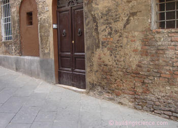

Photograph 2 shows a sacrificial layer failing on the exterior of a foundation wall at grade in the old town of Siena, Italy letting its owners know that it is time to reapply a new sacrificial layer. Photograph 3 shows a new sacrificial layer being applied on a building in the author’s ancestral home of Prague in the Czech Republic. Photograph 4 shows a recently applied sacrificial layer on one side of a doorway—but not yet applied on the other—on a building in Firenze, Italy.
Photograph 2: Spalling of sacrificial layer in Siena, Italy
Photograph 3: Sacrificial layer being applied in Prague, Czech Republic

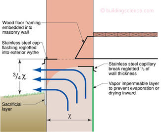

Figure 5 illustrates an approach to address osmosis problems when retrofitting existing brick foundations. A sacrificial layer of lime-based mortar is applied to the exterior of the foundation at grade. An interior liquid water impermeable and vapor impermeable layer is applied to the masonry foundation preventing the capillary water from evaporating to the interior. The capillary water is directed upwards and outwards to the exterior sacrificial layer. The salt accumulates in this layer rather than causing damage to the interior of the foundation. This allows the interior of the masonry foundation to be insulated full height from the slab to the underside of the floor assembly.
![Figure_05](/sites/default/files/resize/migrate/jpg/BSI11_Figure_05-325x475.jpg)
Figure 5: Retrofitting existing brick foundation—Damage function is concentrated on outside surface of foundation at grade in a material designed to be replaced 3 or 4 times a century. Interior membrane sheet waterproofing is designed to prevent inward drying of capillary water—water is directed upwards and outwards.
Here is where things get tricky—we want to direct the capillary water upward and outward—but not too far upward into the structure where it can damage timbers and interior finishes. Figure 6 provides guidance for the protection of embedded timbers in masonry foundations when directing capillary water upward and outward.
