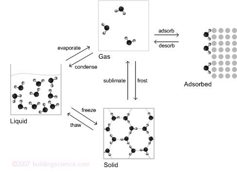

Water, like most materials, exists in liquid, solid, vapor and adsorbed states or phases. Unlike most materials, we experience water in all of its states during our daily lives. Iron and gasoline also exist in all of the states shown in Figure 1, but only at temperatures outside our normal range of experience. Of the states, the adsorbed state is the least understood, and will be described in more detail later.
Moisture, in all its states, is a molecule with two positively charged hydrogen atoms, and one negatively charged oxygen atom (H2O). The molecule is only about 0.3 nanometers in diameter: one billion laid end to end would be about one foot long.
Figure 1: Moisture States and Phase Change Processes

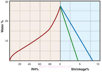

Hence, wetting and drying due to adsorption will cause expansion and contraction in many materials. This explains why wooden doors tend to be tight in the humid summer and loose-fitting in the dry winter. Differential moisture-related expansion and contraction also explains cupping in woods and slab curl in concrete.
Figure 5: The moisture content vs. RH and shrinkage vs. MC of a typical wood
Figure 5: The moisture content versus RH and shrinkage versus MC of a typical wood
