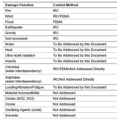

The following is a list of the key damage functions affecting durability (presently known and understood):
Table 2: Damage Functions and Control Methods
From this listing of damage functions the first six are fire, structural and natural disaster in nature and are arguably addressed extremely well by the existing model building code (IRC) and FEMA. They will not be addressed further in this document beyond the following:  “Follow the IRC building code and FEMA recommendations and your fire related, structural related or disaster related durability problems will not be completely eliminated but will be reduced to an acceptable level.” Acceptable level is of course open to discussion. A criteria of note is the recent experience with the three hurricanes that hit Orlando, FL in a 45 day period in August – September, 2004 (Hurricanes Charley, Frances and Jeanne). No one died, no roofs were lost, no facades were destroyed, no significant structural damage of any kind occurred to structures (homes in particular) constructed after the code changes implemented in 2001 (that are mirrored in the IRC). There was no call for building code changes from the insurance industry or from consumers regarding structural issues. The term “acceptable level” of problems appears appropriate.
The next 4 (water, heat, ultra-violet radiation and insects) are the main focus of this document and arguably address more than 90 percent of current industry durability issues.
Chlorides and sulphates are also arguably addressed extremely well by both the IRC and FEMA (Coastal Construction Manual). The risks associated with both of these damage functions are also dependent on water and therefore addressing the water damage function further reduces the risks associated with chlorides and sulphates. They will not be addressed further in this document beyond the following:  “Follow the IRC building code and the FEMA recommendations (and the water damage function control methods) and you will not have chloride and sulphate related durability problems.”
Loading/abrasion/fatigue is also addressed in this document with the following limitations. This damage function is arguably a maintenance issue associated with “wear and tear.” It is also typically the purview of durability standards and risk assessment protocols for the developers and manufacturers of materials, components and equipment. It is not typically the purview of designers, engineers, architects and contractors except in the following context.
Many components will need to be replaced, serviced and maintained during the useful service life of the building. The ease of replacement, service and maintenance is within the purview of designers, engineers, architects and contractors. The building components that experience the greatest loading/abrasion/fatigue stress and that need regular replacement or maintenance or servicing are typically floor coverings – and their selection is within the purview of designers, engineers, architects and contractors.
The remaining damage functions (material incompatibility, oxides, ozone, oxidizing agents and solvents) are also not addressed. It is argued here that they are not significant enough issues to consider at this point in time for inclusion in a “practical” durability standard or risk assessment protocol for use by designers, engineers, architects and contractors. However, these damage functions are key to durability standards and risk assessment protocols for the developers and manufacturers of materials, components and equipment.
The four key non-structural or natural disaster damage functions of water, heat, ultra-violet radiation and insects will be discussed in terms of specific guidance and recommendations applicable to designers, engineers, architects and contractors. Additional discussion on the loading/abrasion/fatigue damage function within the context of replacement, servicing and maintenance will also be discussed.

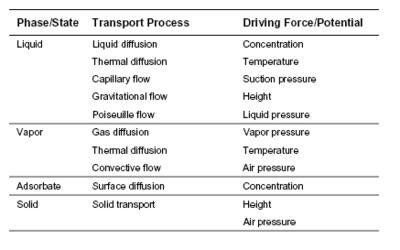

The phases (state), transport process or mechanisms and driving forces or potentials for water are listed below:
Table 3: Water – Transport Processes, Driving Forces and Potentials
The list in Table 3 is complete and captures the universe of phases and transport processes.  Several of the processes are truly academic – thermal diffusion, Poiseuille flow and surface diffusion can be ignored and 99.9 percent of the mechanisms are captured.

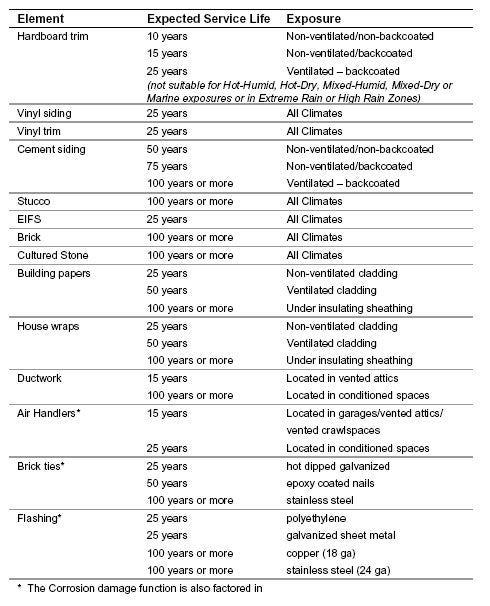

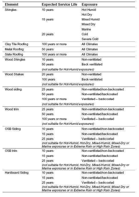

The temperature of critical building enclosure elements can be used to assess the durability of those elements and the durability of the assembly.
The following is a list of building enclosure elements, expected service life and exposure.  It is based on generic materials and past experience. Although the list is based on the heat damage function it includes the synergistic effects of ultra-violet radiation and water as these damage functions are not possible to separate or isolate in practice and are obviously part of the historical experience basis.
Table 5: Expected Service Life of Building Elements
Table 5 (continued): Expected Service Life of Building Elements
This list of building enclosure elements, expected service life and exposure should be the basis of a durability standard or risk assessment protocol that addresses the heat damage function (the synergistic effects of ultra-violet radiation damage function and the water damage function are included in this table).
A rating or points should be added or subtracted based on extending the expected service life of an element. Approaches that are not listed in the table can be evaluated using the Arrhenius engineering approximation or by accelerated lab testing (UV Arc, salt spray).
A baseline for each location can be established and should be the typical building constructed in a particular region. For example, consider a building constructed in Dallas, TX, which is a Mixed Humid Climate. The standard building is typically constructed with asphalt singles on the roof (10 year expected service life), vinyl siding on the walls (25 year expected service life) installed over a building paper (50 expected service life – vinyl siding is by definition a “ventilated” cladding).
If the vinyl siding is replaced with brick (100 year expected service life), the shingles replaced with slate (100 year expected service life) and the building paper covered with insulating sheathing (the building paper now has a 100 year expected service life) the building now can be considered “permanent” and therefore receive the highest durability rating or sustainability rating possible or have the lowest applicable risk.
Another example would be using a “cool roof shingle” in a Hot-Humid climate like Houston that reduces the temperature of the shingle by 20 degrees will increase the service life of the single by a factor of 2 from 10 years to 20 years. An obvious increase in rating or addition of points would be warranted in addition to the huge reduction in solar load and consequential increase in energy efficiency.
Points should be deducted and ratings reduced where longer life materials enclose or cover shorter life elements. For example, using a 100-year cladding system with 25-year ties over a 50-year housewrap should not be encouraged.

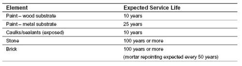

Most sealant service lives are limited to 10 years due to ultra-violet radiation exposure.
The following is a list of building enclosure elements and expected service life is based on generic materials and past experience.
Table 6: Expected Service Life of Building Elements Exposed to Ultra-Violet Radiation
This list of building enclosure elements and expected service life should be the basis of a durability standard or risk assessment protocol that addresses the ultra-violet radiation damage function.

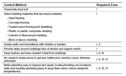

Insects
Insects don’t behave according to Arrhenius. Food, water and habitat are the key elements for insects.
The key to insect control historically has been two pronged:  chemical warfare and dealing with the food source:  poison and kill them and don’t construct assemblies with materials that insects can eat or poison the materials so that the insects don’t eat them.
More recently has been the realization that denying the insects water and a habitat are also significant. For example, insects don’t eat foam based insulating sheathings but they sure do like living in them. Foam insulation is an excellent habitat if it is made accessible such as extending it into the ground.
Keeping materials dry also discourages insect infestation, but by itself that is not enough as insects can bring their own water with them (termite “tubes” provide a friendly micro-climate or habitat and a source of humidified air).
The insect damage function and insect control methods in buildings are based on the following factors:
  • chemical treatment of soil;
  • insect resistant building materials;
  • control of habitat;
  • control of water.
A degree of risk should be associated with location. In other words, the location establishes an “insect load” and the assembly or building should be designed and constructed the “resist the load”. The greater the “load” the greater the “load resistance” required.
The insect load should be based on historical experience such as Figure R301.2 (6) from the 2003 International Residential Code. The United States is broken down into four termite infestation probability zones:  Very Heavy (I), Moderate to Heavy (II), Slight to Moderate (III) and None to Slight (IV).
Using the concept of infestation probability zones and a list of insect control methods a set of minimum requirements can be established per zone. For example, all of the methods would be required in the Very Heavy zone and most of the requirements would be waived in the None to Slight zone. In the other zones a mix of methods would be required.
The following list of control methods is based on these factors and the degree of risk or termite infestation probability.
Table 7: Insect Control Methods by Termite Zone
This list of insect control methods should be the basis of a durability standard or risk assessment protocol that addresses the insect damage function.

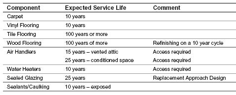

Floor covering service life is directly related to loading/abrasion/fatigue and clearly floor-covering selection is within the purview of designers, engineers, architects and contractors.  With respect to floor coverings carpets should be assessed a 10-year useful service life and wood flooring and tile can be assessed a 100 year or greater useful service life depending on exposure. For example, wood flooring in the entrance lobby of an office building will not last 100 years, but can last 100 years in a bedroom. Porcelain tile is more resistant than ceramic tile and granite the most resistant of all.
The following is a list of building components subject to typical “wear and tear” replacement, maintenance and servicing issues and their expected service life:
Table 8: Expected Service Life of Heavy Use Building Components
This list of building components and expected service life should be the basis of a durability standard or risk assessment protocol that addresses the loading/abrasion/fatigue damage function.
A rating or points should be added or subtracted based on extending the expected service life of an element such as a floor covering.
Points should be deducted and ratings reduced where provision for access for serving or replacement is not provided.
In terms of sealants or caulking, points should be added or ratings increased for designs that do not rely on sealants or caulking.

Step One:Follow IRC and FEMA guidance
Step Two:Use Table 4 to address the water damage function
Step Three:Use Table 5 to address the heat damage function
Step Four:Use Table 6 to address the ultra-violet radiation damage function
Step Five:Use Table 7 to address the insect damage function
Step Six:Use Table 8 to address replacement/maintenance and servicing
Specific numerical values for ranking purposes have not been assigned to the contents of Table 5, Table 6 and Table 8. The service life of the components is listed but the “value” of increasing or decreasing the service life has not been assessed nor has a “value” for service ease or cost been assessed. It is left to the individual user to determine these “values.”

Step Three – Use Table 5 To Address The Heat Damage Function
The heat damage function is addressed by selecting the component and associated expected service life.
Step Four – Use Table 6 To Address The Ultra-Violet Radiation Damage Function
The ultra-violet radiation damage function is addressed by selecting the component and associated expected service life.
Step Five – Use Table 7 To Address The Insect Damage Function
The insect damage function is addressed by following the mandatory requirements in each insect infestation probability zone. This is not an optional step.
Step Six – Use Table 8 To Address Replacement/Maintenance and Servicing
Replacement, maintenance and servicing are addressed by selecting the component and associated expected service life.
