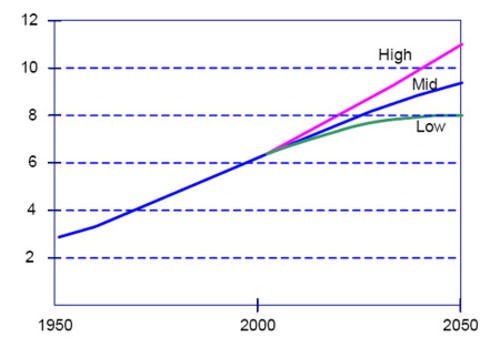

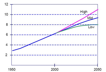

The world’s population continues to grow, and grow fastest in the developing world. The population has more than doubled in the last forty years to over 6 billion people. The good news is that the rate of population increase is projected to decrease, and if we continue efforts on population control, we may be able to keep the peak population (which will be reached around 2050) of the world under 9 billion (Figure 1).
Figure 1: World Population Projections (UN Population Division)

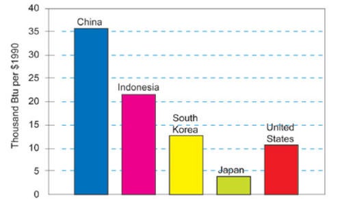

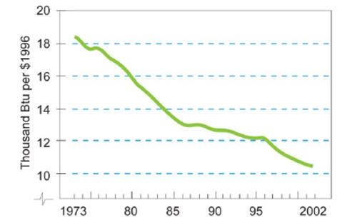

The developed world, and North America in particular, is unfortunately not reducing its per capita energy or resource use. Despite much more knowledge and incredibly powerful technology, our buildings’ energy consumption continues to grow with time. For example, consider Figure 2, a plot of the actual measured energy use of thousands of commercial buildings across the United States in the year 2000 (from the Energy Information Agency). The buildings that use the least energy are the oldest buildings, and a clear trend can be seen toward higher energy consumption for new buildings. Knowledge and technology is obviously not sufficient to provide a solution. The use of energy per capita in the United States has been constant since about 1970. However, the good news is that the energy use per unit GDP in the United States has been dropping. Other developed countries (such as Japan and Germany) have shown that the energy density can be much lower, but developing countries such as China and Indonesia need to become much more efficient.
Figure 2: American Energy Intensity per Unit GDP since 1973 (Source Economist, EIA)
Figure 3: 2001 Energy Intensity per Unit GDP (Source EIA)

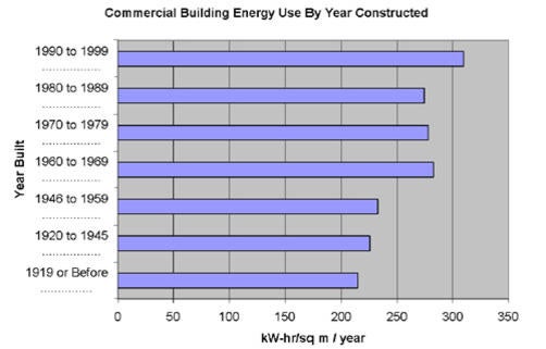

Buildings operations consume more than 2/3 of all electricity and about 40% of all resources.
The solutions, like the problems, are complex and multi-disciplinary. Building professionals have a unique potential to make a significant contribution to the solutions, since they are the best prepared to deal with this complex socio-techno-economic problem. Better technology will help, but more will be achieved by changing the way we work, design, travel, build, and live.
Figure 4: Year 2000 Energy Consumption of Commercial US Buildings as a Function of Year Built
