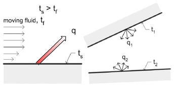

Convection is the transfer of heat by the movement or flow of molecules (liquid or gas) with a change in their heat content. This is an important heat transfer mode between fluids and solids, or within fluids.
Radiation is the transfer of heat by electromagnetic waves through a gas or vacuum. Heat transfer by this mode therefore requires a line of sight connection between the surfaces involved.  All objects above absolute zero radiate heat energy; it is the net radiative heat transfer that is the heat transfer of interest. Radiation is mostly of importance for heat transfer between solids and within highly porous solids, but radiation between high-temperature gases is occasionally of practical importance.
State change, sometimes called phase change, occurs at a constant temperature but still entails the movement of energy. For example, evaporation absorbs energy and condensation releases energy. This  energy is sometimes called latent heat.
The mode of heat transfer often changes during the process of heat flow through and within building systems. For example, the sun transmits heat by radiation to the earth, where it can be absorbed, for example, by a brick wall. The heat is then transferred by conduction through the brick and transferred to the indoor air by convection and to the indoor surfaces by radiation.
Figure 2: Convection and radiation
