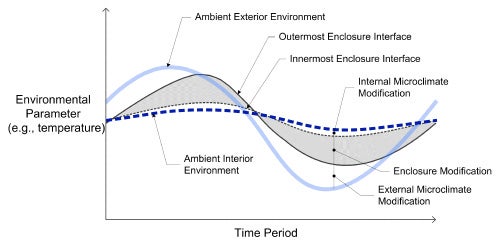

Figure 2 indicates that, while the building enclosure separates the interior and exterior environments, it really experiences several microclimates. The enclosure interacts with both environments and, in turn, affects both environments. This interaction is usually dependent on the time of day, the day of the week, and the season. There is thus a cyclical (diurnal, workday/non-workday, weekly and seasonal) aspect to the time-dependent response of the enclosure as it separates and, to some degree, modifies the influence of both environments.
Figure 2: Contributors to environmental modification
While the enclosure may be the largest modifier, the difference or the modification between the ambient and interface conditions can also be significant. Note that the scale of Figure 2 will be different for different parameters. Moreover, this simple representation of variation over one cycle of time for one parameter does not accurately or fully represent the complex behavior and interactions that occur.

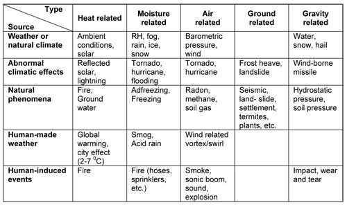

The exterior environment described above is responsible for many different loadings. Sources of these loadings are the climate (weather over the short term), human or human-made effects, and nature or natural phenomena. Table 1 identifies, by type and source, those loadings due to the exterior environment that could affect the enclosure.  It should be evident from this list of loadings that the design or analysis of the enclosure involves consideration of not only the usual structural loadings but also mass (air, moisture, etc.) and energy (heat, light, sound, etc.) loadings. Moreover, for design purposes, we need to have some knowledge of both average and extreme conditions for each relevant loading.
Table 1: Loadings from the exterior environment

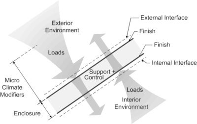

Figure 3 illustrates a representative portion of a building enclosure, its functions and the nature of the loadings. The enclosure may also serve other, usually non-physical, purposes such as advertising or as a symbol or image, e.g., as a statement about power or security or wealth, etc., but these are not considered here.
Figure 3: The enclosure and its functions

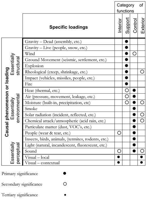

Each and every part of the enclosure must satisfy the relevant support, control, finish and distribution functions. Only the support and control functions are needed everywhere. The finish functions may not be needed in some areas (such as above suspended ceilings, in service rooms).  Moreover the distribution functions, which largely service the adjacent interior spaces, need to be met only where there is a service or utility to be distributed – large segments of most enclosures do not need to fulfill this function.
To further demonstrate the relationship between category of function and loading, consider Table 4.  All the possibly relevant loadings are listed and their functional relevance is identified. This table is important because it clearly shows that the number of loadings is considerable and that each loading affects at least one functional sub-category for the enclosure and often more than one.
Table 4: General category of loadings and related functions
