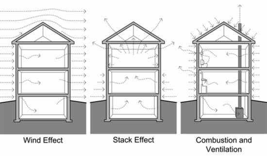

Driving Forces
There are three primary mechanisms which generate the pressure differences required for air flow within and through buildings (see Figure 1 below):
  1. wind,
  2. stack effect or bouyancy, and
  3. mechanical air handling equipment and appliances.
Since, it is widely acknowledged that a perfectly airtight air barrier system is unlikely to be achieved in practise, it is also desirable to control the air pressure differences driving the flow. This typically means reducing the pressure imbalance created by HVAC systems, reducing stack effect pressures by compartmentalizing buildings vertically, and reducing wind pressures by compartmentalizing building plans.
A short review of the three types of forces driving airflow is presented below.
Wind

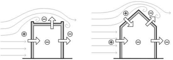

Wind forces act on all buildings, typically creating a positive pressure on the windward face and negative (suction) pressures on the walls. Bernoulli's equation can be used to calculate the pressure imposed on a building as function of wind speed. The stagnation pressure is defined as the pressure exerted by a flow decelerated to zero speed, and is given by:
    Pstag =   1/2.   r .   V2 @ 0.65 · V2             [1]
    where r is the air density [kg/m3], approximately 1.3 kg/m3 at 0 C
    and
    V the wind velocity [m/s]
The pressure calculated from Equation 1 is not directly what is imposed on a building, and so a pressure coefficient is introduced to modify the stagnation pressure as:
    P = Cp · Pstag             [2]
This pressure coefficient can be found for simple buildings in numerous references and ranges from a typical value of Cp = 0.7 to 0.8 on the windward side to Cp = -0.3 to -0.5 on the leeward.  Local pressure coefficients around parapets, under glancing wind directions, and other turbulent flow conditions are often much larger, e.g., Cp = +3 to -5.  Interior pressure coefficients range from -0.3 to -1.0, and the arithmetic sum is the net pressure acting across the enclosure.  A concise summary of typical pressure coefficients can be found in Chapter 14 of the ASHRAE Handbook of Fundamentals [ASHRAE 1997].
Figure 1
: Forces Driving Air Flow through Building Enclosures
Low-slope roofs tend to have mostly negative (uplift) pressures, especially on the leading edge (Figure 2). Roofs with slopes above about 25 degrees experience positive pressures on the windward face, and suctions on the leeward.
Figure 2: Wind Pressure Effects on Representative Buildings

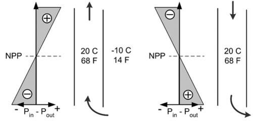

Stack Effect
Stack effect pressures are generated by differences in air density with temperature, i.e. hot air rises and cold air sinks. The air within a building during the wintertime acts like a bubble of hot air in a sea of cold air. In the summertime the situation is reversed, although air temperature differences are usually less.
The density of dry air, ra, varies with temperature. The greater the height of a column of air, the greater the potential difference in pressure if that column is at a different temperature. The pressure difference generated by a column of air h meters high with temperature difference between indoor and outdoor air at standard temperature and pressure is approximately:
For example, if the air in a one meter high cylinder, open at the bottom and containing room temperature air (20 °C) is taken into the outdoors at a temperature of -10 °C, an outward pressure of 1.34 Pa would act at the top (Figure 3). The pressure at the bottom must be zero since it is connected to the outdoors. The horizontal plane at which the pressure equals the outdoor pressure (i.e. the difference is zero) is called the Neutral Pressure Plane (NPP).
Figure 3:  Pressure in Open-Ended Cylinder Due to Buoyancy
If the cylinder remained outdoors, the air it contained would slowly cool down to the exterior temperature and no pressure difference would exist. If the cylinder were then inverted and brought back indoors, the pressure at the closed end of the cylinder would again be 1.34 Pa acting outward as the cold air fell downward relative to the indoor air.

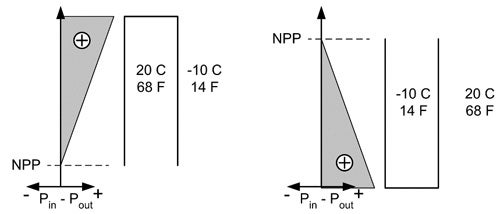

In the above examples, no flow occurred because no flow path was provided. If an open-ended cylinder containing room temperature air where used, any temperature difference between the cylinder and the surrounding air would cause flow, and the warm air would be immediately removed and replaced with cool outdoor air. However, if a heating coil were added to the cylinder to maintain the air temperature at 20 °C, airflow in the bottom would be heated. This is analogous to a heated building.  Friction would slow air flow and result in a constant pressure drop along the height of the cylinder. Note that the NPP would now be located at mid-height and that air flow is involved (Figure 4).  Obviously, the less air flowing through this cylinder the less heat energy required to maintain the interior of the cylinder at 20 °C.
Figure 4: Flow through a heated or cooling cylinder or building
 (Left) Floors leakier than walls: building acts like a perforated tub
(Right)  Top leakier than bottom: NPP rise

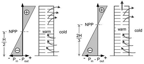

Figure 5: Stack Effect in Real Buildings

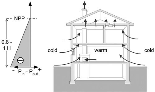

Although houses tend to be only 3 to 9 m (9 to 27 feet) tall, stack effect can be a major force driving airflow, particularly in climates with a large temperature difference (more than 25 °C / 40 °F) across the enclosure. Often the exhaust of chimneys and fans, as well as leaky ceiling planes result in a Neutral Pressure Plane located near the ceiling level (Figure 6).
Figure 6: Stack effect during cold weather in a house
In warm climates and during warm weather, stack effect reverses and air is often drawn in at the top and pushed out at the bottom.  Infiltration of warm moist air in warm weather can cause as many problems as exfiltration of warm moist air in the winter.

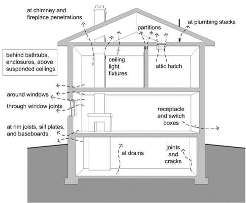

  1. Continuity.  This is the most important and most difficult requirement. Enclosures are 3-D systems! ABS continuity must be ensured through doors, windows, penetrations, around corners, at floor lines, soffits, etc.
  2. Strength.  If the ABS is, as designed, much less air permeable than the remainder of the enclosure assembly, then it must also be designed to transfer the full design wind load (e.g., the 1-in-30 year gust) to the structural system. Fastenings can often be critical, especially for flexible non-adhered membrane systems.
  3. Durability. The ABS must continue to perform for its service life. Therefore, the ease of repair and replacement, the imposed stresses and material resistance to movement, fatigue, temperature, etc. are all considerations.
  4. Stiffness. The stiffness of the ABS (including fastening methods) must reduce or eliminate deflections to control air movement into the enclosure by pumping. The ABS must also be stiff enough that deformations do not change the air permeance (e.g., by stretching holes around fasteners) and/or distribute loads through unintentional load paths.
  5. Impermeability.  Naturally, the ABS must be impermeable to air. Typical recommended air permeability values are less than about 1.3 x 10-6 m3/m2/Pa. However air barrier materials are commonly defined as materials which pass less than Q2 @75 Pa. Although this is an easy property to measure it is not as important as might be thought. In practise, the ability to achieve other requirements (especially continuity) are more important to performance, and the air “permeance” of joints, cracks, and penetrations outweighs the air permeance of the solid materials that make up most of the area of the ABS. Hence, a component should have an air leakage rate of less than Q2 @75 Pa, and the whole building system should leak less than Q2 @75 Pa.
Figure 7:  Typical air leakage paths.

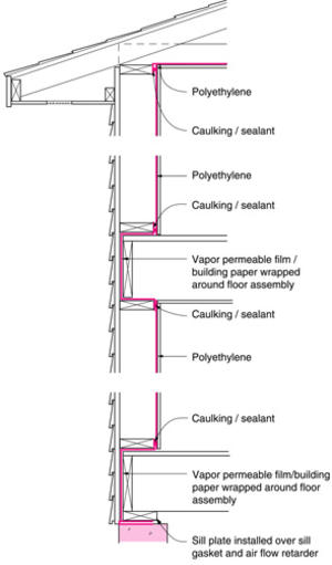

Common Air Barrier Systems
A sheet of 6 mille (0.15 mm) thick polyethylene is often used as a vapor barrier in very cold climates (Zones 6 and 7).  Poly is cheap to buy and install and has very low vapor permeance.  However, it fails or barely meets most air barrier requirements other than air impermeability. It is difficult and relatively expensive to achieve continuity, especially since it is pierced by services and enclosure penetrations at many locations. It is likely to fail structurally when exposed to wind gust loads, and can fail through fatigue if it flaps because of varying wind pressures. Hence, it is not very durable. It is so flexible that it can deform and transfer loads through unexpected paths, deform batt insulation, tear fastenings, pump air, etc. Nevertheless, for undemanding applications such as low-rise housing, poly may act as both the vapor barrier and the air barrier. Poly on the interior should not be used in air conditioned buildings in Zones 5 or lower as its low vapor permeance poses an unacceptable risk of interstitial condensation during warm weather.

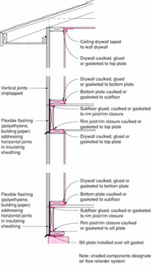

The airtight drywall approach (ADA) employs the interior layer of painted drywall as part of the ABS and poly, vinyl wall paper, or an appropriate type of paint as the vapor control layer. The drywall is stiff and strong enough for most applications and because it is visible, it is easy to inspect, repair, and to ensure continuity. Difficulty in achieving continuity is often encountered at service penetrations, wall-floor interfaces, intersection walls, transitions, partition walls, etc. Despite these difficulties, with a little care and training the ADA air barrier system is often quite successful and can be used in a wide-range of steel and wood framed roof and wall systems in both residential and commercial construction.
The vapor barrier and air barrier are often separated in enclosures employing housewraps or exterior sheathing (e.g., well sealed exterior gypsum, plywood, or OSB) as the primary air barrier.  Poly, foil-backed drywall (in very cold climates), or paint is installed near the interior and acts as the vapor barrier. The advantage of such exterior air barriers is that they are often easier to install in such a manner as to span over all of the many interior service penetrations, plumbing, structural components, etc.
Another approach to exterior air barriers is the use of air impermeable, usually foam plastic or foil-faced, rigid insulation boards with sheathing tape and/or gaskets at joints. Such systems have the advantage of fewer penetrations, but the disadvantage that they are difficult to inspect and repair.  The ability of these systems, including their joints, to transfer wind loads through connectors to the structural frame must be investigated for each application.
Spray foam, open-celled or closed-cell can be used as a very effective part of an air barrier system. When applied to the exterior of blockwork or sheathing, they form a continuous fully-adhered system. Transitions, movement joints, and penetrations require careful detailing to ensure airtightness. When the foam is sprayed within a stud cavity, much more effort is required to seal the joint between the floor sheathing and bottom plate, top plate to rim joist (often spray foam), etc.
Reinforced concrete is usually sufficiently airtight to form part of an ABS so long as the concrete is dense and crack size and spacing are controlled by the appropriate use of reinforcing (standard spacings used in reinforced concrete design are sufficient). Blockwork is not generally sufficiently impermeable to act as an air barrier.  Small shrinkage cracks further compromise its airtightness. The application of a thick layer of block paint, or a thin layer of parging, preferably with fibres to limit crack sizes, renders blockwork walls airtight.
In commercial applications, bitumen-based air barriers, in either liquid or reinforced membrane form, are often adhered to the exterior of blockwork, concrete, or exterior gypsum sheathing. To ensure continuity, compatible membranes are used to bridge cracks and tie the ABS to windows, etc. This type of air barrier tends to be very vapor impermeable and so also acts as a vapor barrier. Therefore, the majority of the insulation must be applied outside of such an ABS in cold climates.
Polymer-modified and fibre-reinforced thin plasters are also available as air barriers. These systems require flexible joint details around penetrations, but are non-combustible and may be as vapor permeable or impermeable as specified. A variety of heavy-duty elastomeric liquid-applied air barrier membranes are also available. These products can have a range of vapor permeance values (from very impermeable to very permeable).  With the appropriate analysis, they can be placed anywhere in an enclosure and used in all climates.
In framed systems, two air barrier systems, one inside and one outside of the framing, are often desirable, with framing members consciously designed as in-plane compartment separators to resist the internal lateral flows generated by wind pressures (Figure 8). Such redundancy is needed because of the susceptibility of these systems to wind washing, ABS failure, convective loops, and other airflow control problems.
Figure 8: Airtight Drywall Approach applied to a wood-framed enclosure

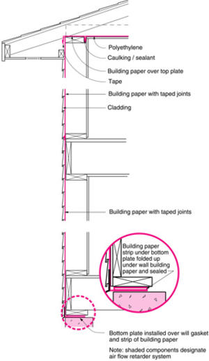

Figure 9: Housewrap air barrier system
Figure 10: Polyethylene air barrier system (very cold climates only—Zones 6 or higher)

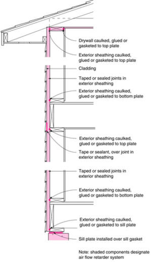

Figure 11:  Exterior sheathing (insulated or not) air barrier system
