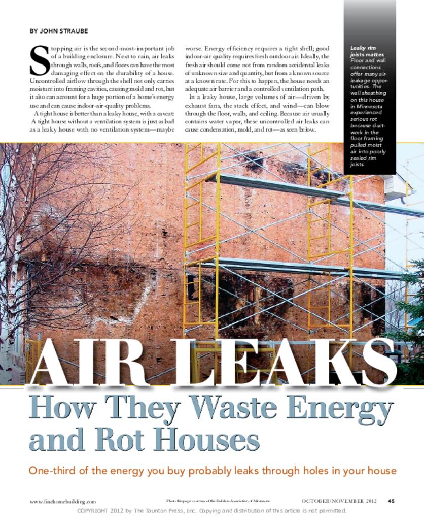

In a leaky house, large volumes of air—driven by exhaust fans, the stack effect, and wind—can blow through the floor, walls, and ceiling. because air usually contains water vapor, these uncontrolled air leaks can cause condensation, mold, and rot—as seen below.
Leaky rim joists matter. Floor and wall connections offer many airleakage opportunities. The wall sheathing on this house in Minnesota experienced serious rot because ductwork in the floor framing pulled moist air into poorly sealed rim joists.
