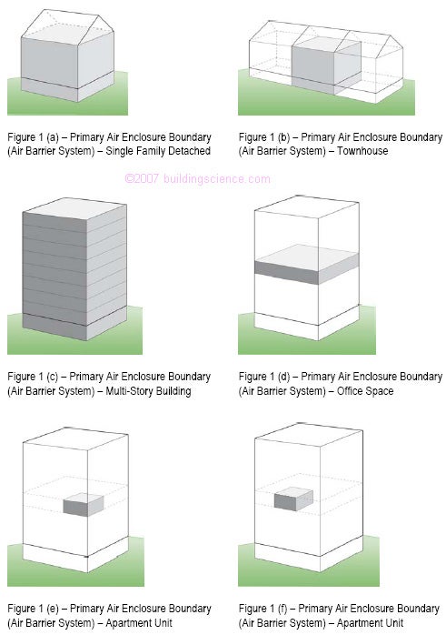

Typical configurations of air barrier system enclosures are illustrated in Figure 1.
Figure_01

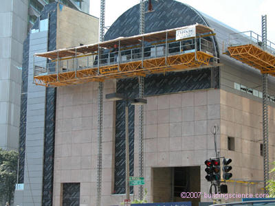

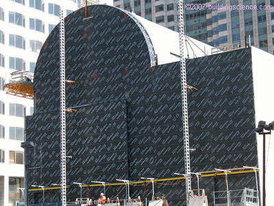

Photo_01: Exterior air barrier using adhered membrane (note the air barrier continuity where the wall meets the roof)
Photograph 1:
Exterior Air Barrier Using Adhered Membrane
(Note the air barrier continuity where the wall meets the roof)
Photo_02: Exterior air barrier using adhered membrane (note the rigid insulation installed on the exterior of the air barrier system)
Photograph 2
:  Exterior Air Barrier Using Adhered Membrane
(Note the rigid insulation installed on the exterior of the air barrier system)

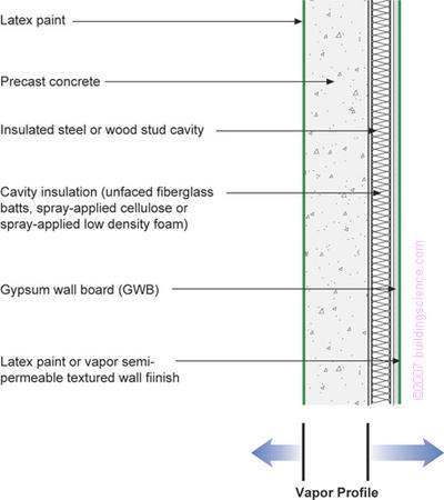

Figure_03: Exterior air barrier using precast/site cast concrete
Figure 3:  Exterior Air Barrier Using Precast/Site Cast Concrete

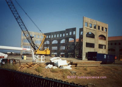

Photo_03
Photograph 3

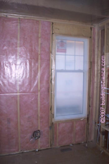

Photo_05: Interior air barrier using polyethylene sheet
Photograph 5:  Interior Air Barrier Using Polyethylene Sheet

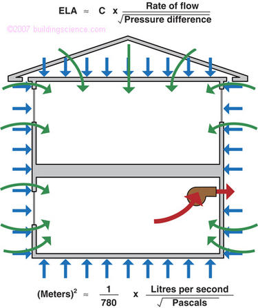

Both approaches involve creating an air pressure difference using a known airflow rate.  Photograph 7 shows the use of a portable fan to extract air from an enclosure or compartment creating a pressure difference. Applying a simple mass balance and a power law relationship yields the familiar leakage curve (Figure 9, Figure 10 and Figure 11). Normalizing provides air permeance values for the enclosure or compartment.
Figure_09: Enclosure mass balance (mass flow rate out equals mass flow rate in)
Figure 9:  Enclosure Mass Balance
(Mass flow rate out equals mass flow rate in)

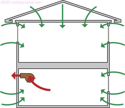

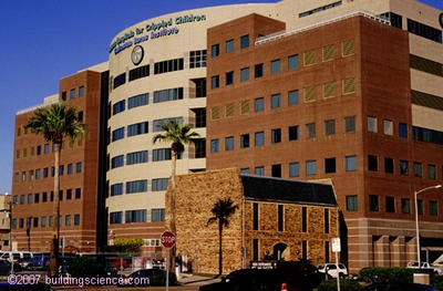

The air permeance of the building enclosure for the large facility shown in Photograph 8 was determined using the second approach. The buildings internal fans were configured as per CAN/CGSB-149.15-96 (Figure 12) to create a series of air pressure differences that were measured using a multi-channel digital manometer (Photograph 9 and Figure 13). A CONTAM model (Walton, 1997) representative of the building was created and the air permeance values of the model were adjusted until the air pressure response of the model matched the measured air pressure response of the building (Figure 14 and Figure 15).

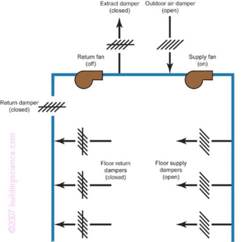

Figure_12: Pressure fans
Figure 12:  Pressurization Using Buildings Internal Fans

Photo_08: Large facility testing—"Blower door" approach on steroids (facilities’ internal fans used to create pressure difference)
Photograph 8
:  Large Facility Testing - “Blower Door” approach on steroids
(Facilities internal fans used to create pressure difference)

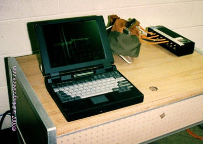

Photo_09: Multi-channel digital manometer (interior to exterior and interzonal pressures are measured)
Photograph 9:  Multi-Channel Digital Manometer
(Interior to exterior and inter-zonal pressures are measured)

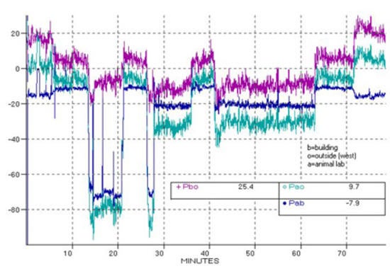

Figure_13: Measured pressure response of facility
Figure 13:  Measured Pressure Response of Facility

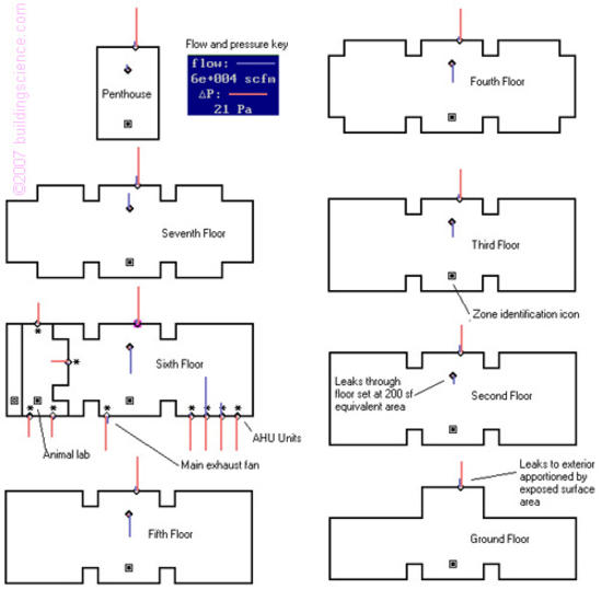

Figure_14: CONTAM model of facility
Figure 14:  CONTAM Model of Facility
Figure_15: CONTAM model of facility (air permeance values of the model are adjusted until the air pressure response of the model matches the measured air pressure response of the facility)
Figure 15:  CONTAM Model of Facility
(Air permeance values of the model are adjusted until the air pressure response of
