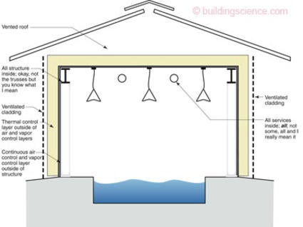

We need to be perfect. And the only wall that will work, of course, is “the perfect wall.” We have been here before.4 Put the water control layer, the air control layer, the vapor control layer and the thermal control layer on the outside of the structure. Put everything else inside, especially the services. Same for the roof. Done.

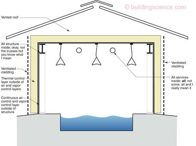

Here is the secret–the control layers need to be continuous–especially the air control layer. If you don’t have air moving across your wall or roof assembly, not much bad can happen. Check out Figure 1 for a conceptual description of the simplest design solution. The bold line represents the air control layer. The shaded layer represents the thermal control layer. The dotted line represents a ventilated cladding. The roof is a vented attic. Classic, simple stuff. Any bad stuff from inside that gets past the bold line and gets into the shaded stuff can pass right on through and get to the outside through the dotted line and the big sloped hat with holes. You don’t need a computer simulation to understand this. You don’t even need a psychrometric chart.
Figure 1: Simplest Design Solution
–The bold line represents the air control and vapor control layers. The shaded layer represents the thermal control layer. The dotted line represents a ventilated cladding. The roof is a vented attic. Classic, simple stuff. Any bad stuff from inside that gets past the bold line and gets into the shaded stuff can pass right on through and get to the outside through the dotted line and the big sloped hat with the holes.
A few little tricks of the trade–think of cladding as a dehumidifier that sucks moisture out of the shaded stuff. That means the back of the cladding will get wet if there is a flaw in your wall. What are the odds of there being a flaw or less than perfect workmanship? If I were using wood cladding, I would not just back ventilate it, I would back-coat it with primer and paint. Just like the old guys used to. I do not want the wood to absorb water. If it does, it can leach tannins and other water-soluble extractives. Ask me how I know?
If it is cement siding, you had better coat it on the backside, as well as ventilate it. If you have brick, you had better ventilate the heck out of the space. If it is metal, you had better think a lot about stainless steel and magic pookey to protect it, as well as good cladding ventilation. If there is a flaw and air gets out, the air is going to be carrying more than just water vapor: chlorine, bromine and other aggressive oxidizing (a.k.a. corrosive) agents. You ever see what they put into the water? It will eat your insides out and the insides of your wall assembly as well.
A few more tricks to remember. The vapor drive is extreme in the extreme. Use membranes on the outside of the sheathing that are vapor closed. Use the fully adhered stuff that needs primers and some old guy with an attitude watching it going up. Yes, it sounds like a throw back to an ancient time, the 1970s. But pools are nasty business.
I don’t care that much about the insulation that goes outside of the air control and vapor control layer. They all work. All of them. Just put in more than you think you need, and don’t screw up the insulation with thermal bridge cladding attachments. Cladding is not very heavy. You are not holding up a bridge or hanging an SUV from the wall.
Metal hat channels over the insulation or furring strips over the insulation work just fine. Do not, and I repeat, do not run a continuous metal z-section back to your metal stud wall or condensation will form on the inside during cold weather. It is a huge thermal bridge. If your structural engineer says you have to do it, get yourself another structural engineer. Lots are available. Get an old one. They know stuff.
