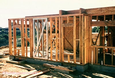

The key to the modern residential wall was the magic of the plywood (see the Sidebar). Plywood was and still is an amazing product, we continue to build furniture, houses, boats1 and planes out of it. We no longer build as many of these things out of plywood as we used to because plywood is being replaced by alternatives. This is most evident in housing where plywood is pretty much gone. In housing we see two alternatives2 - oriented strand board (OSB) (Photograph 1) and foam boards (Photograph 2).

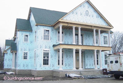

Photograph 1: Ubiquitous Sheathing
—A pretty familiar sight – a home completely sheathed with oriented strand board (OSB); “ruling the range…”

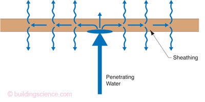

So what’s the catch? There always is a catch. It does not breathe3 as well as plywood or redistribute water as well as plywood (Figures 1a, 1b and 1c and see the Sidebar again). With lots of insulation in wall cavities we discovered that when walls get wet they don’t dry very easily because there is not much energy available to move the water vapor and that turns out to be a big problem. It gets worse if we have a barrier to the water vapor flow such as OSB.
Figure 1a: Hygric Redistribution Within a Materia
l—Penetrating rainwater hits the sheathing, is absorbed, and redistributed laterally and inward and outward. Think plywood. Think plywood with vapor open exterior cladding.

—Penetrating rainwater hits the sheathing, and is not easily absorbed and is not able to be redistributed within the material or passed inward or outward easily. Think OSB. But if redistribution happens within an air film adjacent the surface of the material performance can approximate that of a material with characteristics similar to those of Figure 1a. Think OSB with a small air gap. Think OSB with a vapor open exterior cladding. How small a gap? Ah, that’s the rub, eh? Pretty small, so small that “crinkled housewrap has a significant effect, as do small “bumps” or even ribbons of adhesive (think commercial water managed EIFS).
Figure 1c: Hygric Redistribution Adjacent the Surface of a Material with Limited Inward and Outward Drying
—Penetrating rainwater hits the sheathing, laterally redistributed along the surface. Inward drying is limited as is outward drying. Even with limited inward and outward drying lateral redistribution significantly reduces risk of moisture damage.

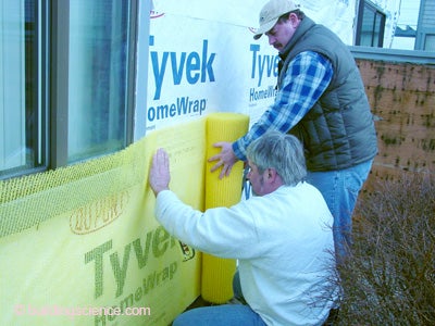

We have to help out the drying part of the equation. Turns out that to help out with the drying thing we need an air-gap between the cladding and housewrap/OSB interface. Especially with airtight claddings like stucco and manufactured stone veneer; and especially where the cavities are insulated with those new fancy spray insulations (like cellulose, or spray foam, or blown-in-batt). The air-gap is simple, elegant and unbelievably effective in helping out drying. Back-vent your cladding and be happy. How much of an air-gap? We know from experience that 3/8 of an inch is a pretty safe dimension4 with stucco, manufactured stone veneers, wood claddings or other claddings like fiber-cement that lie flat against the housewrap and OSB (Photograph 3 and Photograph 4). Typical vinyl and aluminum siding have plenty of air-gaps behind them without having to do anything.
Photograph 3: “High-tech air?”
—Polypropylene mesh providing an air gap between OSB covered with housewrap and cladding.

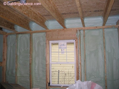

Let us go back to the cavity insulation thing. Things get very risky if you use a high-density spray foam on the inside of OSB sheathing (Photograph 5). There is no way that any appreciable moisture in the OSB can dry inwards. The only drying possible is outwards. We need the gap. Same thing with structural insulated panels (SIPs). These are foam panels lined on both sides with OSB. There is no way that an exterior OSB skin that gets wet on a SIP can dry inwards. We really need the gap with a SIP. How much of a gap? Oh, how about 3/8 of an inch? Remember the discussion about being conservative. It can be smaller with small loads.
Photograph 5: High-Density Spray Foam Cavity Insulation
—High tech and low perm. Great air sealing, great thermal performance, great structural strength. Does not allow for any appreciable inward drying of the exterior sheathing.

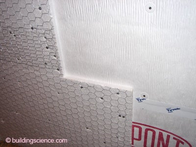

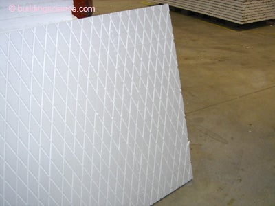

What if I use a vapor closed cavity insulation? Well, we now have a problem. Ah-hah – a problem! Yes, closed cell high-density foam cavity insulation applied to the inside of OSB sheathings that are in turn covered on the exterior with impermeable foam sheathings is risky. Unless you provide a small gap between the exterior face of the OSB and the back surface of the foam sheathing to provide for some hygric redistribution. Or if you are “perfect” with your rainwater control such as when you use a fully adhered membrane – think roof membrane standing up applied to a wall. Otherwise, go with a gap. What works? Grooved foam, “bumpy” OSB, “crinkled” building wrap, 1/8-inch polypropylene mesh, dimpled polypropylene sheets. Lots of stuff (Photograph 9 and Photograph 10). But won’t the tiny gap cause a loss of thermal performance of the foam sheathing? Yes. How much? About 5 percent of the thermal performance of the foam sheathing (not the entire wall assembly) with the 1/8-inch gap, less with a smaller gap. With “crinkly” stuff you loose next to nothing.7 Is it worth it? Yes, in my opinion, the loss in thermal performance is trivial compared to the reduced risk and improved durability. The 5 percent thermal loss is also easily offset by the improved thermal performance of the closed cell high-density foam cavity insulation. Even if you think you are perfect with a water control membrane, go with a gap for at least the relief of hydrostatic pressure. Most of think we are perfect when we really are not. Remember EIFS. Perfection is hard (Photograph 11).
Photograph 10: Groovy
—Cross-cut grooves in the back of foam sheathing to provide relief of hydrostatic pressure and lateral hygric redistribution.

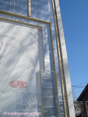

Photograph 11: Perfect Wall Redux
—The almost perfect wall has “crinkled” housewrap providing hygric redistribution, 4 inches of foil-faced polyisocyanurate insulating sheathing providing the ultimate thermal break, wood furring providing cladding attachment, relief of hydrostatic pressure and back-ventilation of cladding. OSB under the housewrap provides shear and high-density spray foam cavity insulation (obviously hidden from view) provides air sealing and even more thermal performance. Who says that all these products can’t get along?
