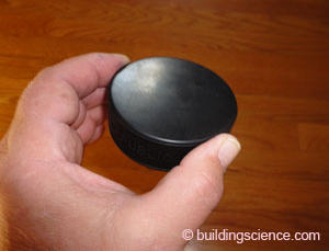

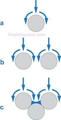

A hockey1 puck is 1 inch thick and 3 inches in diameter (Photograph 1). You can easily slip one into the airspace between a brick veneer and building paper. Now a single puck in an airspace like that causes no grief as penetrating rainwater drains down each side of the puck (Figure 1a). Two pucks are not an issue either (Figure 1b). But three, if they are configured as in Figure 1c, lead to a nightmare. Water can build up and be held in the space – presto – we have “perched” water. Huh? Yes, perched water – look it up.2  This perched water exerts a force on the wall assembly. How much of a force? Read on.
Photograph 1:

Figure 1: Hockey Pucks
—A single puck in an airspace like that causes no grief as penetrating rainwater drains down each side of the puck (Figure 1a). Two pucks are not an issue either (Figure 1b). But three, if they are configured as in Figure 1c, lead to a nightmare. Water can build up and be held in the space – presto – we have “perched” water.

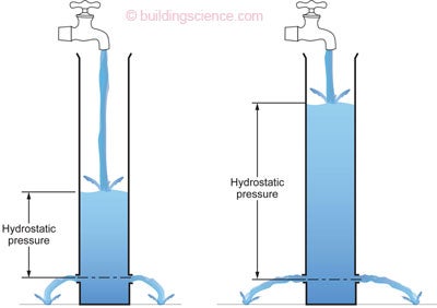

Engineers are pretty funny people. Engineers say that 1 inch of water exerts a force of – wait for it – 1 inch. Yup, 1 inch of water weighs 1 inch of water. It’s a gift we engineers have. Let me help you all out a little bit here, go suck on a straw and draw 1 inch of water up into the straw. To a physicist it takes 250 Pascal to suck water up a straw 1 inch. So, 1 inch of water weighs 250 Pascal (more or less using “Joe Math”).
Figure 2: Hydrostatic Pressure
—Thank you Blaise Pascal
Another way of looking at this is that 1 inch of water exerts a hydrostatic pressure of 250 Pascal at the bottom of the straw. Sometimes we call it “hydrostatic head” or just “head”3 (Figure 2). A Pascal is named after a dead French guy named amazingly enough Pascal. Blaise Pascal was a physicist who came up with something called Pascal’s Law, among a whole bunch of other things. Pascal was the real deal, a brilliant guy, who not only knew what the scientific method was, but defended it.4  Pascal’s Law gives us the definition of hydrostatic pressure. Legend has it that he was trying to figure out how the water level in wells was affected by atmospheric pressure and he ended up with his famous equation.5

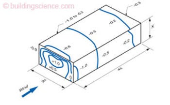

When wind blows against a building dead on at the center of the wall we have something called “stagnation pressure” (Figure 3). We now need to go to another dead guy, this one either Dutch or Swiss, depending on who you are arguing with, named Daniel Bernoulli. Daniel is not to be confused with Jakob of probability fame or with Johann of calculus fame. Wow, what an amazing family – check out the family tree sometime, it includes Hermann Hesse of Steppenwolf fame – the book, not the rock group of Born to Be Wild fame. Those Nobel Prize winners in literature can often be confused with musicians late at night.
Figure 3: Stagnation Pressure
—When wind blows against a building dead on at the center of the wall we have something called “stagnation pressure.”
Anyway, using Bernoulli’s Principle, a 35 mph wind blowing against the middle of wall exerts a pressure of around 150 Pa. That’s about 60 kilometers per hour to young Canadians and my European friends. In real terms that is 0.6 inches of water and converting to Joe Math around ½-inch of hydrostatic head. So a 35 mph wind blowing against a wall gives you about a ½-inch water gauge (w.g.).

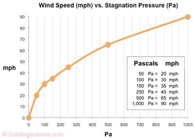

So why am I obsessing about this 35 mph thing – it has turned up in all of my examples so far? Check out Graph 1, which is a plot of wind speed in mph vs. stagnation pressure in Pa. Don’t you just love these mixed units? Patience, folks, patience.
Graph and Table 1:
 Wind Speed (mph) vs. Stagnation Pressure (Pa)
In most of North America the 3-second gust basic windspeed for structural design is 90 mph. This is 1,000 Pa. Guess what 15 percent of 1,000 Pa is? Yup, 150 Pa. Design wind loads for rainwater hold out for windows and glazing systems are typically set at 15 percent of the 3-second gust basic windspeed. Why 15 percent? Why not 10 percent? Why not 20 percent. There is no technically justifiable reason for the number. It came out of a body orifice. Back in the day there were huge arguments about this value. There still are.

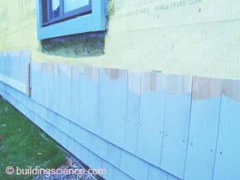

Installing vinyl siding over building paper even though there are thousands of holes in the building paper is not a problem because vinyl siding does not hold the water against the wall. With wood and fiber cement siding and trim you need to install the wood siding and trim over a small gap to control hydrostatic pressure. This gap can be as small as a ¼-inch and the spacer can be a strip of thin foam (Photograph 2). With cedar shingles you can use a drainage mat (Photograph 3). You can also use a drainage mat with stucco as well – except you need to install building paper over the drainage mat so that it does not fill with the mortar from the stucco scratch coat. With brick veneers you need to keep the air gap open – no mortar droppings (good luck with that) or install a drainage mat as you would do with stucco. Or, a draining “house wrap.” Mortar droppings don’t matter if you have drainage behind them or around them.
Photograph 2: Gap Behind Siding and Trim
—With wood and fiber cement siding and trim you need to install the siding and trim over a small gap to control hydrostatic pressure. This gap can be as small as a ¼-inch and the spacer can be a strip of thin foam.

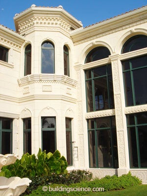

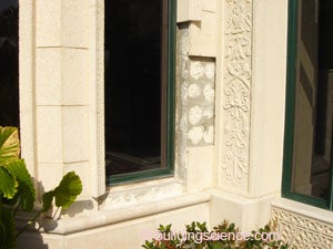

Where things often get messy is around windows and doors – specifically trim around window and door openings. In hot-humid climates such as Florida it is pretty common to use a mass wall with direct applied painted stucco as the rainwater control strategy. Rainwater runs off the surface of painted stucco pretty readily. A smooth surface with nothing to catch the water does not lead to an increase in hydrostatic pressure. Now add a precast element around window openings for aesthetic reasons (Photograph 4). If you do not address perched water you are doomed. It is absolutely critical to drain the back surfaces of these trim elements to prevent perched water and resulting hydrostatic pressure. There are countless sad stories of trim catching water at window to wall interfaces leading to wind driven rain driving forces in the absence of wind.
Photograph 4: Precast Trim
—It is absolutely critical to drain the back surfaces of these trim elements to prevent perched water and resulting hydrostatic pressure. There are countless sad stories of trim catching water at window to wall interfaces leading to wind driven rain driving forces in the absence of wind.

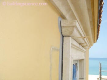

Let’s kick it up a notch and install precast units over the entire surface of a stucco wall (Photograph 5). Nice house eh? Lot’s of houses like this in Florida. Interesting observation from a builder no longer doing business. Similar houses in a similar location with direct applied painted stucco over mass walls did not leak, but where the houses were “upgraded” by installing “mud-set” precast elements over the top of the direct applied stucco leakage was common (Photograph 6). The “blobs” were too big, and there were too many of them, and they were too close together and lead to perched water. I bet any hockey playing or hockey loving builder who knew about Pascal and Bernoulli could have figured out why.
Photograph 5: Precast Elements
—“Mud-set” precast elements installed over the top of direct applied stucco.

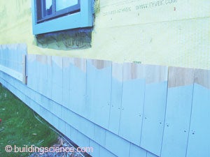

Photograph 6: Perched Water
—The “blobs” are too big, and there are too many of them, and they are too close together and lead to perched water.
