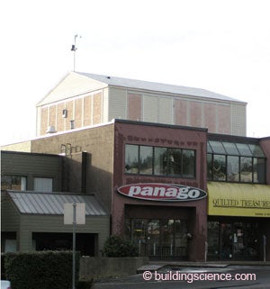

Photograph 2: Temple to Hutcheon
– Constructed around 2005 overlooking Vancouver by the contractor Gauvin the Younger to honor the God of Building Science.

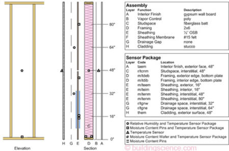

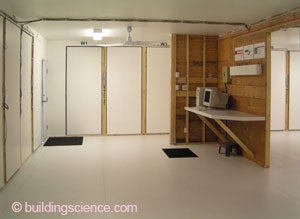

Twenty-eight test panels (4 ft. by 8 ft./1m by 2m) run through 12-month cycles over 6 years? Thousands of data points (Photograph 4 and Photograph 5)–argh! Only crazy people do this kind of stuff. Guess what? Taking the darn things apart every year turned out to be the most insightful. Nothing beats looking at everything–every layer, every side of every layer. You get the idea. It’s the only way to keep the data honest. Are you really measuring what you think you are measuring? The instrumentation was impressive (Figure 1). The entire approach is worth a discussion–but for some other time.
Photograph 4: Interior of Test Hut
– Interior east wall elevations

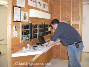

Photograph 5: Data Acquisition
– Confused “Scribe” making sense of thousands of sensors.
Figure 1: Test Panel Instrumentation
– Note the location, number and type of sensors for each of the 28 test panels.

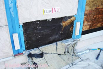

We specifically looked at stucco walls where stucco was applied over building paper over OSB (Photograph 6) and where stucco was applied over impermeable foam sheathing over OSB (Photograph 7). The stucco was traditional “hard-coat” stucco. The walls were 2x6 (0.038m x 0.14m) wood frame insulated with fiberglass batt insulation. The foam sheathing was 1.5 inches extruded polystyrene (R-7.5). The foam sheathing over OSB wall did not have a plastic vapor barrier installed on the interior. The interior vapor control layer for this wall assembly was latex paint (a Class II vapor retarder). The stucco directly over OSB wall had a plastic vapor barrier installed on the interior–a 6-mil polyethylene sheet (a Class I vapor retarder).
Photograph 6: Stucco over OSB Wall
- North elevation deconstruction of hard-coat stucco applied over building paper over OSB.

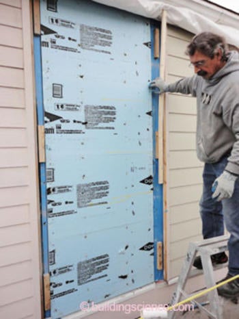

Photograph 7: Stucco over XPS Wall
– North elevation deconstruction

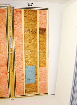

The walls were wetted both internally (Photograph 8) and externally (Photograph 9). The external wetting was done behind the “water control layer” – directly into the OSB sheathing to be representative of a flaw or a true leak or construction error or defect. The internal wetting was done in a similar fashion. Water was injected directly against the cavity side of the exterior sheathing–again to be representative of a flaw or construction error or defect.
Photograph 8: Interior Wetting Apparatus
– Note blue capillary active mat used to distribute water injected into assembly over interior surface of exterior OSB sheathing.

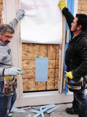

Photograph 9: Exterior Wetting Apparatus
– Note that the capillary active mat used to distribute water injected behind cladding is located behind the water control layer directly over the exterior surface of the OSB sheathing.

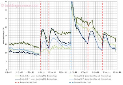

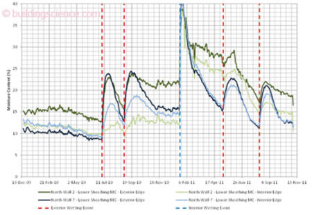

Wetting events were a week in length and consisted of adding approximately 2 oz. in the morning and 2 oz. in the evening each day. This was our best estimate of a persistent leak resulting in wetting in a concentrated area9. Four external and one internal wetting events were done. Why more from the outside? Easy, it was Vancouver. Duh!

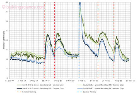

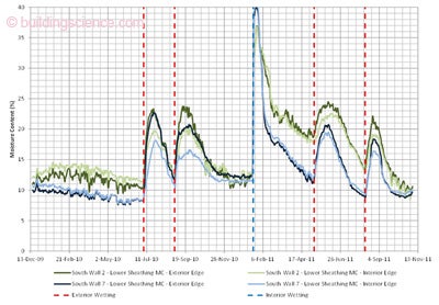

The results are presented in Figure 2 for the north elevation and Figure 3 for the south elevation. Drying turns out to be faster on both the east and west elevations than the north elevation and fastest on the south elevation. No surprise. The OSB moisture contents for “Wall 7”–the stucco over foam over OSB wall–is lower than “Wall 2”–the stucco directly over OSB wall – are lower for nearly the entire year on all elevations. This makes sense if you consider that the wall with foam sheathing is warmer due to the thermal resistance of the foam sheathing and has no interior vapor barrier10.
Figure 2: North Elevation OSB Sheathing Moisture Content – Note the wetting events and the drying rates.
Figure 3: South Elevation OSB Sheathing Moisture Content

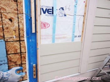

We also looked at claddings with and without air gaps behind them. The wall we talked about above with stucco directly applied over the OSB works much, much better with a small gap (3/8-inch or 10 mm) between the stucco and the OSB. Again, this should be no surprise, for stucco. But it turned out to be as important for other cladding systems such as fiber cement siding installed over OSB (Photograph 10). If you install a polyethylene vapor barrier on the inside of your wall and you sheath it with OSB you had better back ventilate your external cladding. It makes a big difference.
Photograph 10: Fiber cement siding
- If you install a polyethylene vapor barrier on the inside of your wall and you sheath it with OSB you had better back ventilate your external cladding. It makes a big difference. Note the “blue” spacer strips that create a 3/8-inch ventilation and drainage gap between the siding and the water control layer.
